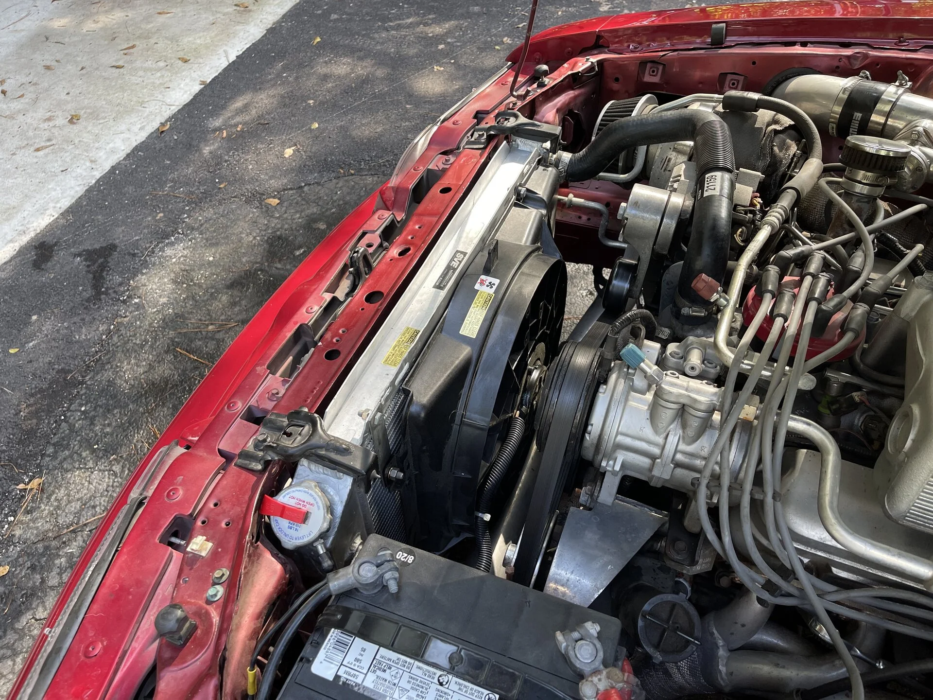

Well, part of the reason for the e-fan install was because the car would get hot with the A/C on. After the new radiator and e-fan, it was still acting up, but instead of low speed, it was getting hot on the highway. Yesterday, I took my daughter to swim lessons and it got hot again, but wouldn't cool off at any speed.
My concern is that the intercooler is blocking a lot of air. Then, the condenser is only allowing hot air across the radiator so there seems to be a no-win situation here.
My question is, with my new 80# injectors, can I remove the I/C and switch to e85, or would that not really cure the issue of the radiator sucking hot air off the condenser? I was hoping by removing the I/C I could shift the condeser forward and put a pusher fan on it. The air gap would help.
Apologies for the ramble, but I'm stumped here. I have to have AC though. It was 91 yesterday and is only going to get warmer!

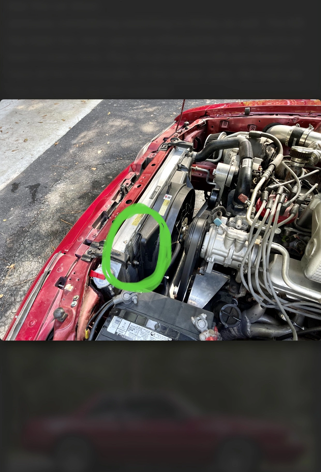

How far away from the core is your fan shroud down both sides?
It's flush on the other side. The gap that you see is finger width
According to that picture there is room for improvement with the e-fan shroud. Shroud appears to cover 75% of the radiator at best and it has 1/2" gap on the end that suck hot engine air instead of sucking air through the radiator.
My Contour fans covered nearly 100% of my SVE radiator like they were meant for each other.
It may not cure your problem but I bet it'll help.
I’ve considered ordering some contour fans. Maybe making a sheet metal shroud too.
