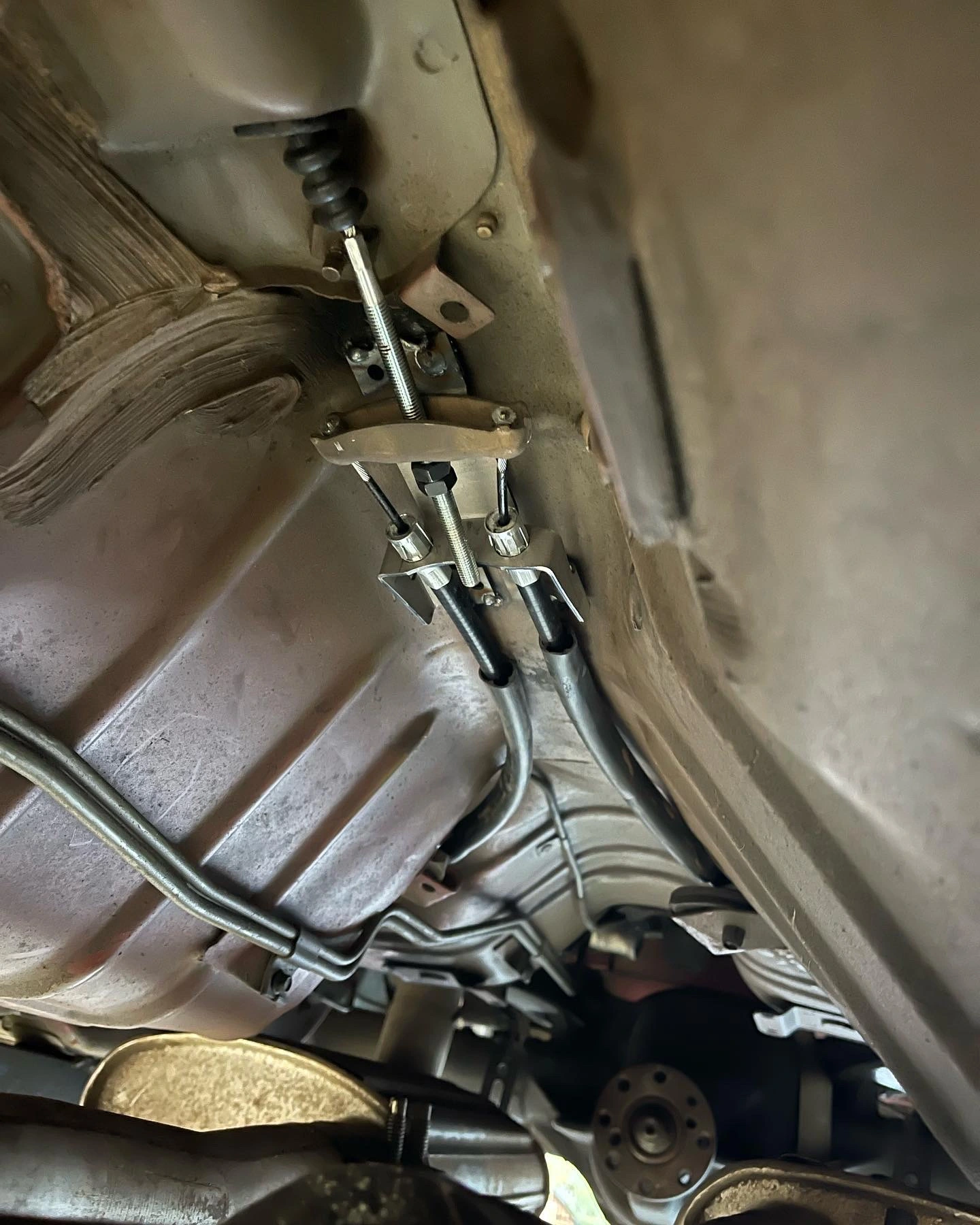

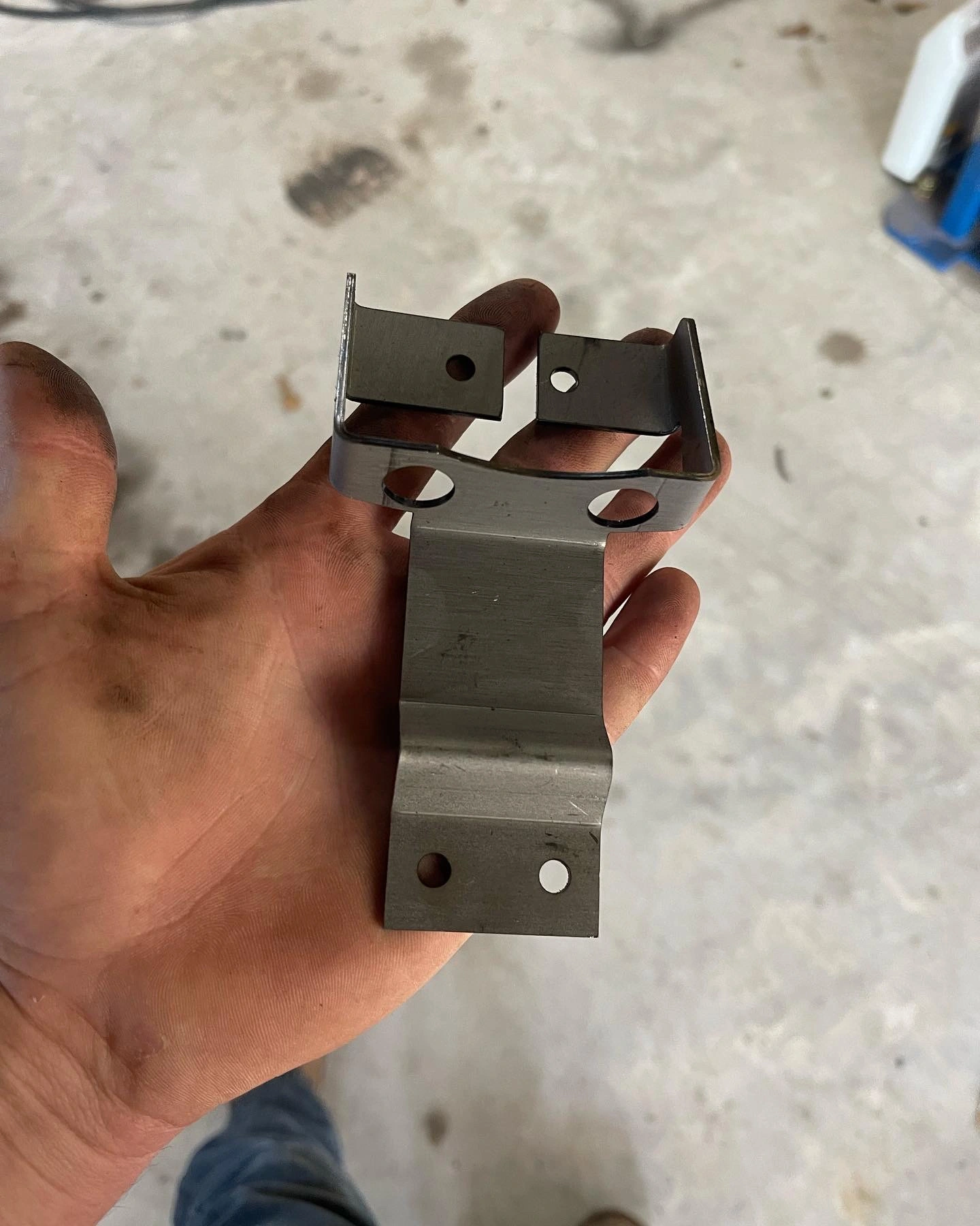

I started working on the emergency brake swap. I tried for a good 10 minutes to get the factory brake cables out by depressing the tabs and pulling it through before getting the saw out and cutting them off. Not an easy task.
Didn’t get much further than that however, I think I’m missing a bracket for the cables to mount in?
1993 is a one year only E-brake setup. It’s VERY similar to the SN95 cars but slight differences.
Yes, there is supposed to be a bracket there that the sheathed cables clip into.
Unsure if anyone carries that bracket
Edit: LMR does although not a exact replica

I bit the bullet and bought the silly $38 bracket. We have emergency brakes now. It’s becoming painfully obvious now that my side hustle is doing well enough to prevent me from working on the car. Maybe one day I’ll get the motor apart.

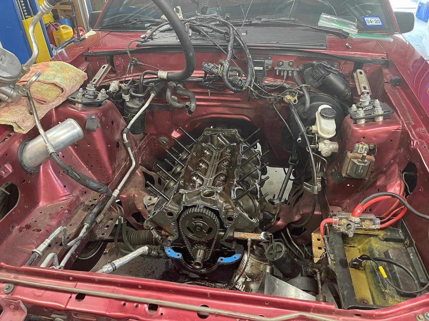

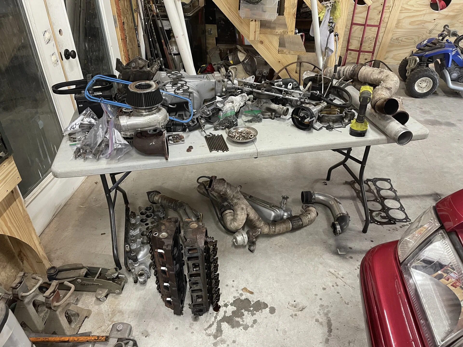

I think I've reached the point where I'm ready to tear the car down and put the heads on. The weather sucks and I probably wont drive it a whole lot. My main fear is having it torn down without all the parts I need and it staying down for many months. We shall see. Probably going to start on it this weekend.
What's going on:
Promaxx 180s
TFS-1 cam
Stainless Summit brand 1.6 rr
Keeping the 42# injectors for now, although they'll be on the ragged edge of their flow at 7# I think. Need to upgrade to 60s at some point.
Reactions: Boosted92LX, RaggedGT, 90sickfox and 2 others
hoopty5.0
mechanicus terribilis
Dec 14, 2010
7,809
6,961
214
SW Houston
Jan 29, 2022
#947
  • Jan 29, 2022
  • #947
Todays progress. No surprises and everything is in good shape.
Reactions: 90sickfox, General karthief, Cheapskate207 and 4 others

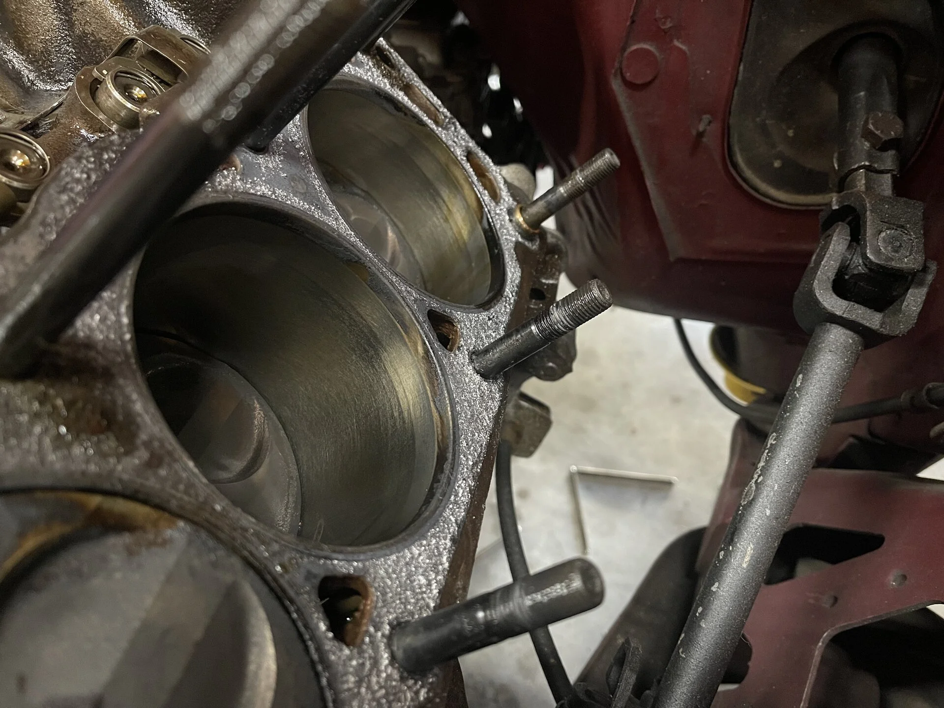

My pistons aren’t stock, but they’re stock replacements. I’ll go strap one of the heads on and clay them to see if and how much clearance there is I guess.
I was really hoping everything was so mild that there would be miles of clearance and issues were nothing to worry about. Le sigh.

I do run the Promaxx 190's but they are on a fully built 393w..
You will want to clay and then triple check.
