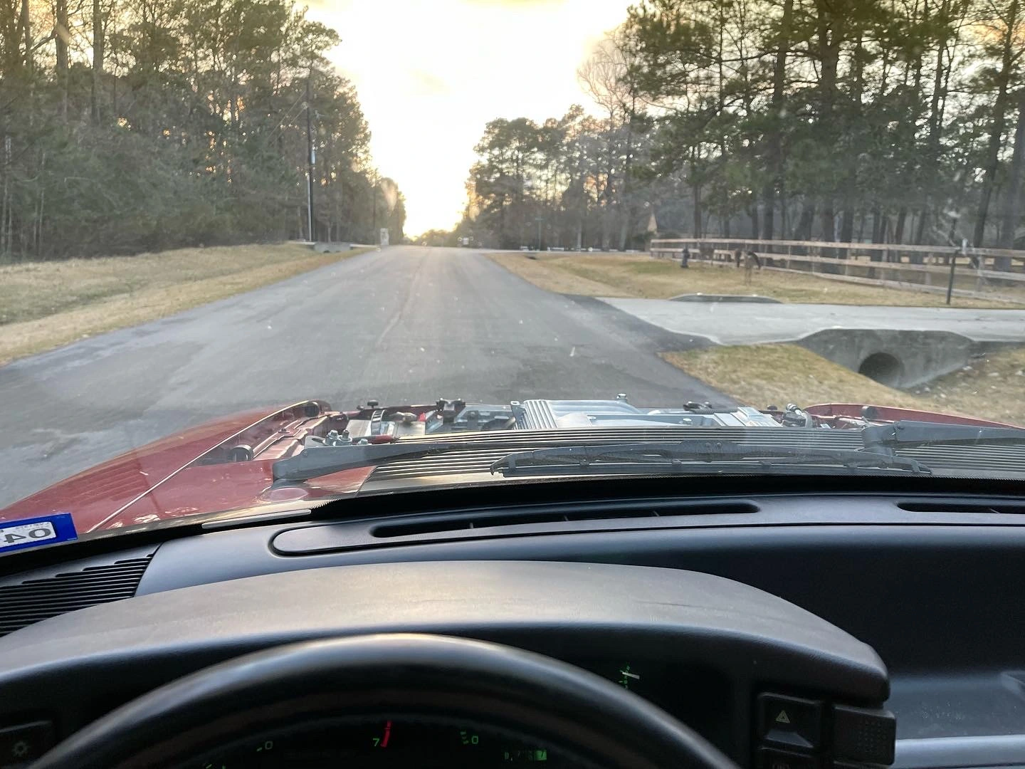

I was able to burp it and get out around the neighborhood today. The idle is a basket case. I’ve subscribed to Steve’s YouTube channel and will get smart on closed loop idle and see what I can make happen.
Question- how far to vert mounts drop the engine? I need it to go down a bit.
