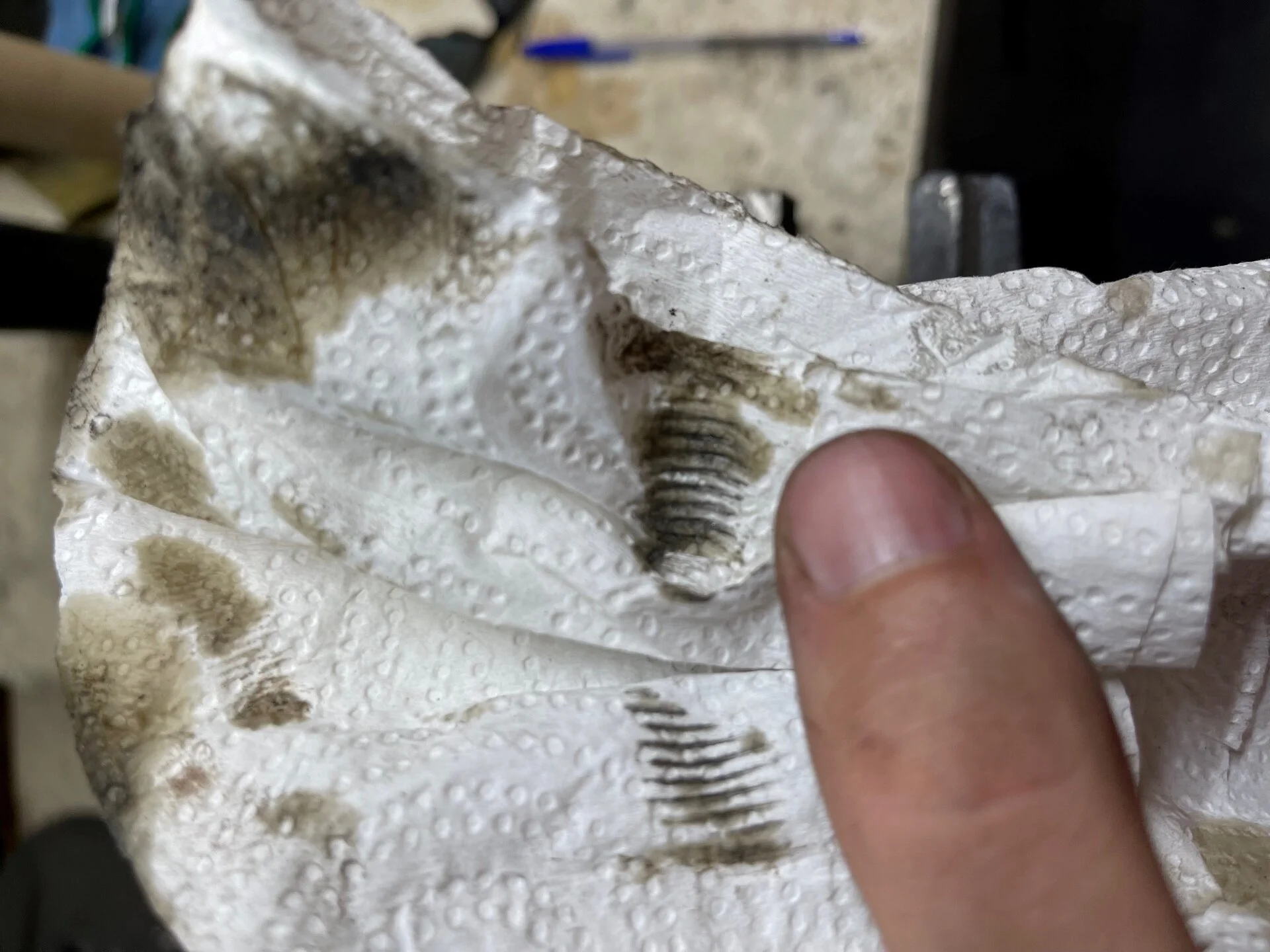

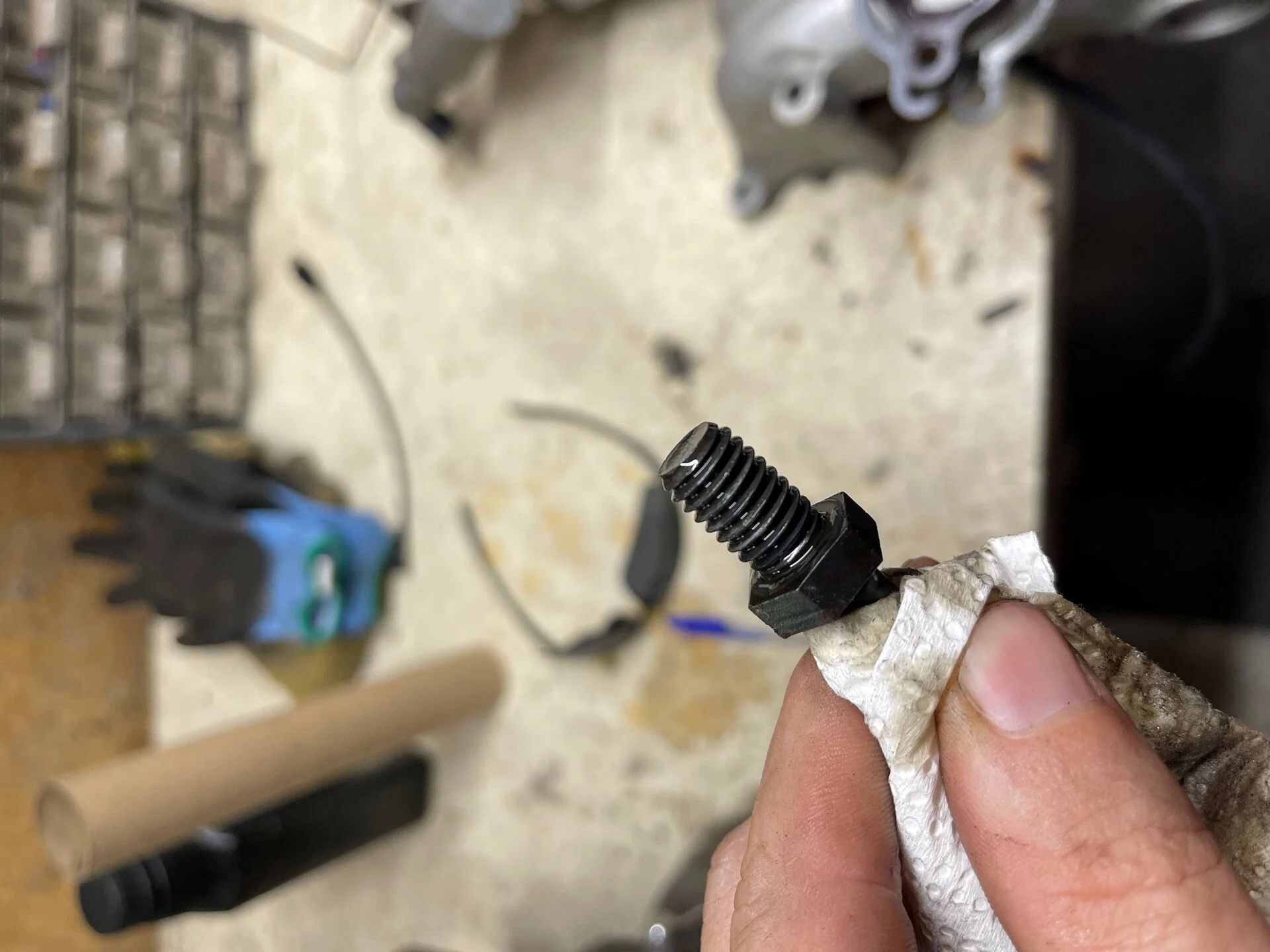

We think we have figured out the oil consumption issue. On aftermarket heads, a lot of times the rocker studs are drilled through the intake ports. You have to seal them or they will draw in oil. I say we because another local guy was having the same issue with his AFRs and he took his apart this morning and that seems to be it - the stud threads were soaked in oil. Ill try and get to mine this week.

Wasn't going in the intake. Its being drawn in through the stud boss which is drilled into the intake runner in the head. And yeah, all 8 plugs are trash. My car is using a quart every couple hundred miles, if I were to guess. Another local guy is having way worse consumption but pulled his studs yesterday and sealed them back up. Not sure if he's driven it yet to see if that cured it but Im sure it will.
Whoa what a weekend! Friday, I got into the motor. As expected, the intake studs were all oily, so I sealed them and reinstalled. Checked all the lifters lash and went for a cruise, everything was cool.

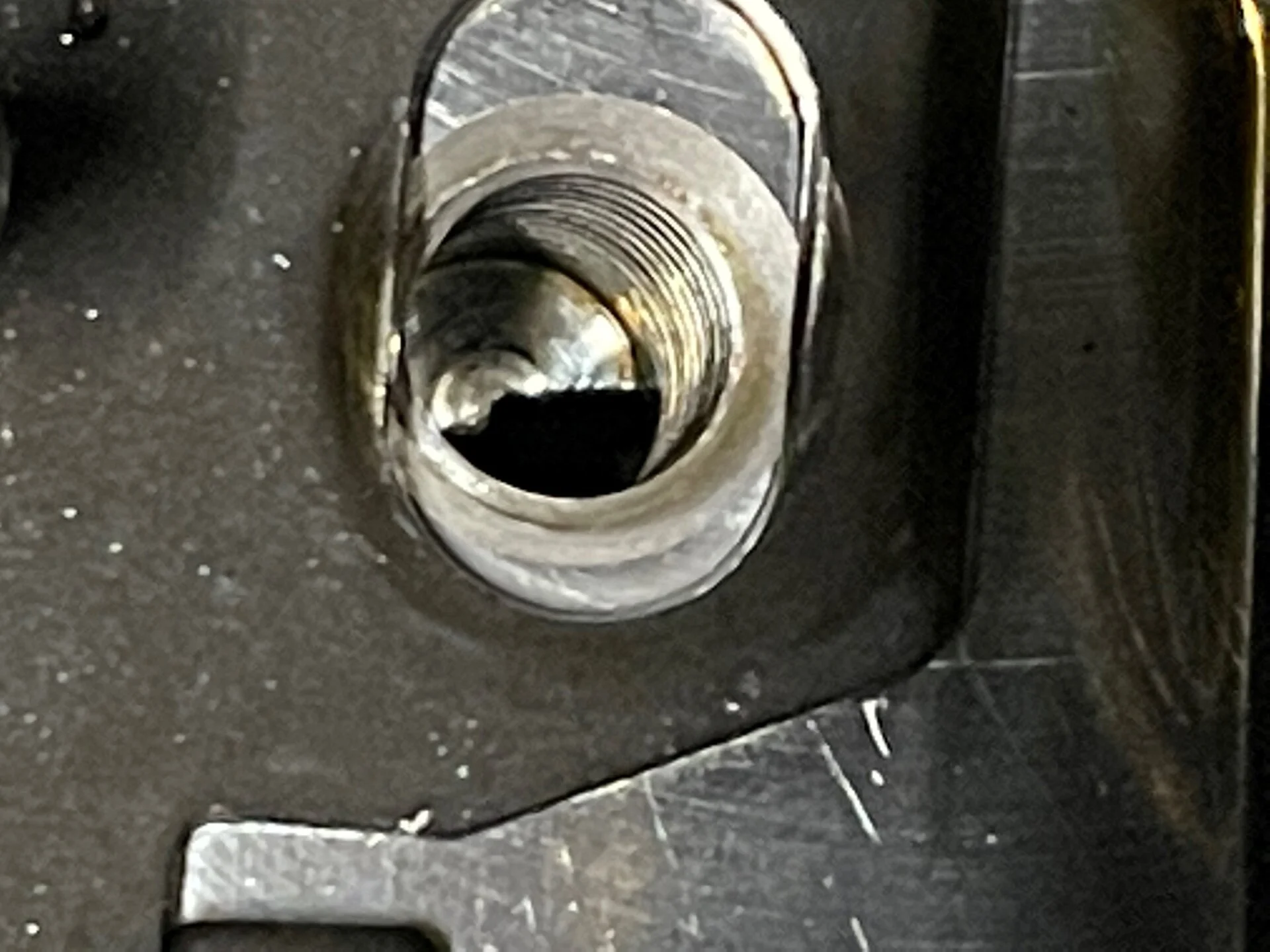

I still left the towel under it as an experiment to see if it was still leaking and low and behold, this morning there were drips on the towel. I took a picture from the underside:

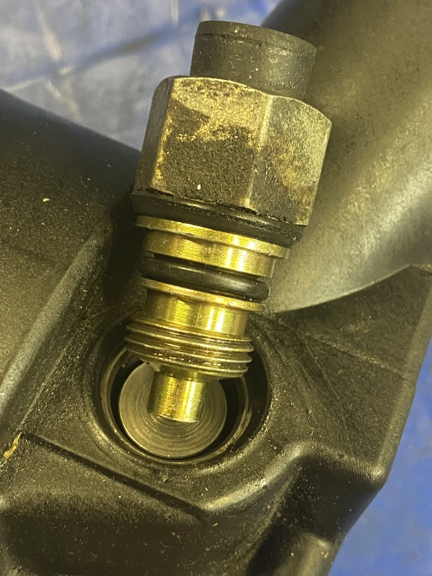

Im at a loss other than replacing the pump. it appears to be leaking from the largest of the hex nuts where it meets the body of the pump. The exposed O-ring is still dry.

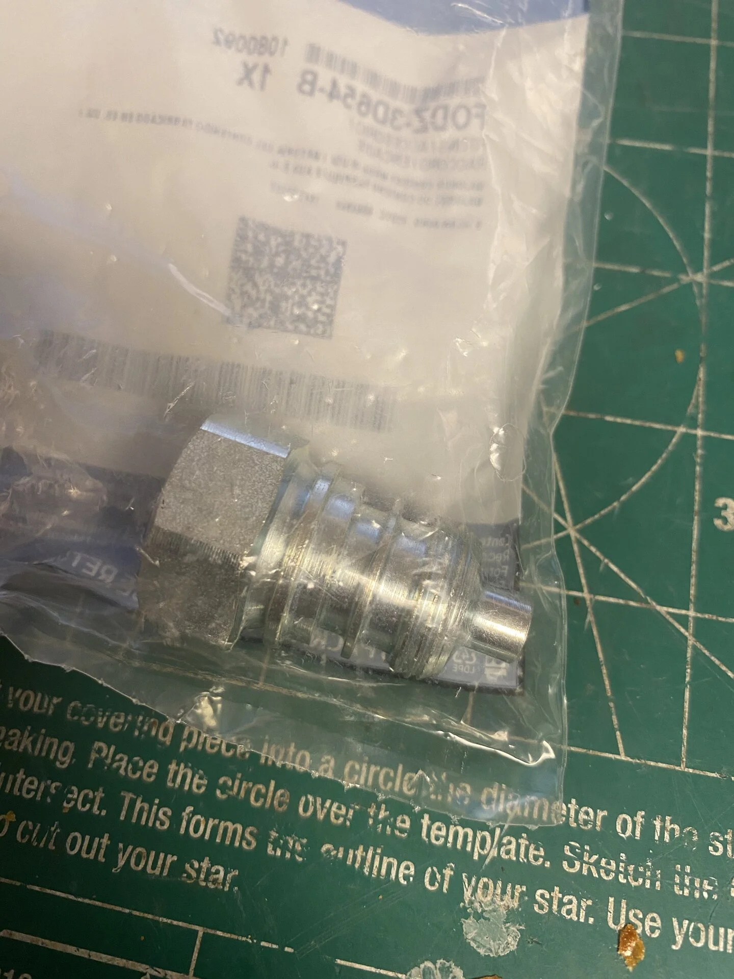

I believe there’s an O-ring seal inside there. Here’s the fitting off a 90+ pump. The entire thing can be removed.
I have my original pump handy. I’ve been meaning to pull the fitting off to inspect something so if I get a chance I can confirm what makes the seal in there.
So this is a picture of the larger nut removed from the body of the pump? I have a O-ring set and could replace it pretty easily.
EDIT* I just went and put a wrench on it. It wasnt loose, but it wasnt tight either. I cleaned the bottom of the pump and will see if theres fluid later this afternoon.
