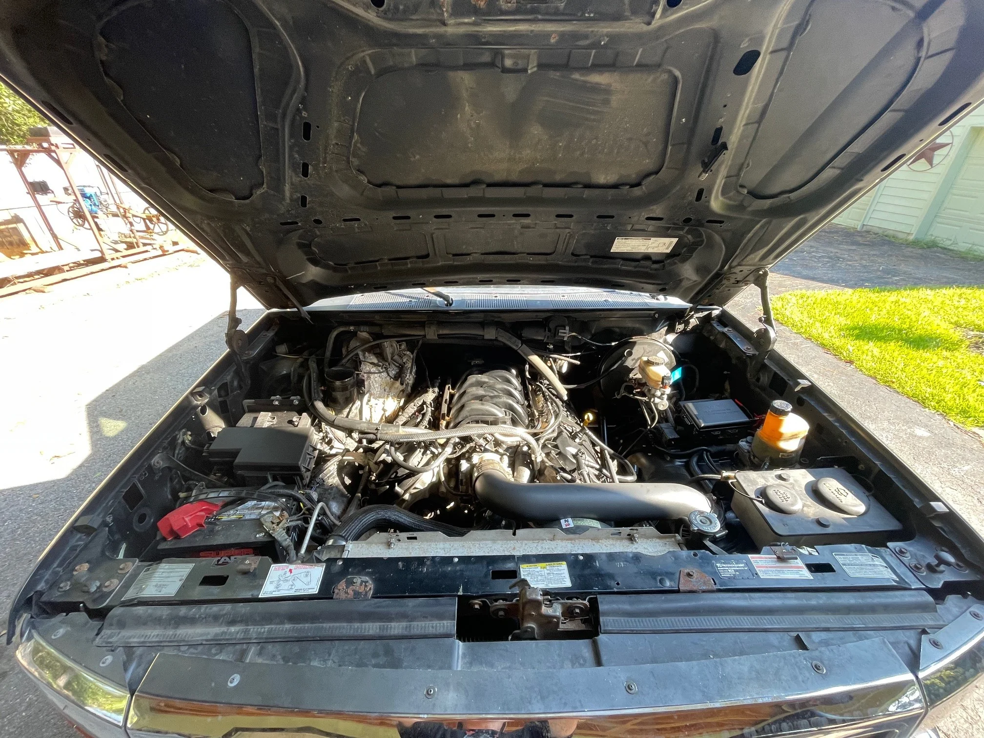

Update: after multiple weeks of banging my head against the wall with no progress, I fixed it.
I had a plug in the wrong spot. Whoops.
Need to get it back on insurance and inspected, then off to the tuner it goes.

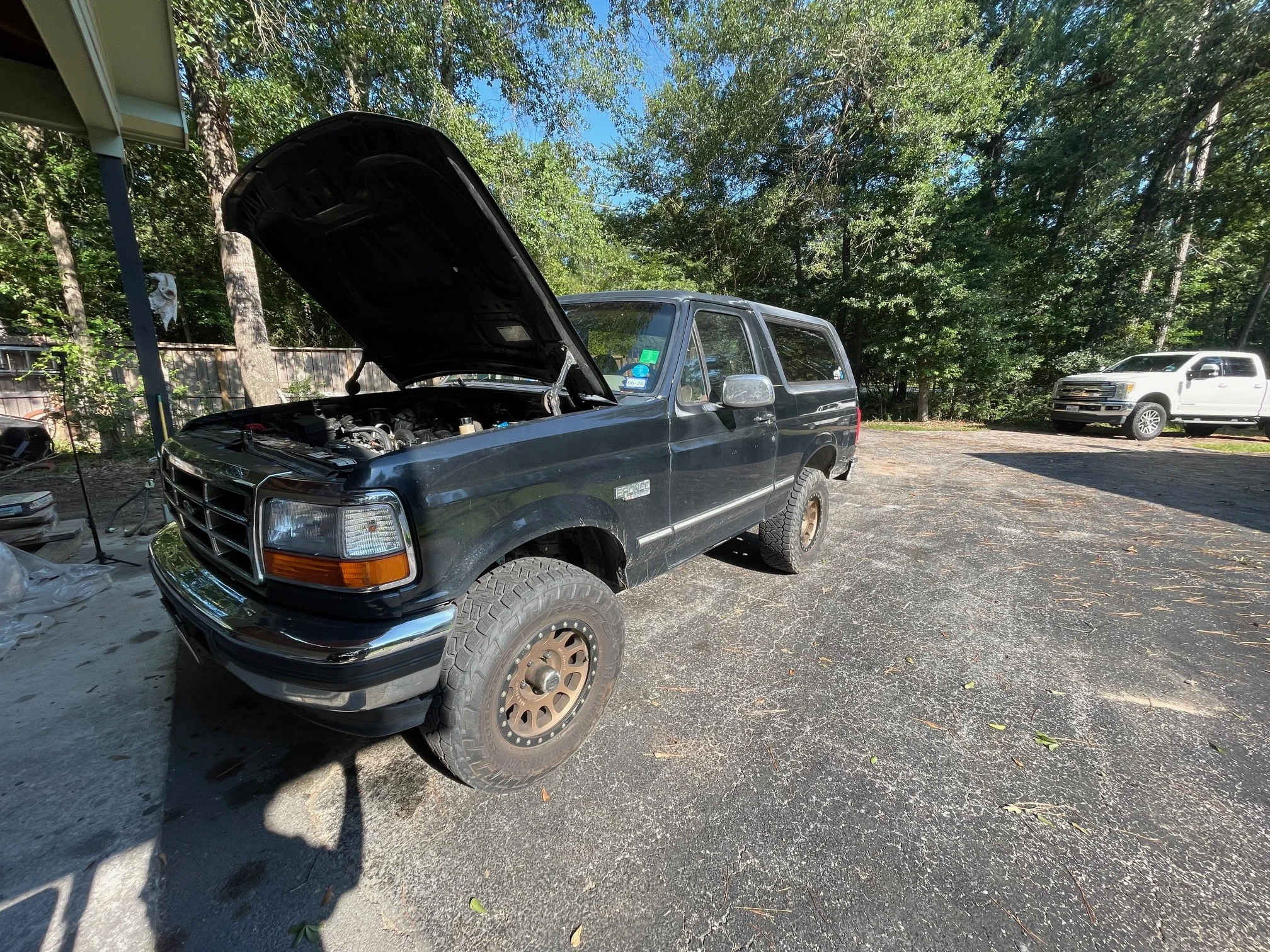

Alright, the bronco is pretty much done, got it back from the tuner yesterday. It runs and drives like a new truck and it MOVES... probably more so than it should but its a lot of fun. I have a few loose ends to tie up but other than that, Ill be putting a lot of miles on it.
Ill have the third YT video up this week, I'm about done editing it.

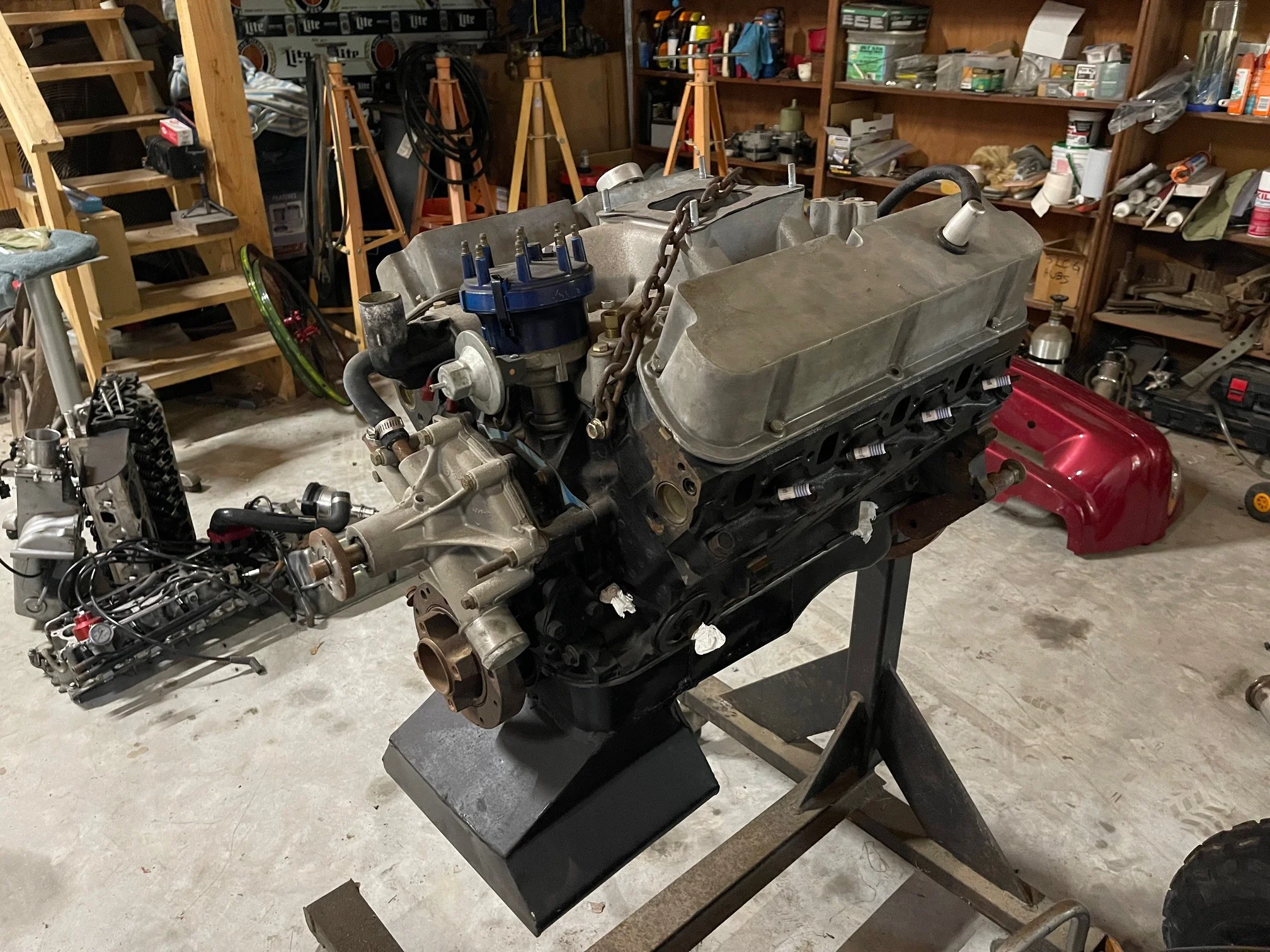

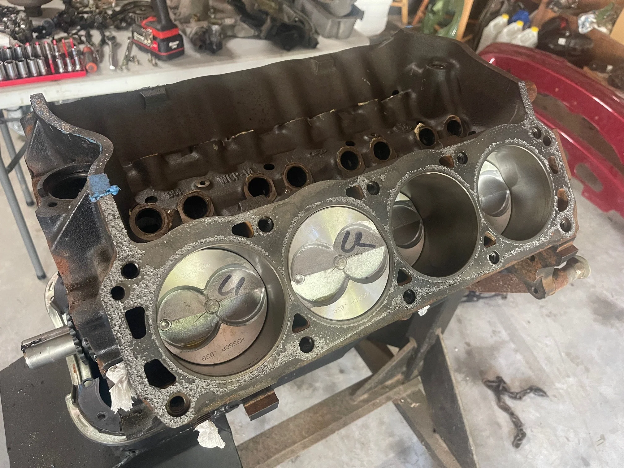

I had a few minutes to tear down the 351 yesterday. Its a roller motor and a fresh .030 build, which is pretty cool. Crude measurements put the pistons .015 in the hole. I ran some rough calcs, assuming the heads are 58cc after milling and I use an .039 HG, it puts compression right at 10:1. If I go with an .027 HG then its 10.29:1.
The cam that came out of the 351 is still a mystery. No markings whatsoever other than 1535 stamped on one end. Google didnt turn much up.
Trying to maintain the "just get it running" mentality instead of trying to nerd out on hyper specifics that would ultimately slow down the process and prolong getting the car back on the road which is my main goal. No real power goals, just get it driving.

If you are staying NA, deffinently stick with the thinner HG. You should be targeting quench under ~ .045, .060 is to much., unless you are spinning 9K then maybe .045 -.050.

I meant to tag you and ask that question but saw a squirrel. Staying NA for sure. The .027 HG is a MLS type. Do I need to do anything to the heads to make that work, or does it matter at 400hp?

Just make sure block and head are flat and you will be fine. MLS might have a Ra requirement just make sure head and block are in spec on that, any reputable machine shop can measure that.

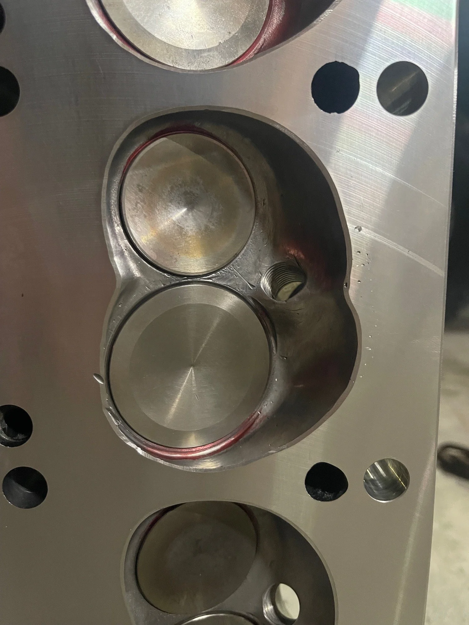

Heads are at the machine shop as of lunch time. He's going to clean them up and mill them down to 58cc from 60cc.
I asked if they were busy and he said "It'll take a couple days." I giggled all the way back to the truck. I've never had anything done at a machine shop that didnt span the changing of a few seasons!

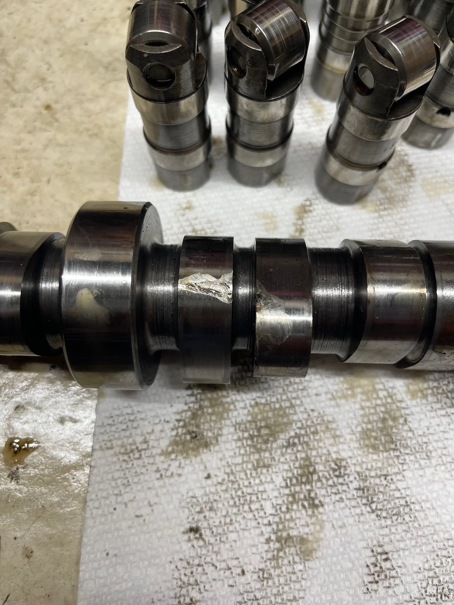

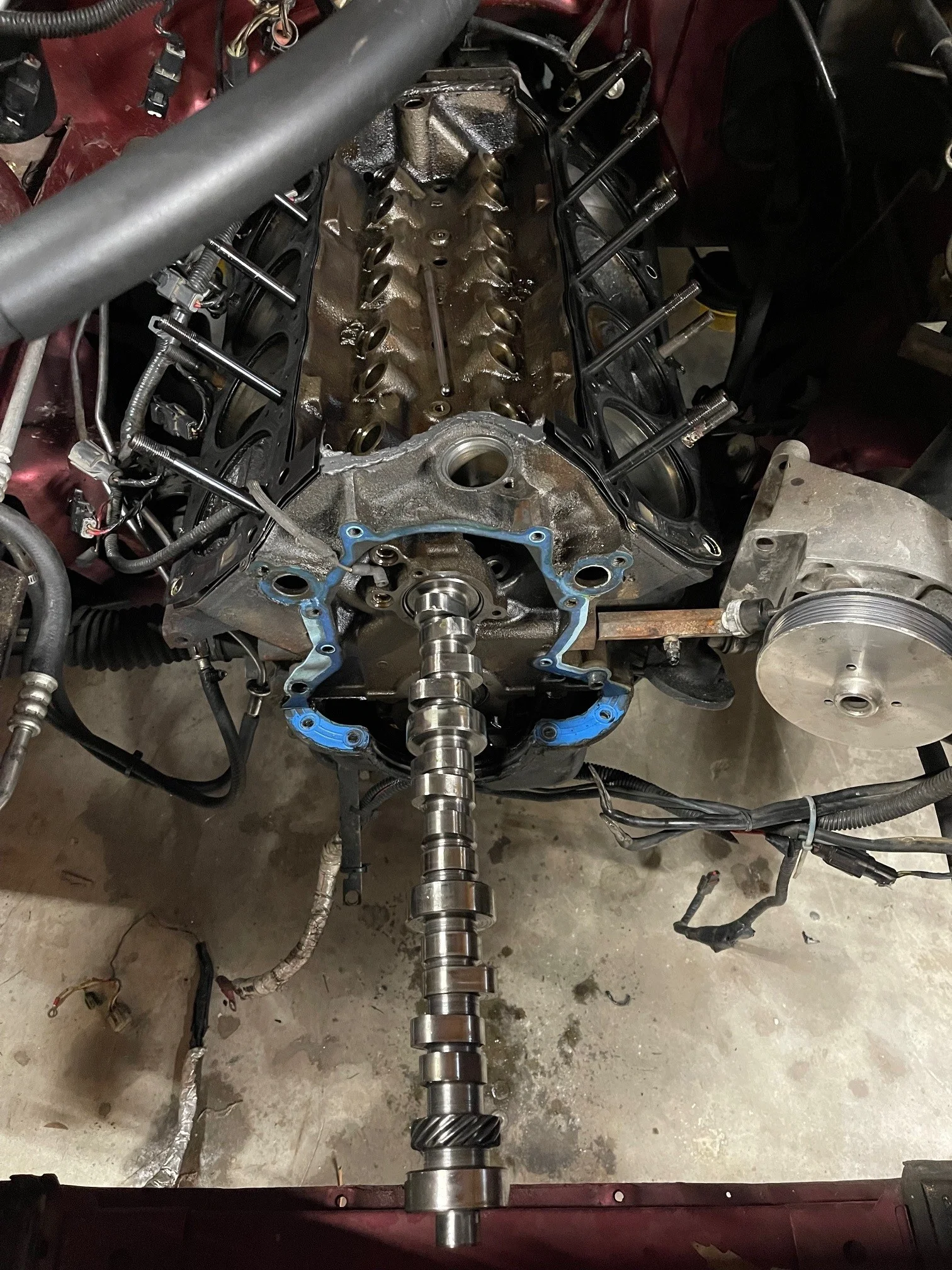

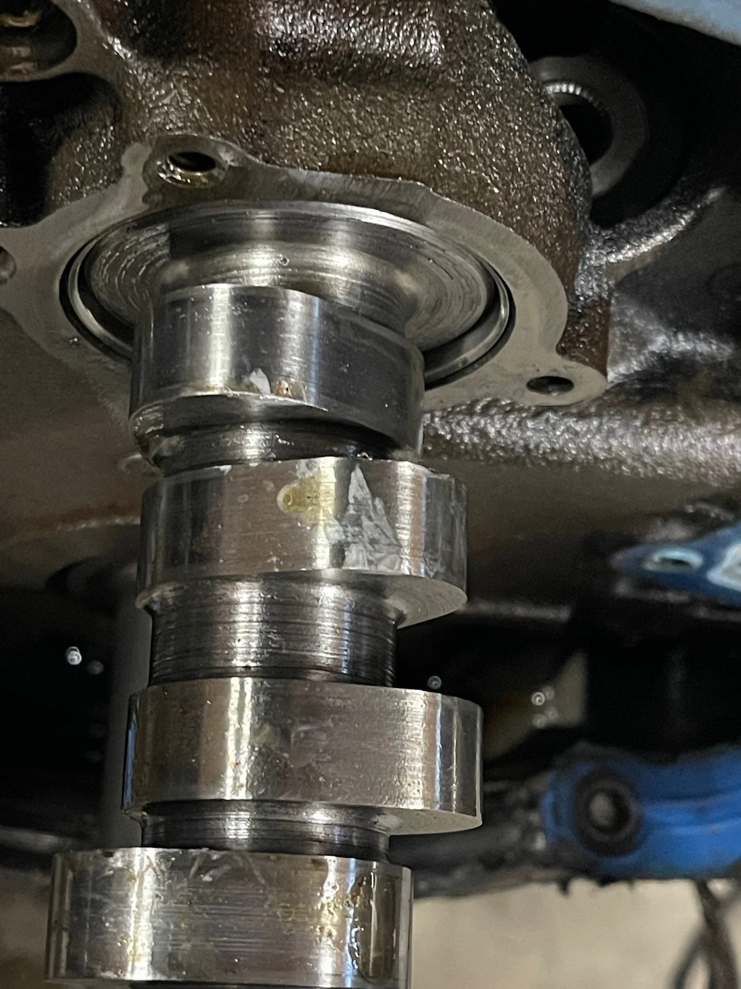

My plan to reuse the cam just fell apart.
So now I need to find a cam to stuff in this thing. No, paying Ed or anyone else $500+ for a custom cam isnt an option. I need something on the cheap that will work.
I still have the mystery cam from the 351. Need to measure the lobes and see what that looks like.

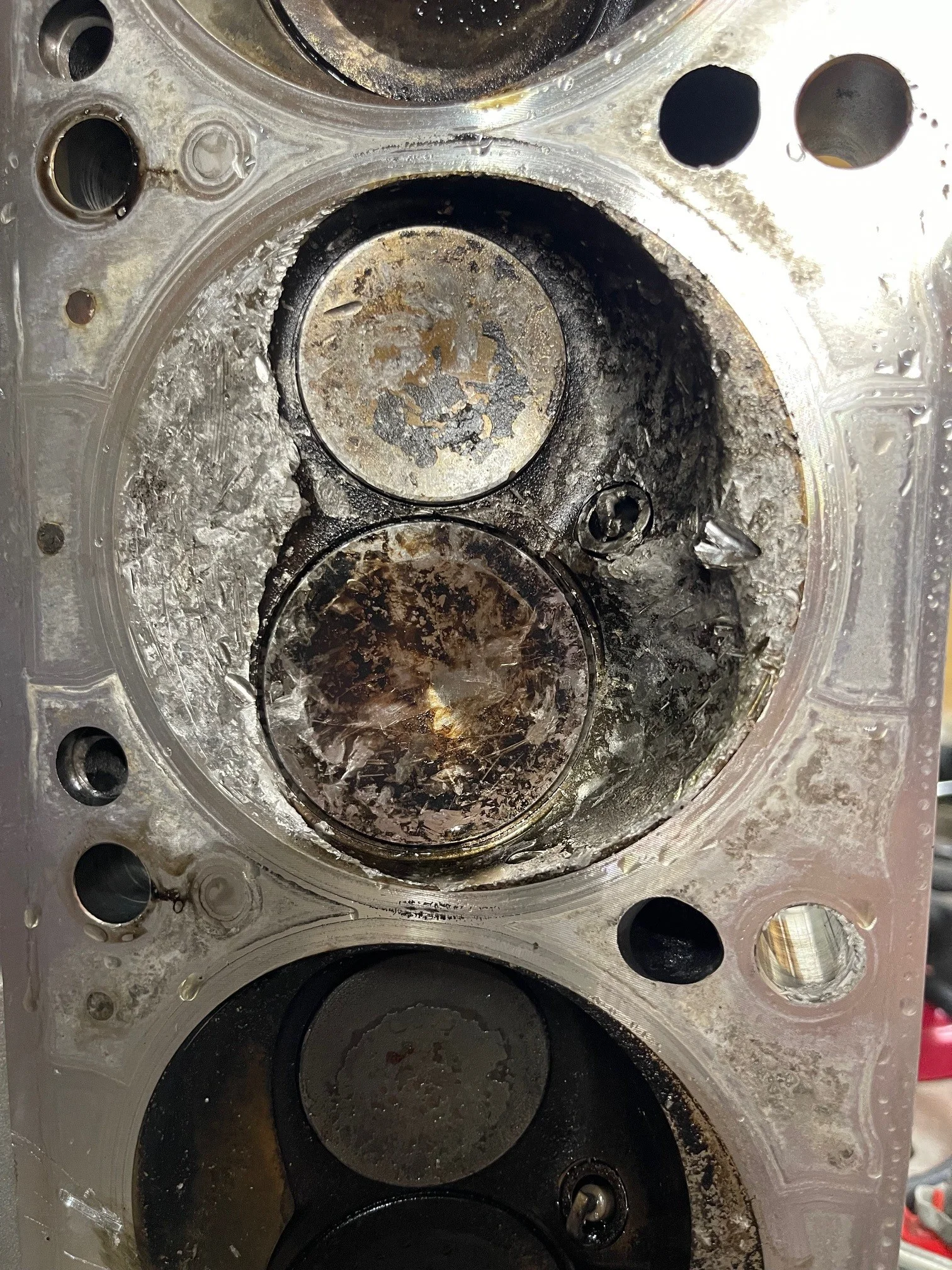

Well, I'll eat crow on this one. Heads are done. 3 bent valves, little bit of welding work and milled them to 58cc. Hair over $500.

Before and after of the heads:
I've spent all my cash for now and am waiting on some other things to come around before I can keep buying parts. But hopefully soon I can start putting this all back together.
