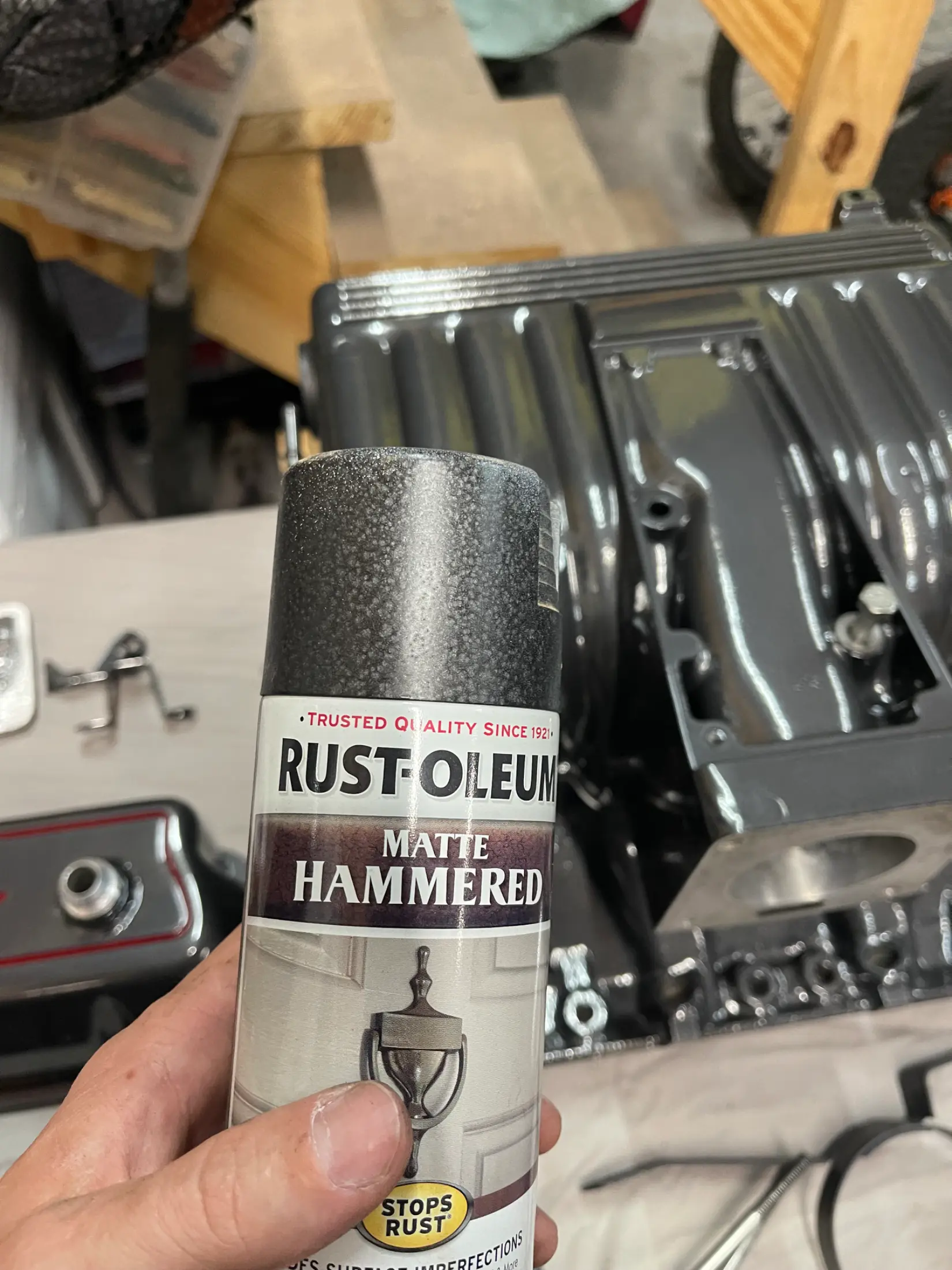

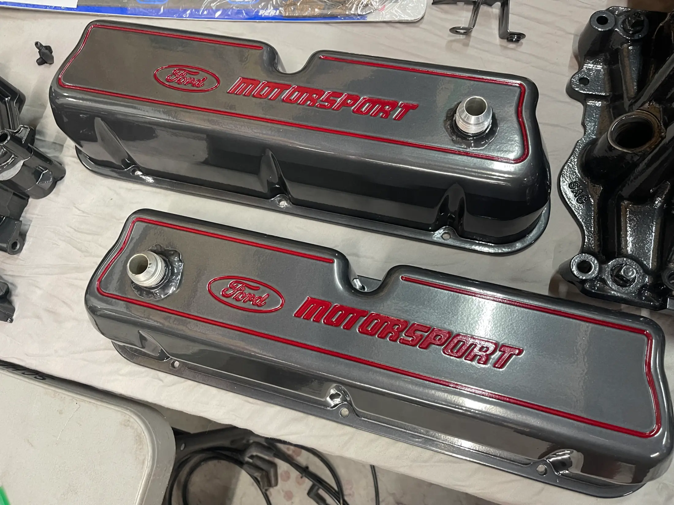

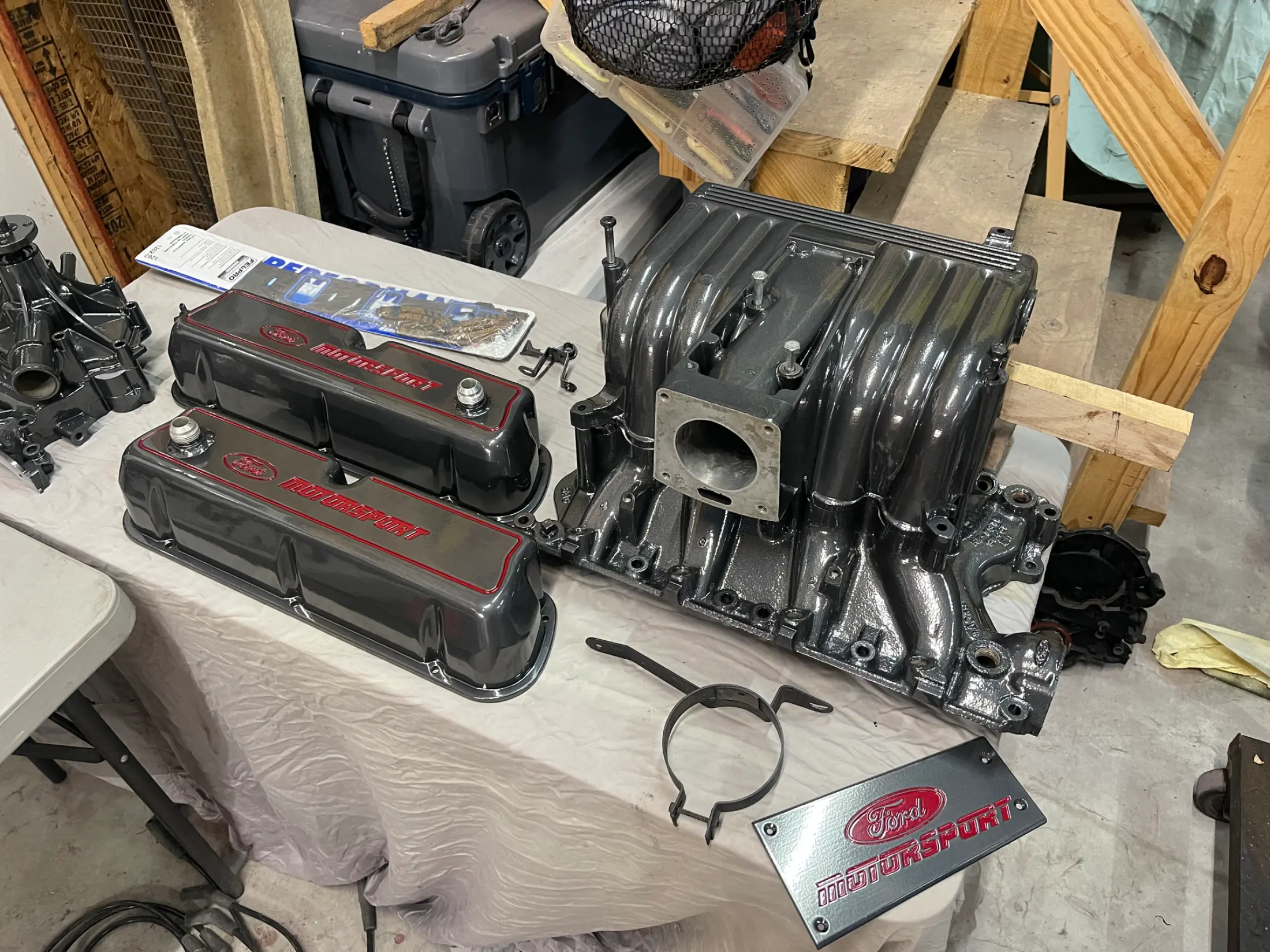

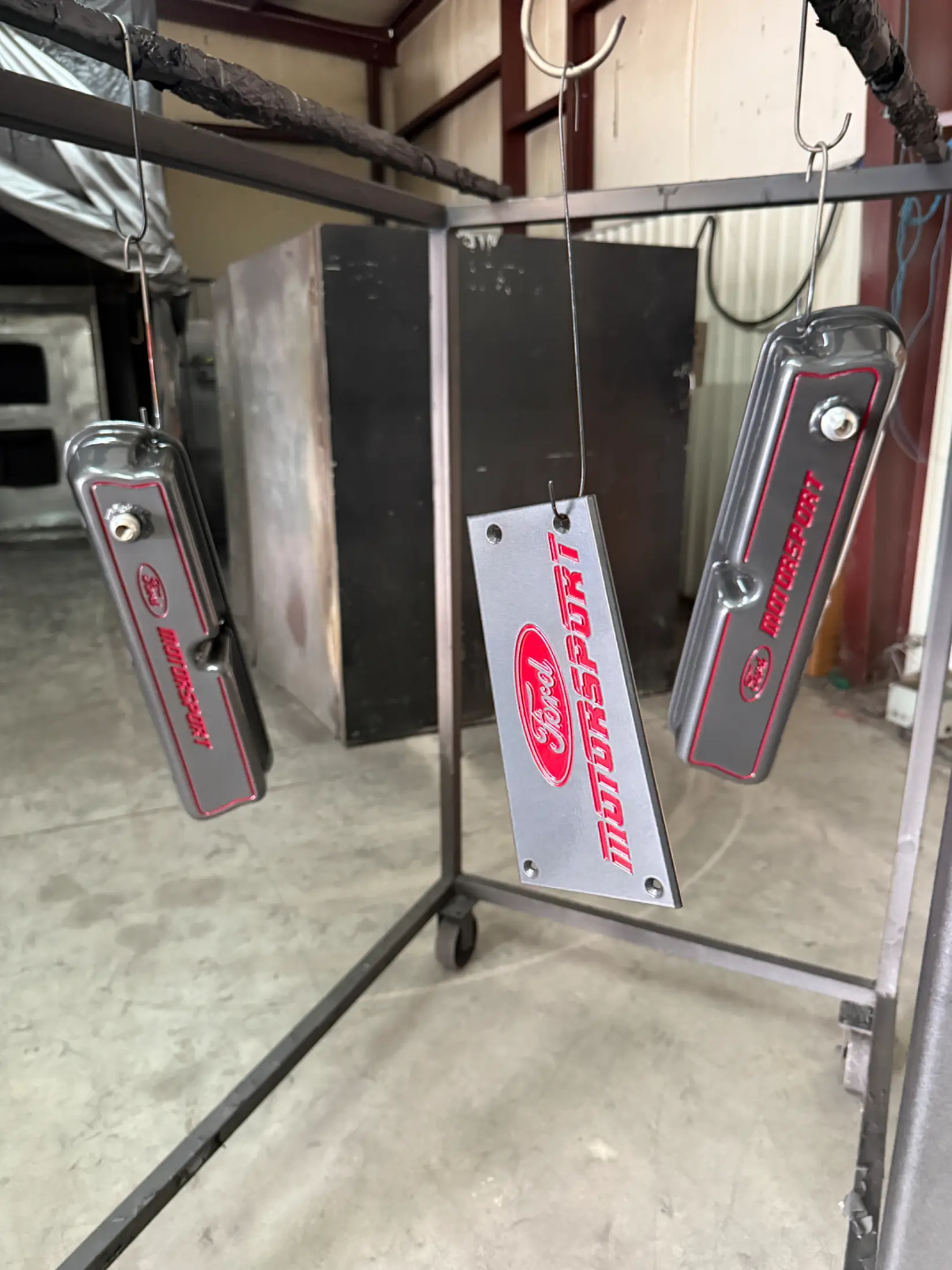

Powder coat blew my mind. I’m SO happy with the finished product

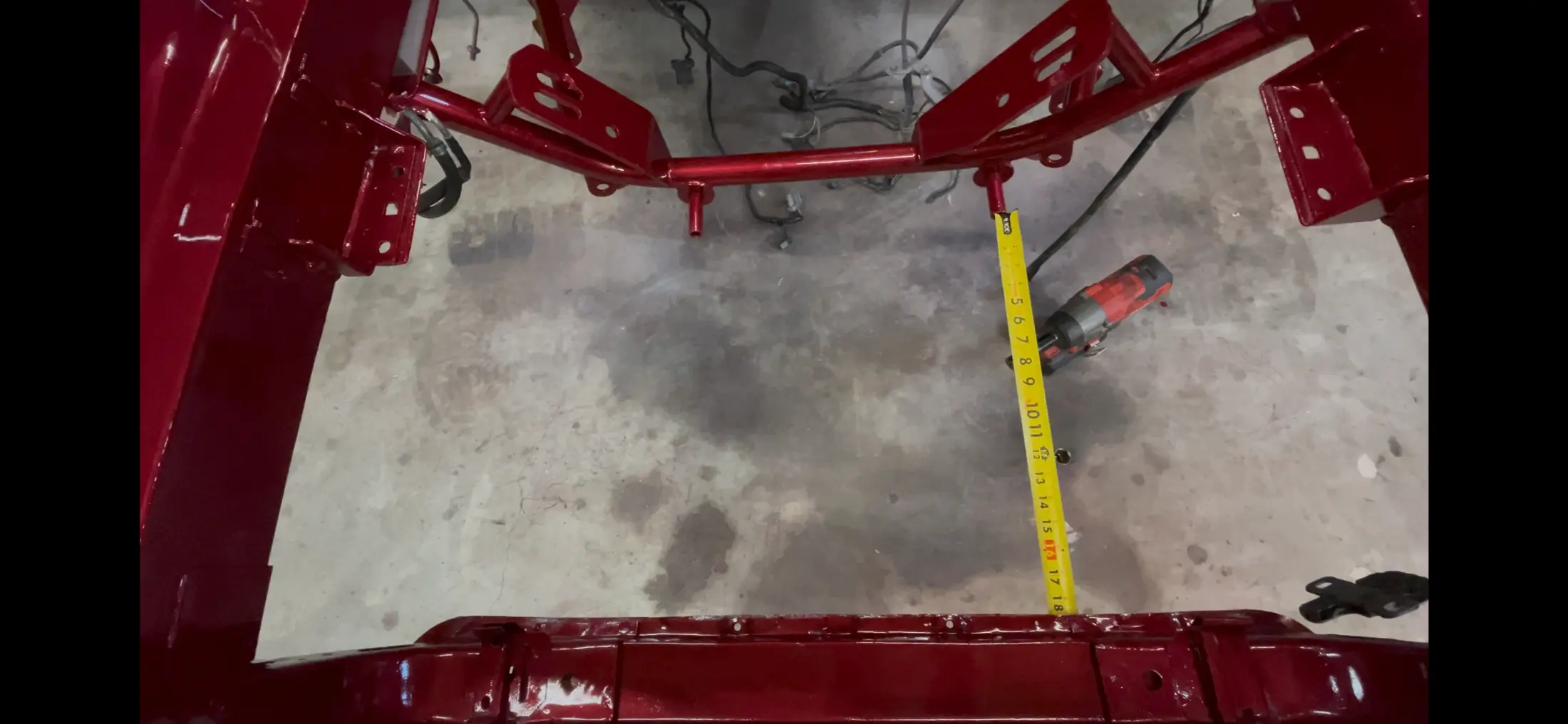

How does one square a K member, or does it matter? I measured from the front of the rack mount to the rad support and got 18 7/16” on both sides but I also know that these cars are notorious for not being square. Leave it alone?
Reactions: 85GT4V
I think Maximum Motorsports has an instruction and/or video on how to square the K-member. LMR might as well. All i know (from memory) is they use Plum bobs both front and rear and measure like every direction back/forth and crossways.
