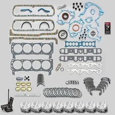

FEM-MHP174-300 Is a Summit Racing rebuild kit, it has nearly all you will need... check it out $330.00
As far as cam goes, depends on some other things, what rear gear do you have, what trans, what weight? My only suggestion would be to add more compression to help you to your goal, but with a GT40 head my guess is your 61-64cc+ which will put you in the high 8.7:1 range. I would ask to see if they have a dome option, a 8cc dome would get you around 10.3:1+ depending on the cc of your head.
You may also want to see if your machinest can get you a kit similar to what the Summit kit is. On a budget this method is the best way to go... You could call COMP to see what shelf grind they recommend
