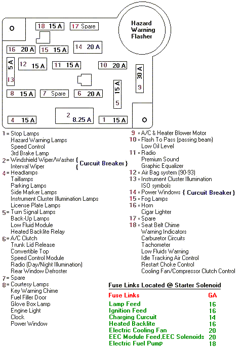

which fuse is it for the horn/cruise?
#16
Thanks to TMoss!!! Source site: http://www.veryuseful.com/mustang/tech/engine/
