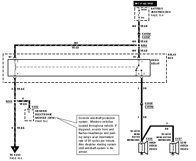

i got you covered. hopefully this is what you were looking for :nice:

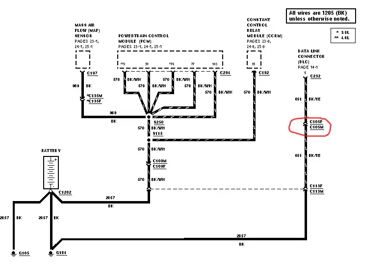

Where is the relay box and the horn relay and where is wiring connectors C105F and C105M??
I don't want to tear the horns out and replace them if it's a bad connection. I need to start testing for solid 12V but can't find where the wiring is? Anyone have a manual that shows where C105 is??
the relay is in the CCRM which is in the fender and isnt really testable. and just unplug the horn at the conecctor and see if you got 12v avail when the steerign wheel horn switch is pressed. ill check where c105 is if you really need it
