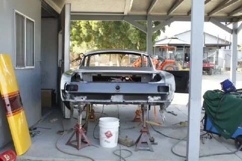

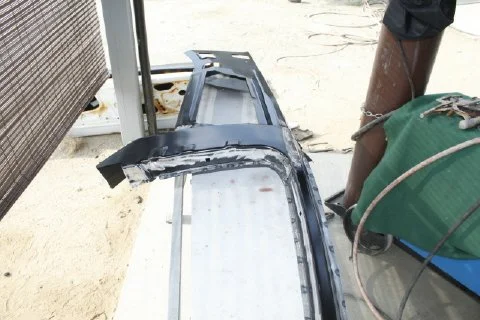

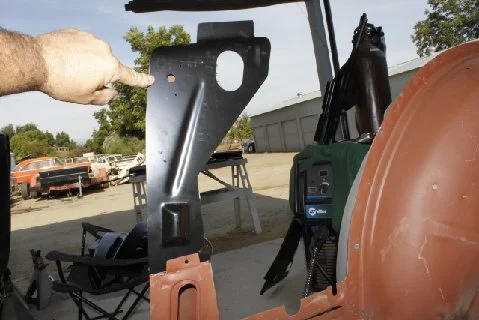

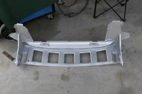

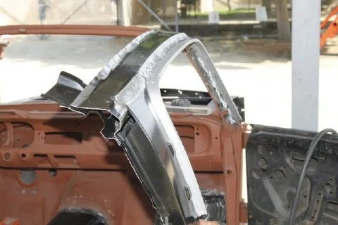

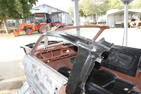

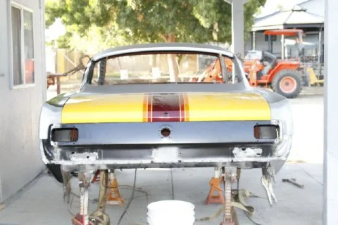

i got my deliveries done early so i picked up my parts.not every thing was there but enough to get started. the trunk devider was there and it is the first piece that has to go in.fit perfectly ,got it welded in place .even old pop and spatter was welding good:rlaugh: the door post pieces were there so i spot welded them in place .i assembled the driver upper jamb but it is only clamped in right now , i have a lot of measureing to do there .still not bad for just a couple hours work.that spot welder is a big time saver. i should be able to get pretty far with it tomarrow.

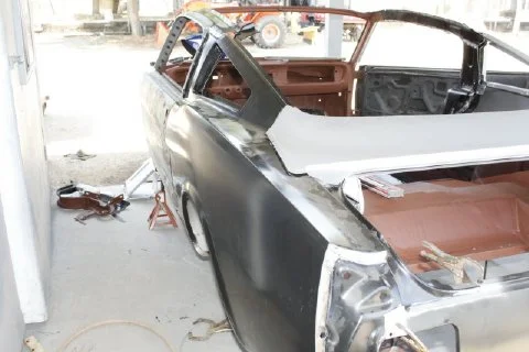

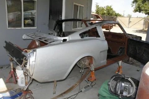

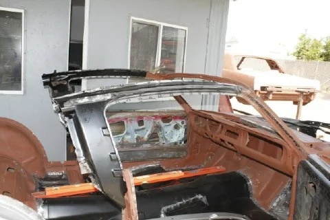

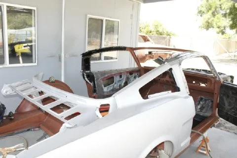

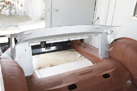

i wish i could show what i got done today,but my imaging program is down so i cant size images. both door openings are done .both quarters are on but not yet welded at the bottom in the rear.tail panel is connected to both quarters and done. back window panel is welded in .trunk lid is bolted on .end caps are bolted on . the roof is setting in place but not welded .i just have to weld the roof on and put in the rear roof under brace in and weld the bottoms of the quarters and the out side is done .then i have to make the inner bracing for the inside of the quarters and it is finnished. i hope to have my imaging program back up tonight but you know what computers are like:nonono:

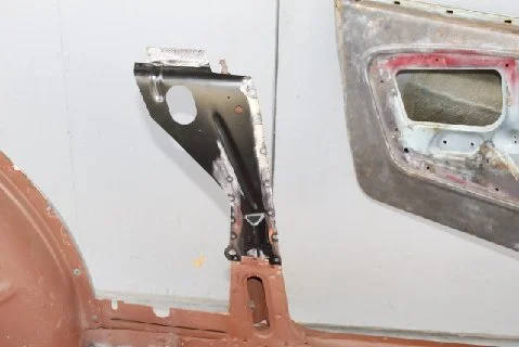

What do you do with the slot in the door jamb for the ¼ glass?
I changed out the door jambs on my '65 FB years ago and had to use door jambs out of a coupe. I made a small patch panel and just welded it up.
Are the FB door jambs available now days?
i make a filler patch but the door jamb for the fastback is now available

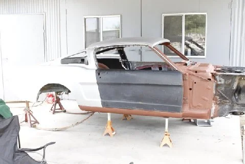

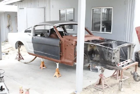

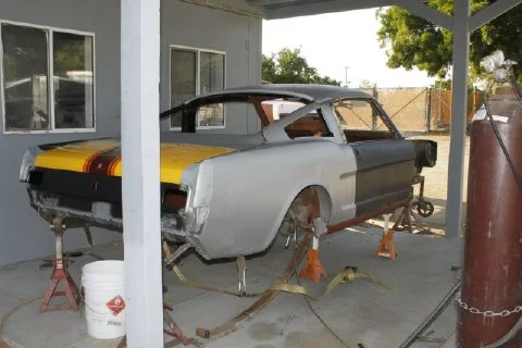

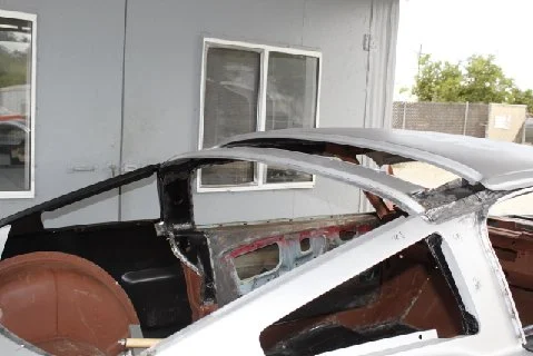

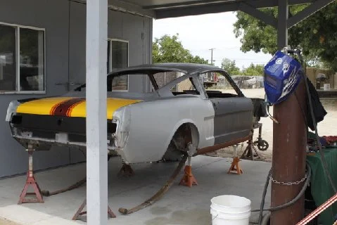

roof brace welded in ,the roof is welded on, the welds are ground ,the lower part of both quarters is welded ,she done. i still have to roll the wheel lips at the rear quarters but i am going to wait untill i get it up on the rotisserie. i have to make the inner structure still but i have other work to do this week end so it will have to wait a couple of days. not to bad for a couple days work.
