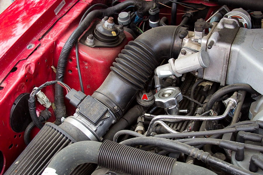

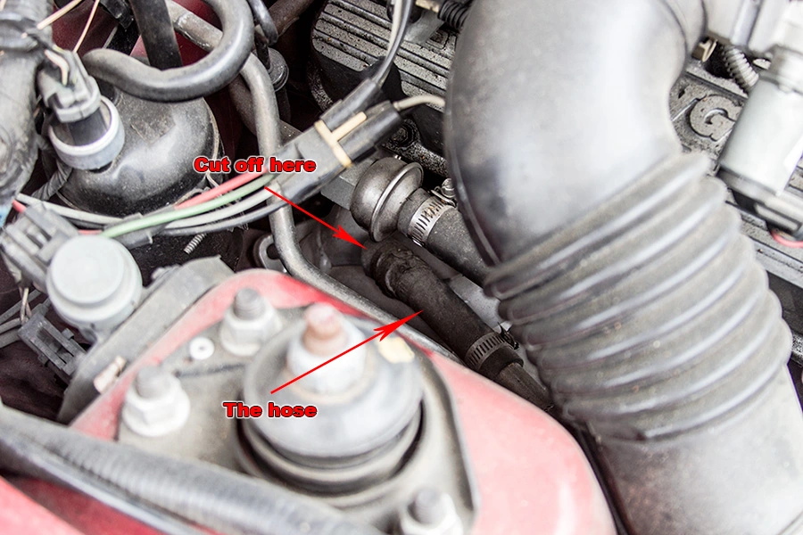

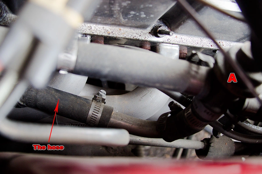

Noticed there is a hose that looks like it was cut off with a knife. Sucks in air.
Can anyone tell me what this hose is, and the problems that could be caused by having it cut open like that? Where should it be attached? The H-pipe? Is there a specific part/reference # for a replacement hose?
Right now there is an off-road H-pipe on it (no cats) and I will be putting a catted H-pipe on it within the next few days so it will pass smog and will be leaving catted H-pipe on permanently to keep it legal.
Here are some pics:

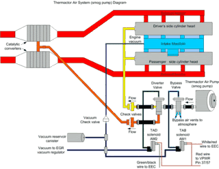

That hose normally is attached to either
a) stock h pipe with cats or
b) aftermarket h pipe
Question... do you still have your stock h pipe with the factory cats on? Is your smog pump still on the car and is the serpentine belt routed around it? Odds are you have an aftermarket H pipe and they simply removed the metal tube and capped odd that hose.

Thanks for the reply.
No, I don't have the stock H-pipe. I've got an aftermarket Mac hi-flow ready to go on it. But, I do see that there is a tube sticking out of it. I think I also have that metal tube that connects the hoses, it looks like it's about 3 feet long and has a few bends in it.
And yes, the smog pump is on there and the belt is running it.

Here's the full story on the thermactor air system:
Thermactor Air System
Some review of how it works...
Revised 17-Sept-2011 to add testing procedure.
The Thermactor air pump (smog pump) supplies air to the heads or catalytic converters. This air helps break down the excess HC (hydrocarbons) and CO (carbon monoxide). The air supplied to the catalytic converters helps create the catalytic reaction that changes the HC & CO into CO2 and water vapor. Catalytic converters on 5.0 Mustangs are designed to use the extra air provided by the smog pump. Without the extra air, the catalytic converters will clog and fail.
The Thermactor air pump draws air from an inlet filter in the front of the pump. The smog pump puts air into the heads when the engine is cold and then into the catalytic converters when it is warm. The Thermactor control valves serve to direct the flow. The first valve, TAB (Thermactor Air Bypass) or AM1 valve) either dumps air to the atmosphere or passes it on to the second valve. The second valve, TAD (Thermactor Air Diverter valve or AM2 valve) directs it to the heads or the catalytic converters. Check valves located after the TAB & TAD solenoids prevent hot exhaust gases from damaging the control valves or pump in case of a backfire. The air serves to help consume any unburned hydrocarbons by supplying extra oxygen to the catalytic process. The computer tells the Thermactor Air System to open the Bypass valve at WOT (wide open throttle) minimizing engine drag. This dumps the pump's output to the atmosphere, and reduces the parasitic drag caused by the smog pump to about 2-4 HP at WOT. The Bypass valve also opens during deceleration to reduce or prevent backfires.
Code 44 RH side air not functioning.
Code 94 LH side air not functioning.
The computer uses the change in the O2 sensor readings to detect operation of the Thermactor control valves. When the dump valve opens, it reduces the O2 readings in the exhaust system. Then it closes the dump valve and the O2 readings increase. By toggling the dump valve (TAB), the computer tests for the 44/94 codes.
Failure mode is usually due to a clogged air crossover tube, where one or both sides of the tube clog with carbon. The air crossover tube mounts on the back of the cylinder heads and supplies air to each of the Thermactor air passages cast into the cylinder heads. When the heads do not get the proper air delivery, they set codes 44 & 94, depending on which passage is clogged. It is possible to get both 44 & 94, which would suggest that the air pump or control valves are not working correctly, or the crossover tube is full of carbon or missing.
