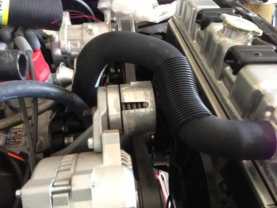

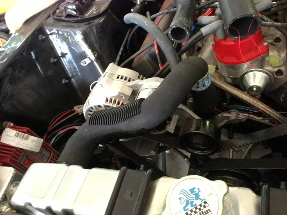

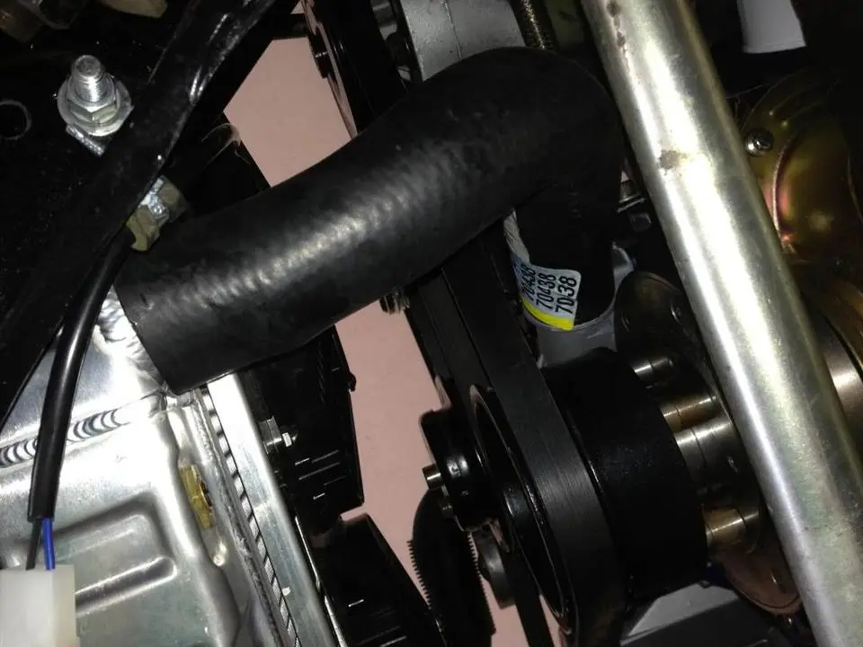

I went to Advance Auto Parts and bought about 10 different hoses based on the results of some more aggressive online searching. I ended up using Dayco C71280 for the upper, and a Dayco C70438 for the lower
hoses. The upper hose only needed about 1 inch, max, removed from the thermostat housing end. The hose clears the alternator and serpentine setup very well. I originally thought I was going to need to couple two butchered hoses together to make this work. The lower hose needed some trimming as well, but I don't remember which end. Also be sure to use the anti-collapsing spring to ensure that the hose does not kink. To me the setup looks "OE" and only cost about $24 for the hoses I used. The other eight hoses did get returned.
Again this is the setup I'm using:

Being used with a 5.0L block with the serpentine setup from a 87-93 Mustang. The Waterpump is on the driver side, and the inlet for the radiator is on the passenger side. I believe the Griffin Radiator is pretty close to a Big Block Radiator for 1967 and 68 Mustangs.
