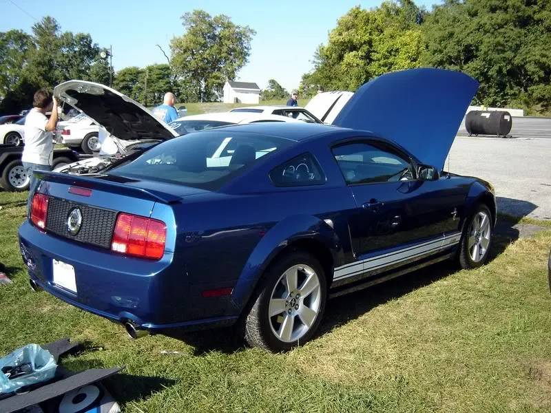

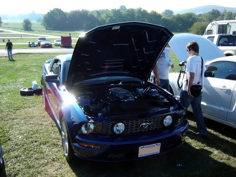

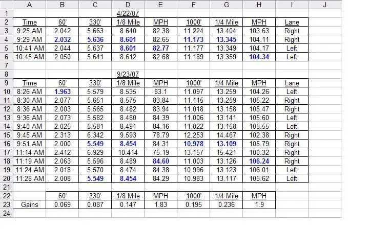

Back on topic. I hot lapped my car numerous times last year without any real negative impact. My second time to the track, my #s were all over the place only due to very poor traction on the 18" OEM radials. Once I got my launch back under control(had to drop my launch RPMs to about 1000), my #s improved. On the chart below, you will see the time of each run and can see between the hot laps I took at least a 45-60 minute cool down period with the hood open and facing away from the sun to avoid the sun.
I was able to get so many back to back runs as our Mustang Club had a private track rental and were about 40-50 of us. Resulting in going right back to the staging lane and only being perhaps 1-5 cars in front of you at any given time.

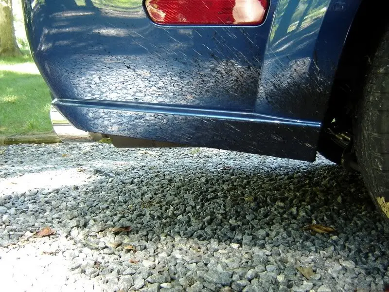

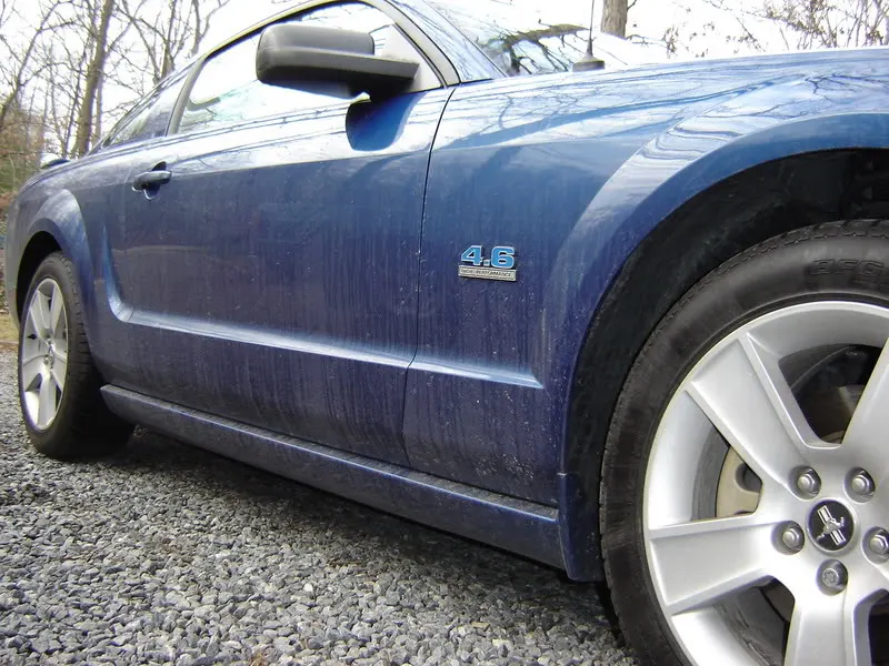

P.S. Here is the havok I caused to the OEM radials on the last trip to the track(9/23):)
Ouch, how did you get the rubber off the rear quarters?
Dan

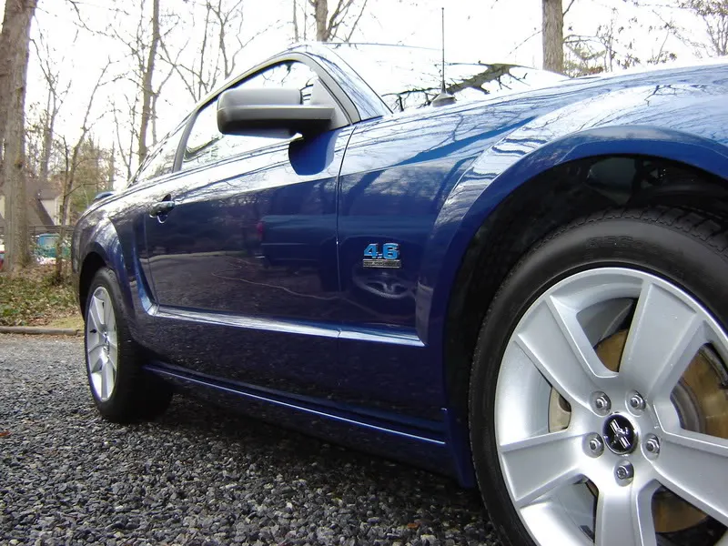

Westley's Bleech White and it came right off:nice: I love that stuff as I never have to scrub my wheel wells to keep them clean...just spray and hose!
Pics from about a year ago, but shows how well Westley's works with no scrubbing in the wheel wells and absolutely no other products used to get them that clean:nice:
I agree I have not seen another that looks better IMO:nice: . I have even gone as far as showing it to many of my friends on your car domain page. Awsome!!!!! If only I had the money to do mine that way:(

Kool, man you beat the snot out of your baby that day. Your lucky to get so many passes. Up here, no matter what track, no matter what day, no matter if private or not, your get 4 to 5 passes at best. Tracks overwhelmed on any test and tune day, and if there is any scheduled racing, you get slid even further behind that..
