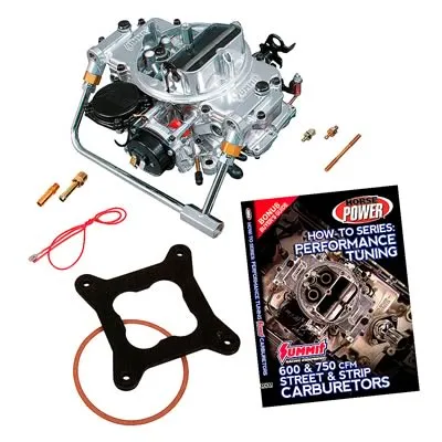

The Summit™ carburetor was Holley's attempt, about 20 years ago, to copy some of the 4100 features, such as annular discharge (only on the primaries) and top cover on a one-piece bowl and body. It had a few things going against it- Not a traditional Holley design,not well marketed, and they didn't copy enough of the 4100 features. For instance, it had no internal feed for the rear bowl, and required a bulky external dual fuel line, like a Holley double-pumper.
