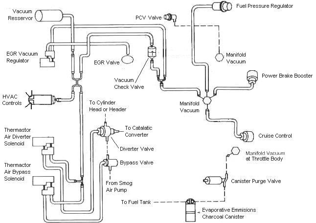

I'll have to take a close look at the vacuum system. I do hear a "whine" that starts when come to a stop.
Dumbass question… how should the vacuum hoses be routed into the EVR (EGR vacuum control)? I think I had it hooked up backwards.
The vacuum system has been simplified after the smog pump removal so I don’t have the tree or the reservoir. It’s just manifold to FPR and manifold to EVR/EGR.
The vacuum source line from the manifold should connect to which EVR connector stud? The long or short one?
@jrichker for the EGR vacuum routing please

When I was cleaning up the engine bay I did notice I installed the vapour purge solenoid backwards because I flipped it over. Doh! So that got me thinking that I also crossed the EVR hoses.
I’ve stared at diagrams already and they don’t specify which connector goes where.
The vacuum block is removed along with the nylon lines.
That one wasn’t helpful. I used the one I attached. I guess the longer connector stud goes to the manifold and the short connector stud goes to the EGR.
Replacing the vacuum lines and rotating the purge solenoid to the correct orientation fixed the problem. Now there is only a slight fuel smell. I’d say the majority of the smell was coming from that fuel tank… now the fumes are getting sucked into the engine as designed.
