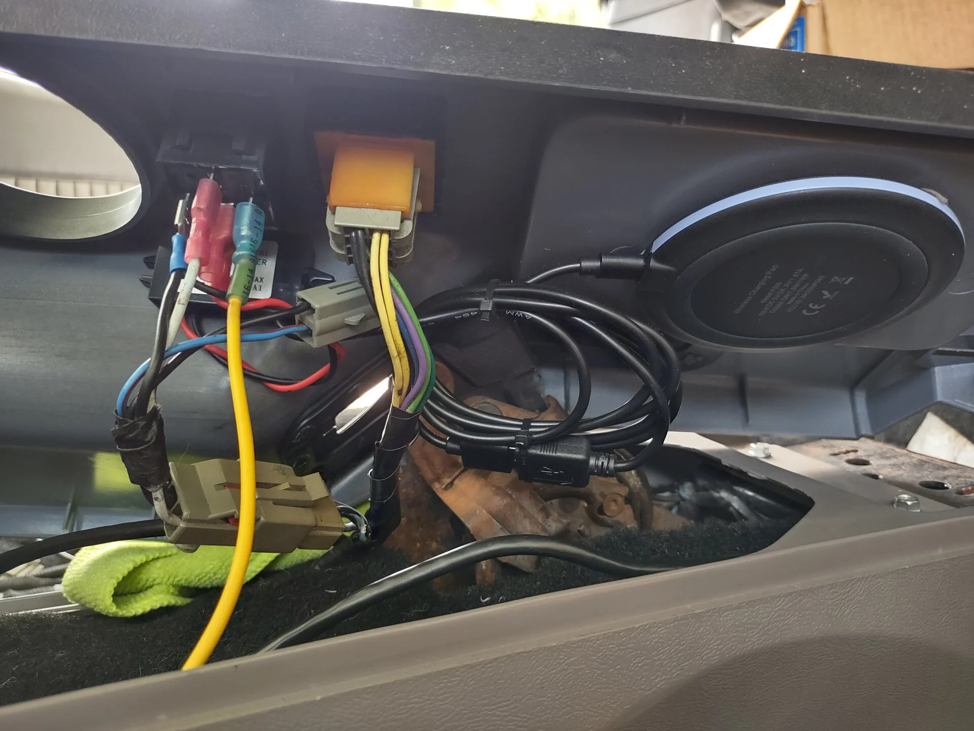

I wired in a relay to run a DC-DC converter to power a wireless phone charger under the coin tray on the cupholder console. Works perfect no wires no mess. I have 2 usb charger plugs on the ashtray delete panel.

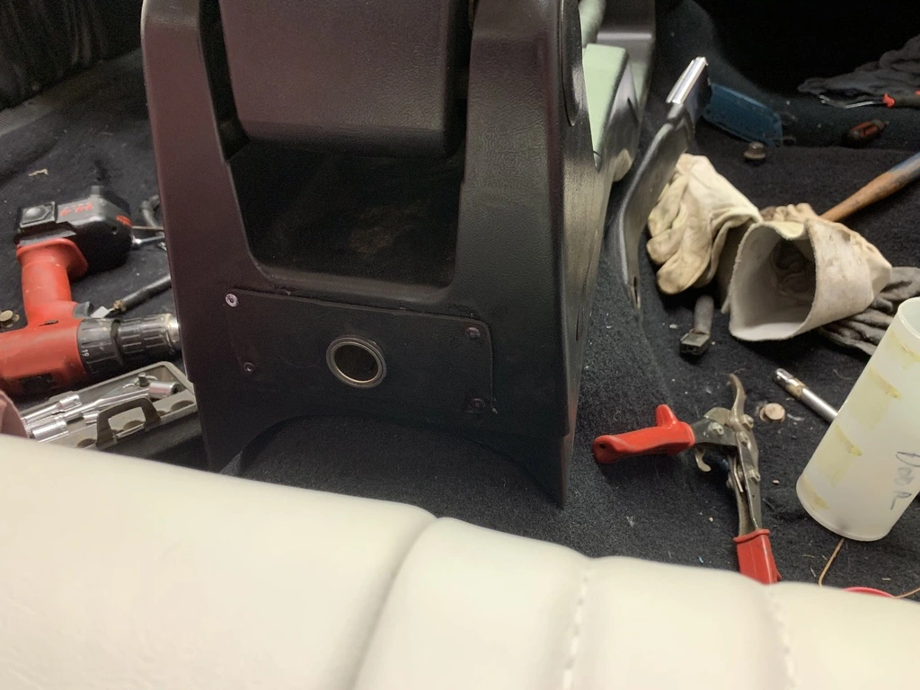

I did the same thing. My ash tray was broke. I don't smoke. So I got the cup holder for my 93 LX. I took the console out. I took the lighter/ now power outlet out. When I had the console out, I took the ash tray in the back of it out. Cut a piece of the old console to cover the hole. Pop riveted it over the rectangular ash tray hole. Drilled a round hole to fit the outlet. You have to add some wire from the old lighter connection to reach the new location. But it is out of the way and it works. Did I mention it doesn't cost anything because you use all the old parts?

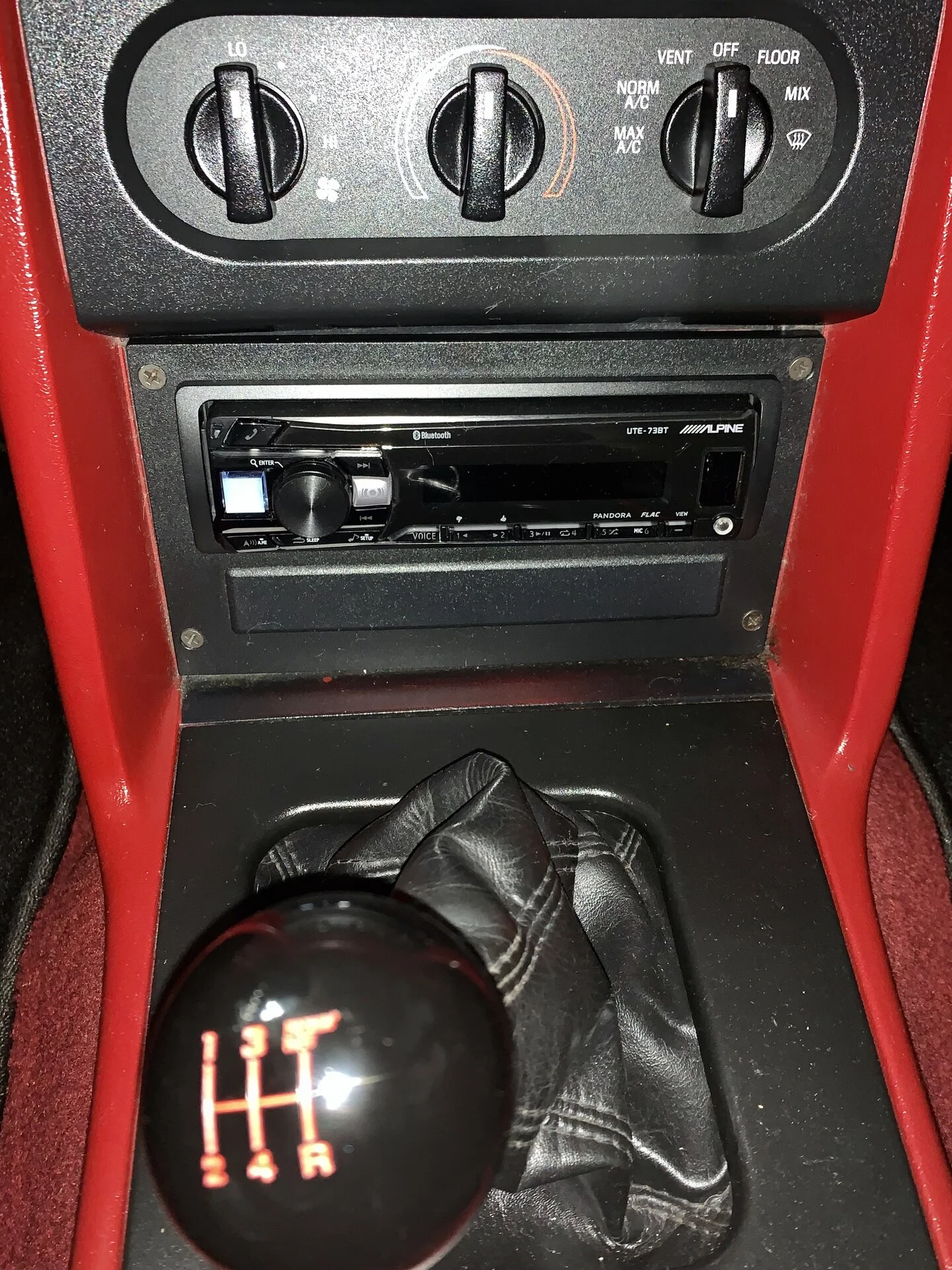

So what is the black circle of plastic for in front of the ash tray? I popped the center and tried to lift the edge like a body plug, and that did not work. Was it for a factory nitrous trigger or convertible top switch?

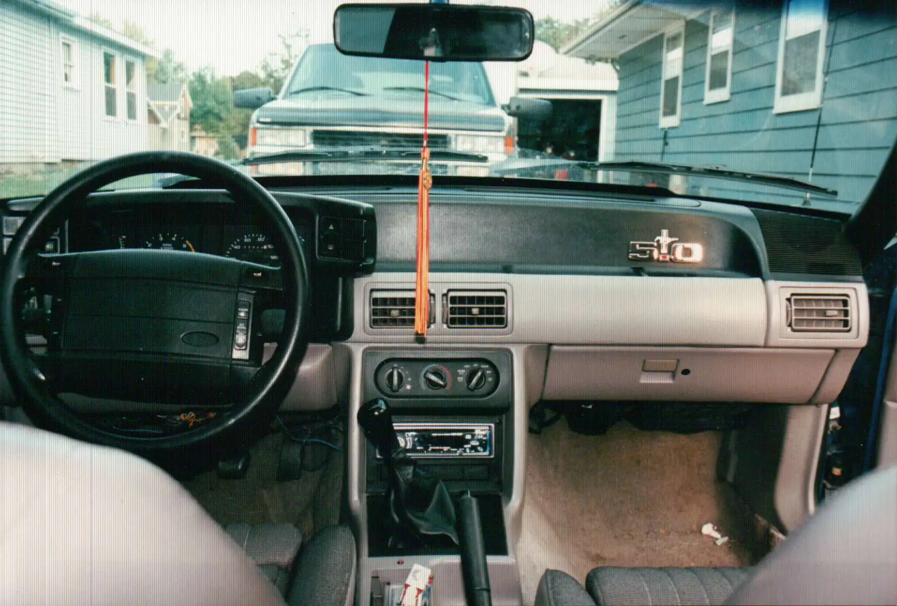

My car had something similar to that when i bought it. It was a light that flashed when the after market alarm was turned on.
You can see it here in this really old pic of my car.

12v to 5v dc converter and a wireless charging pad. Wired through a relay so it's only on with ign power. Some double-sided tape and your done.
Everything needed can be found on Amazon cheap
