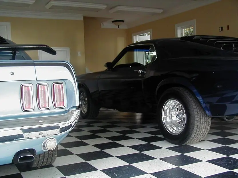

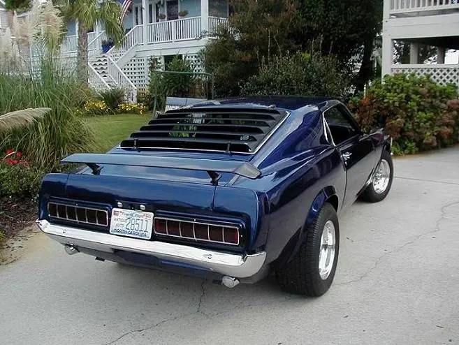

I'm running 15x10s w/ 295/50R15s in the rear of my '70fb with slightly rolled fender lips. Unless the '67s fender wells are larger than the '70s, I don't think you'll get 16x10s to work without some fender mods, depending upon what size tire you're using of course. There not great but here of some pics of my car to get an idea the clearance.

Yea thats a little too wide for me i want them tucked away in side the fender well with out rolling it
