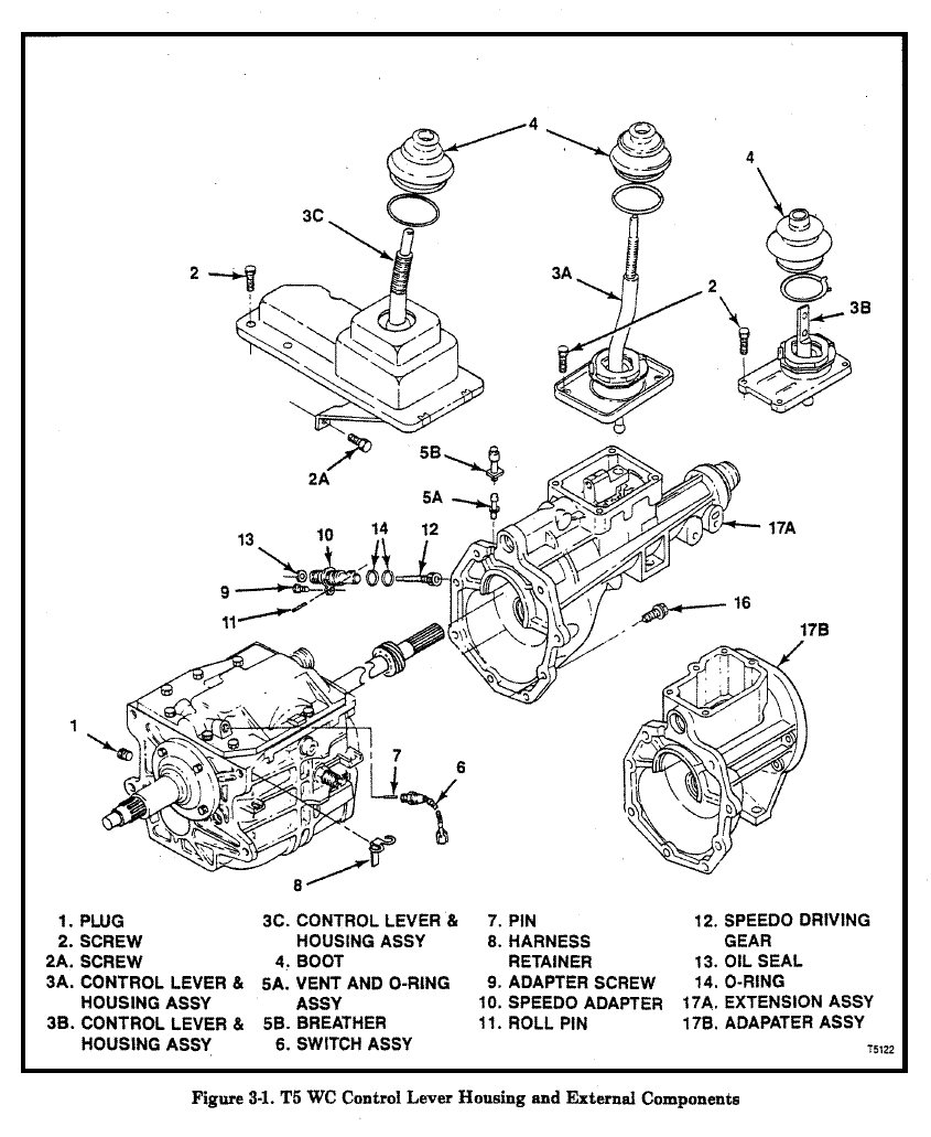

hey guys! so i have an 89 mustang gt and i went ahead and put a 92 mustang transmission in it. i noticed that the 89 transmission had 2 wires connected to.it (one was for the reverse and the other was for the neutral/clutch safety switch). the 92 transmission only had 1 connection, and that was for the reverse. so i installed the 92 and plugged in the reverse cable and just zip tied the safety switch. when i went to start it up, all the lights and everything came on. when i turned the key all i heard was a loud click. the wire being disconnected led me to believe that it was the clutch safety switch. but im not sure. i also think its weird that a 89 t5 has a clutch safety switch, but the 92 t5 doesnt? is there any way i can bypass the switch since i have nowhere to connect it on the transmission? if you guys could please help. id greatly appreciate it. thanks guys.
-steven
The Neutral Safety Switch (NSS) has nothing to do with the starter circuit on a manual transmission Mustang. The 92 T5 trans came with one as standard equipment. Someone may have sold you another model T5.
See the diagram below, item #8...
