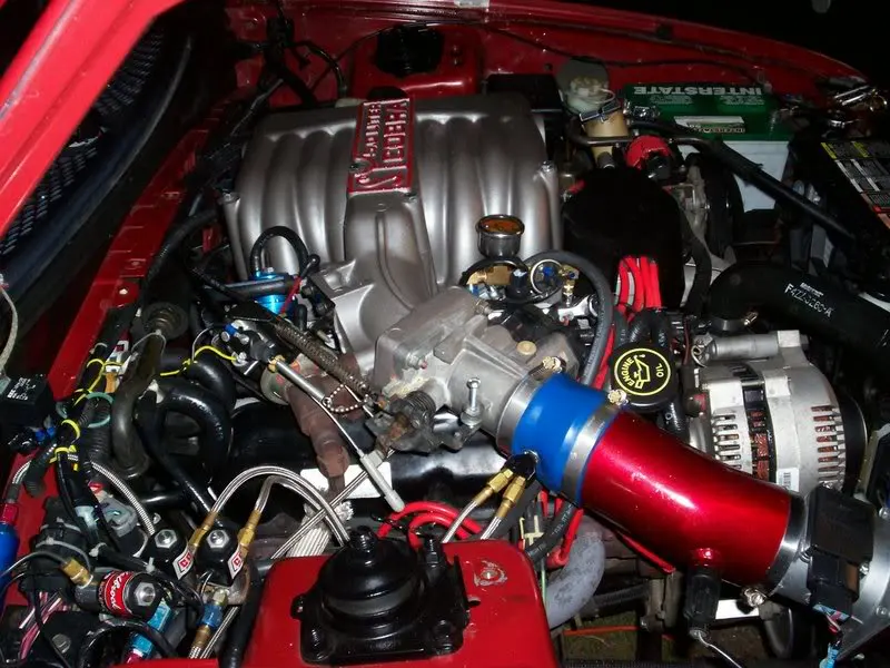

iwashmycar said:
where is the idle screw?
in the pic below you can see my idle set screw on the throttle body. i removed the factory screw and replaced it with a longer screw with lockwashers and nuts on each side of screw plate to hold its position....i would reccommend to change this as i did because its alot easier to adjust.... to remove factory screw just carefully tap old screw out with a hammer the screw and thread insert will come out easily and replace as stated above. there is some good info in this link....http://www.muscularmustangs.com/maintain.php
