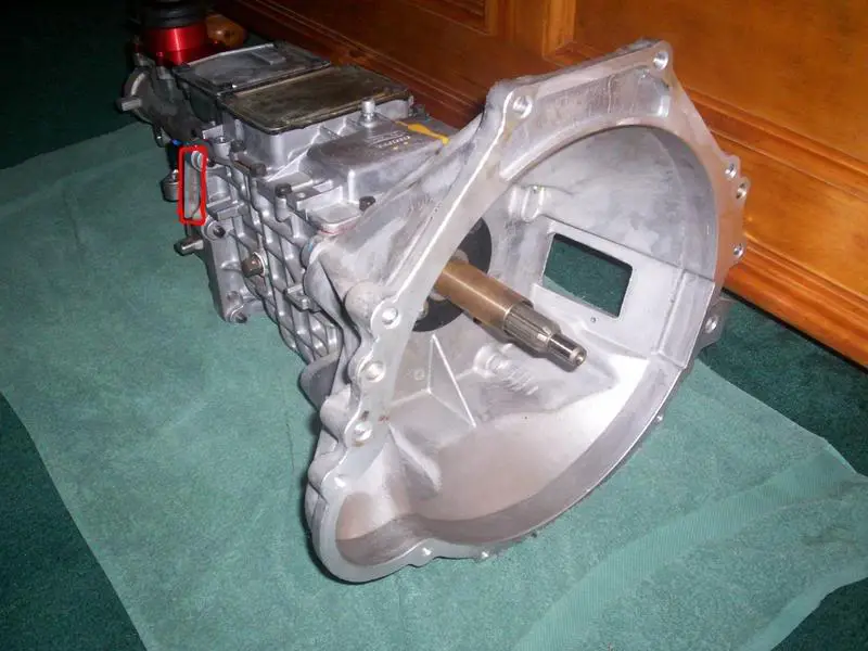

check to see if the tin metal tag bolted to the tail housing is in place and post the numbers off it. below is a pic. of my tko 500 with tag outlined in red.
