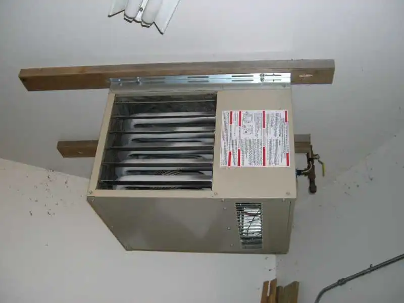

Stay toasty with one of these. Went to the local heating and air company and found this. 480 bucks. Natural gas, close loop heating and uses a chimney so you won't be choking on fumes. Wife was skeptical with I bought it but loves it now on cold mornings.

This bad boy keeps it downright toasty. In the morning when it's 25 degrees in there it takes just a few minutes to bring it up to comfortable.
Wow! Nice setup!
I didn't know it got that cold in AZ.... how much did that unit run you?? I bet installation was murder on your wallet.

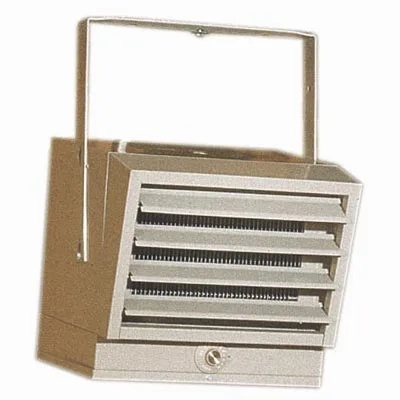

I use two of these to heat a 1200 sq ft workshop.. I mounted the control down low on the wall for adjustment. I didn't have gas close, so it was the best route I could find. $200 each when I bought them. They work great, and are thermostatically controlled. I hope the attachment works.
Fahrenheat Ceiling-Mount Automatic 5000 Watt Electric Heater, Model# FUH5-4
Heats things up fast AND saves floor space! No blast of cold air at start-up — automatically delays fan action until the long-life heating element is warm. Fan continues until the heating element cools off. Built-in thermostat. Powerful heater delivers up to 17,065 BTU/hr. Horizontal heat flow and adjustable downflow positions allow it to distribute heat evenly throughout the room. Plated fin heating element provides uniform heated air discharge. 14in.L x 12 1/2in.W x 12 3/8in.D. 240 Volts, 5000 Watts at 17,065 BTU/hr. 21 Amps. Ceiling mount bracket included. U.S.A.

The furnace was there when I bought the place. Installation looks pretty straightforward though -- hang it, elec & gas hookup, chimney. It's controlled by a thermostat as well. My garage is well insulated, has double-pane windows, etc. so the heater doesn't have to run that much. The 300 days of sun a year help a lot too. :D
Flagstaff is not your typical AZ town! My house is at almost 7000 feet of elevation. Here's a pic from yesterday:
