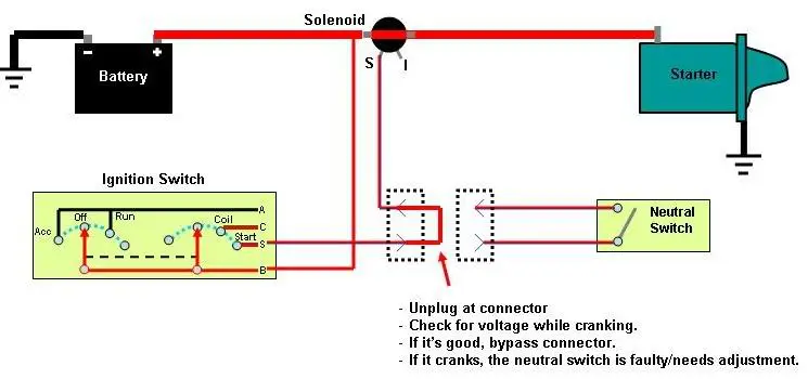

Ive read up on the posts regarding no start/electrical issues and it sounds like this may be my problem. So the question is, how do you jump the neutral safety switch?? Or if possible, how do you adjust it? I have a 70 with a 351/c4. It has one plug with 4 wires. 2 red 2 black. And anyone w/ a 70 tell me which way the wires go on the solenoid posts. red w/ blue stripe on the left or right?? Ive seen both in different diagrams... Thanks :cheers:
I posted this in a recent post:
a '70 should be similar. The red/blue wires are the ones you are interested in. The black ones are probably for the Back-up lights.
If jumping it fixes your problem, it may just need adjusting. The switch (on a C4) allows about 1/4" of movement by loosening the two mounting screws. It's right behind the shift linkage where it goes into the transmission.

mitchcj1 said:
So to jump, just put a wire in the plug into each of the red wire holes?? Thanks the diagram is helpful. Also, the 1/4" of movement, what am I trying to accomplish??
That is correct, you want to jump the red wires in the connector located at the firewall. I experienced this myself this past weekend.
