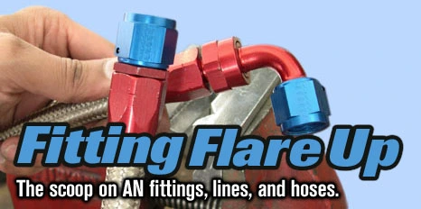

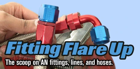

This article may help you too:
http://www.fordmuscle.com/archives/2004/12/ANfittings/index.php
