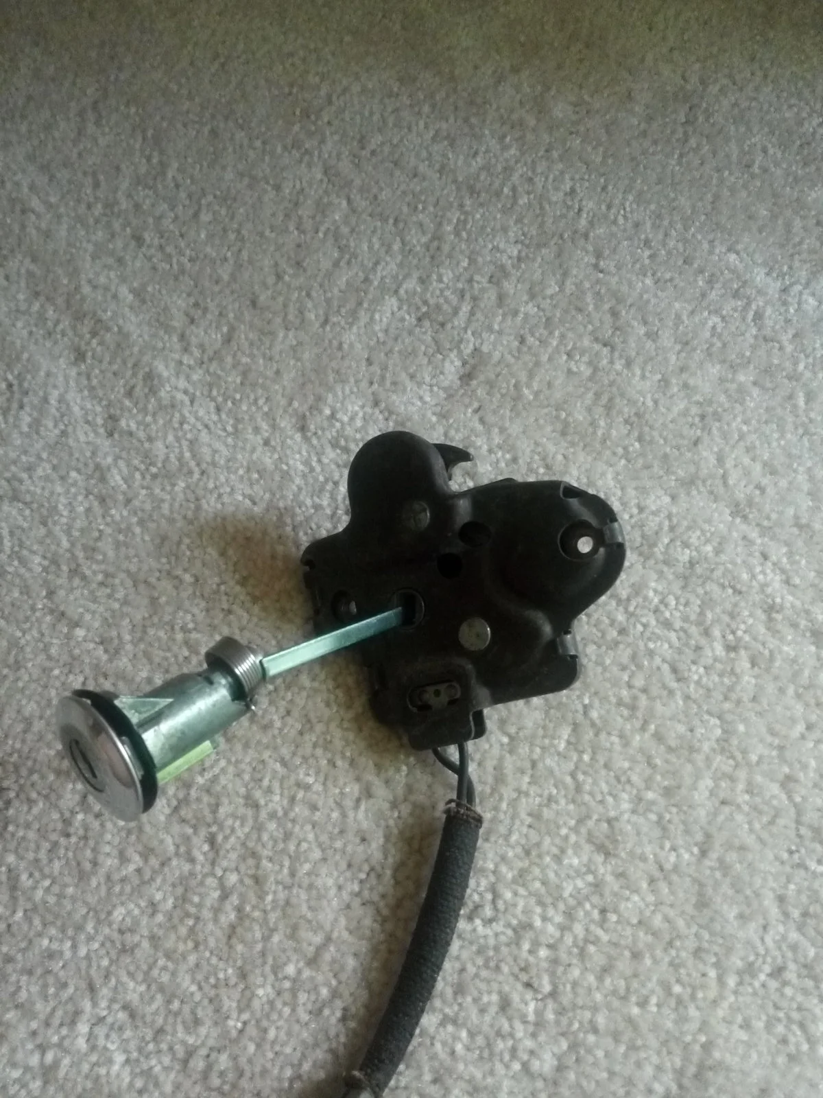

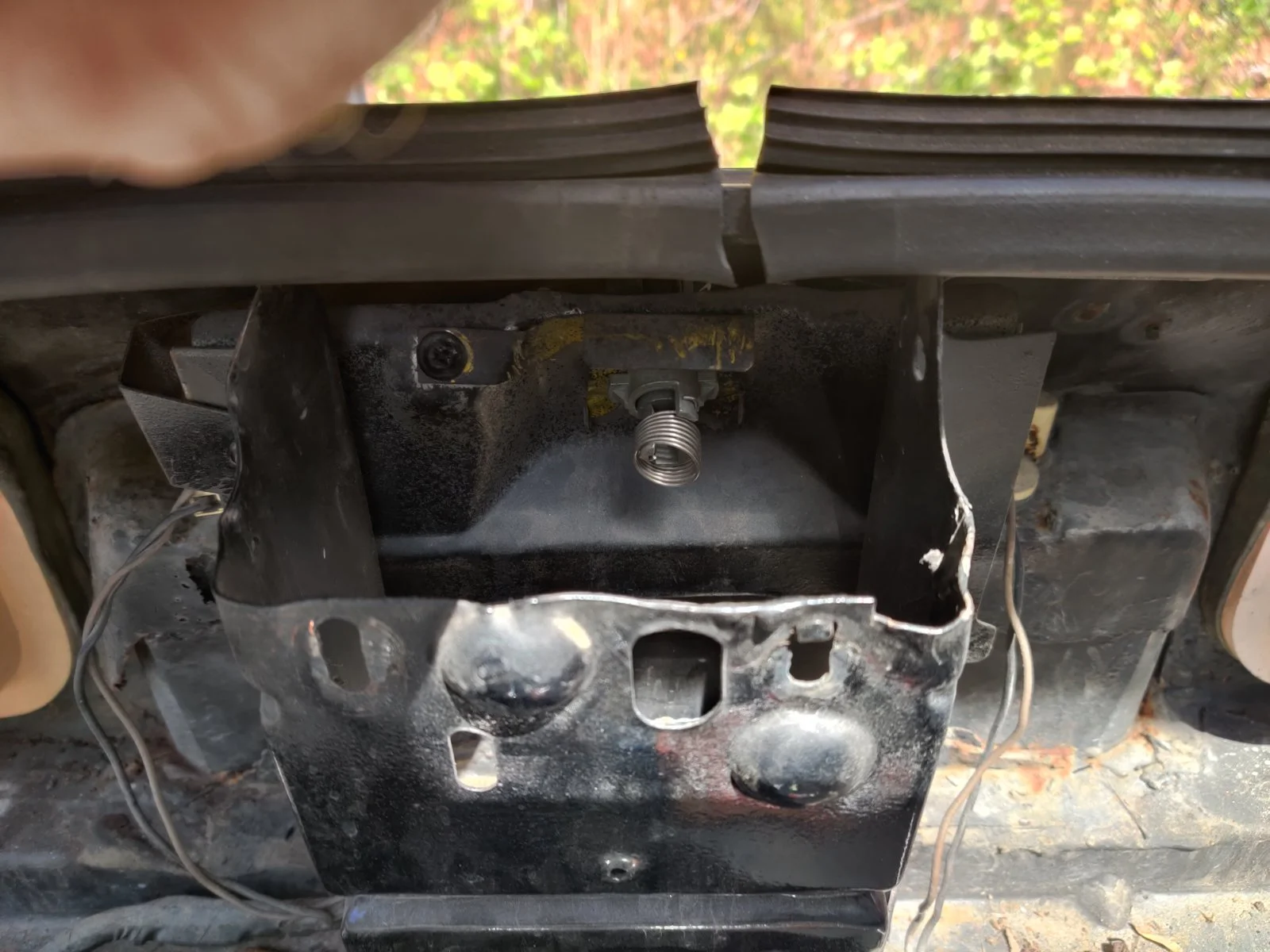

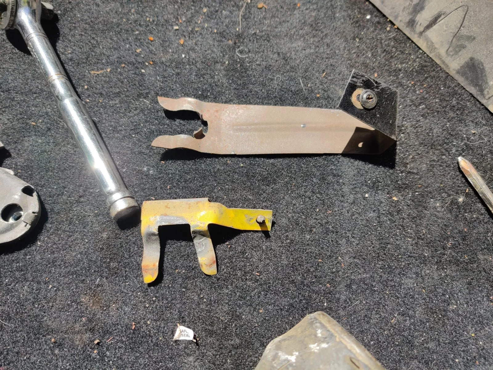

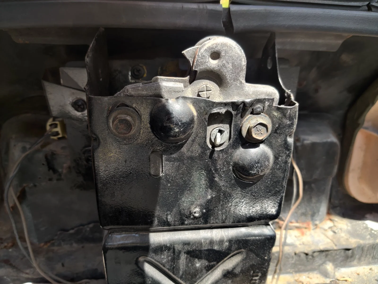

Ok, I finally have some pics for you today. I needed to replace my lock cylinder as well as install the catch, so here are some of the pics from the steps I took.
There are 2 clips holding the lock cylinder in place. One is easily identified, the other is behind the box and clamps the cylinder to the rear body panel. They are both "locked" in place by screws through the tabs. Remember, you'll need to install the flat rod before clipping it all in place. It's a PITA if you don't. Ask me how I know.... lol
You'll notice that my locking mechanism is also f'd up, so now I'll need to shop for another and do part of this all over again!!

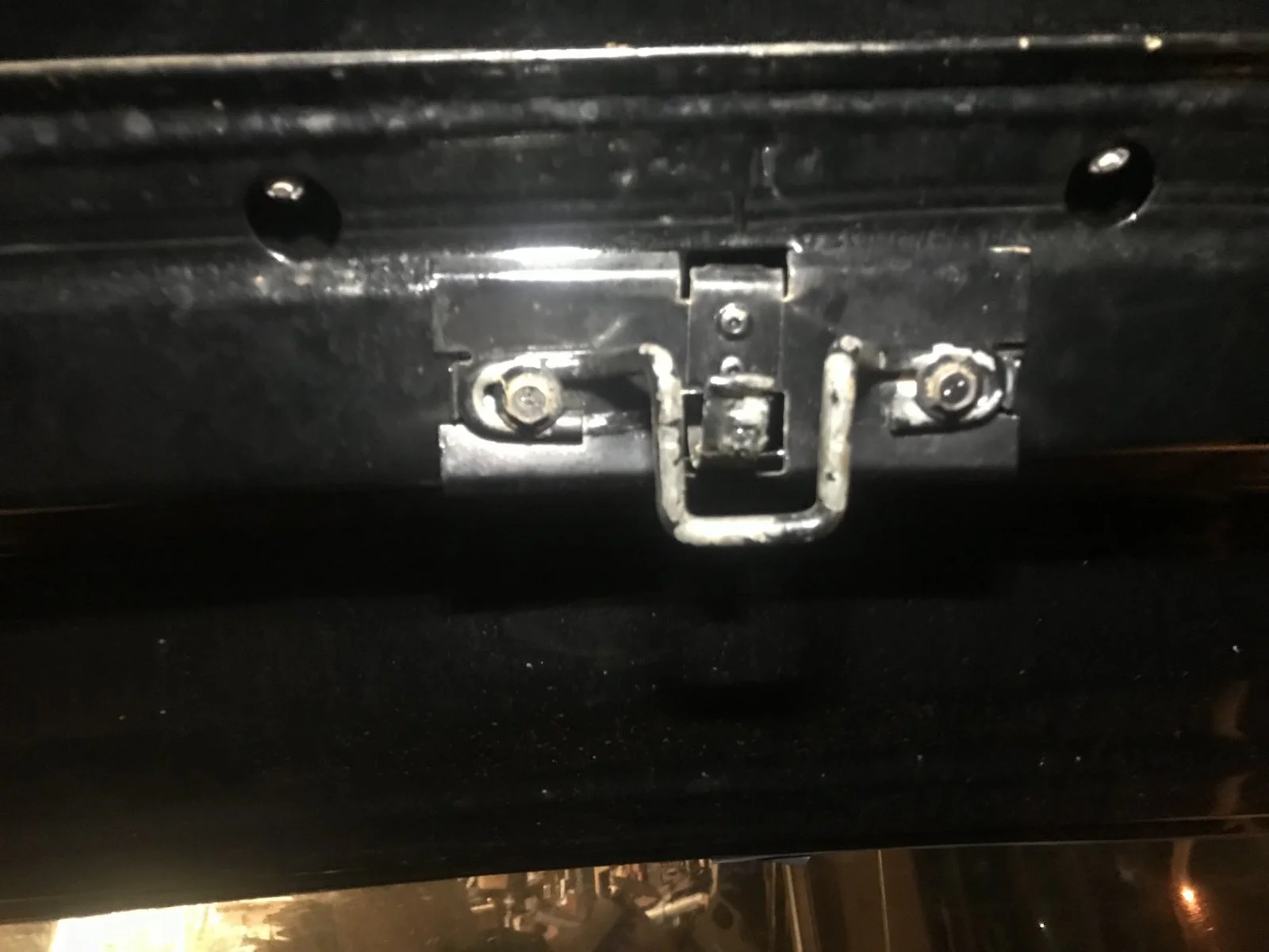

Thank you for telling me the install but what I need is a pic of what catcher lachs on to when you close the because my is completely gone

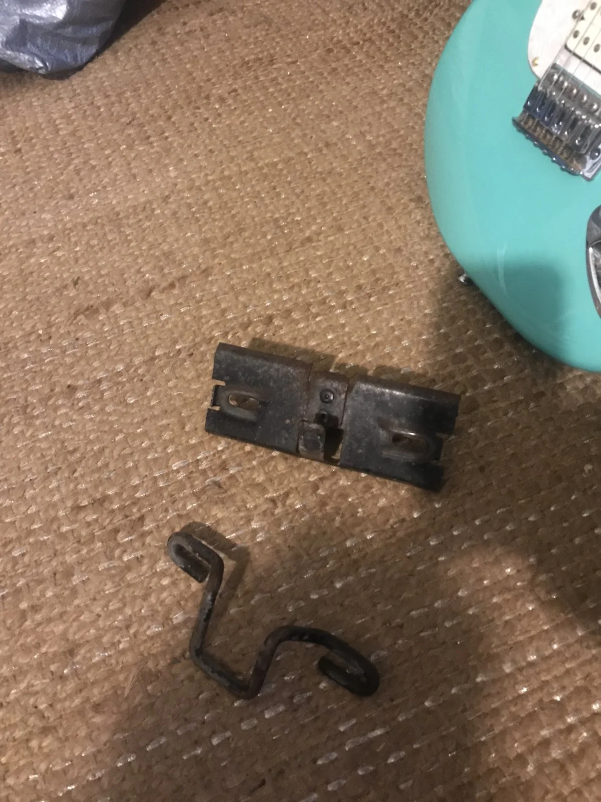

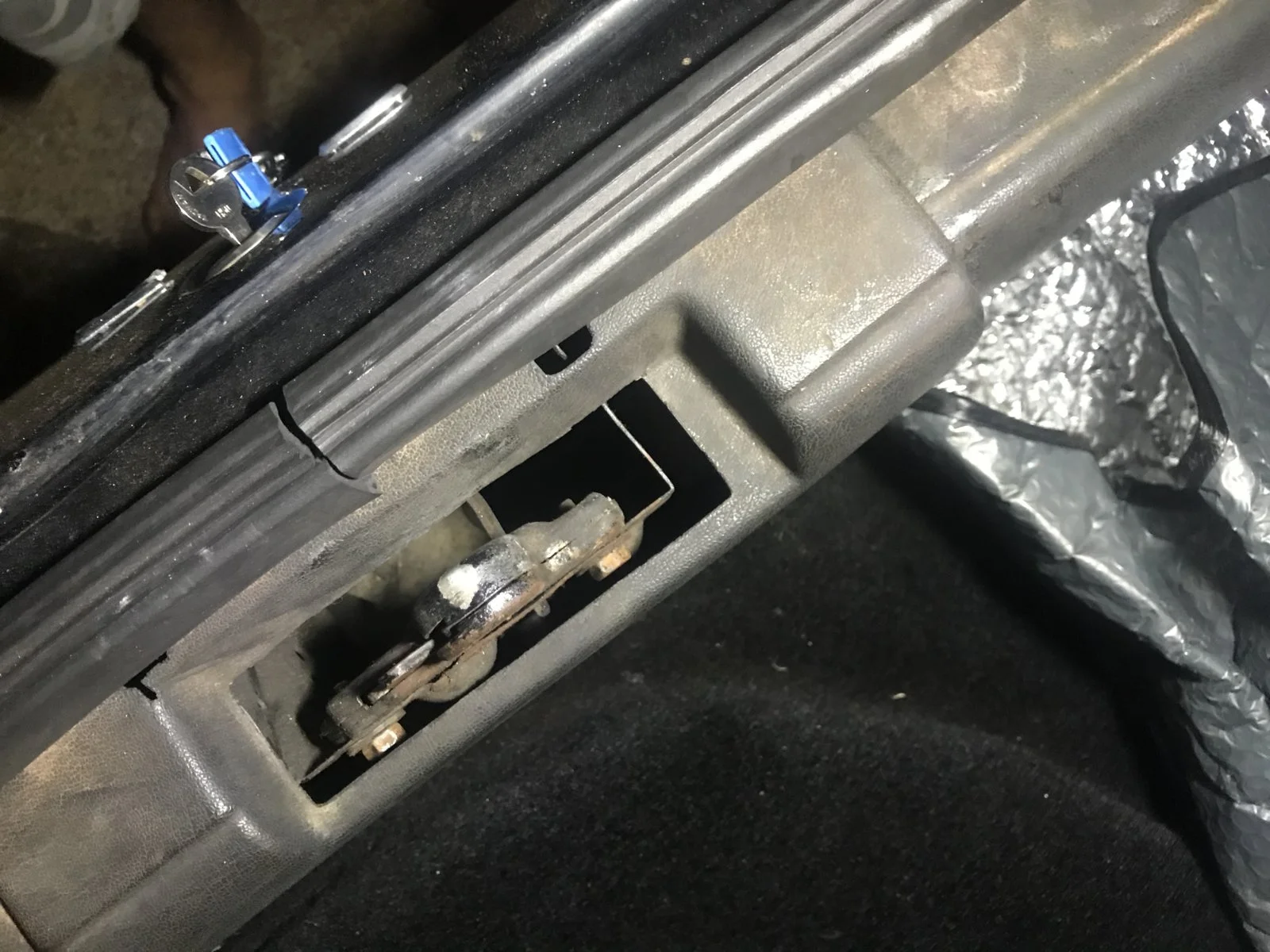

Your wish is my command
wire catch and it bolts tru loops sandwiching the spring plate

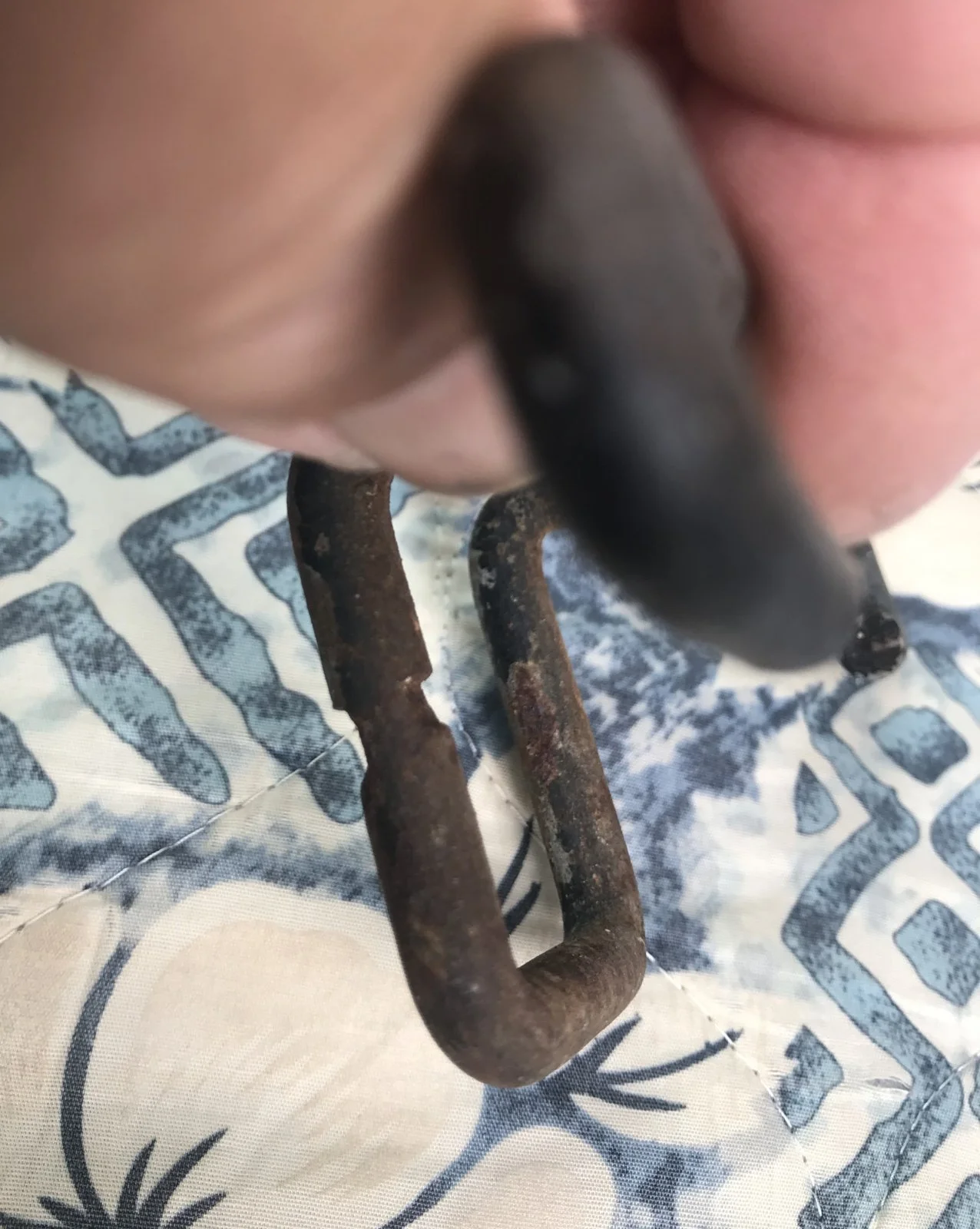

This one showing the excessive latching wear on one I gave brother Lilcobra
