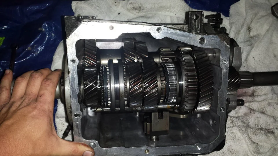

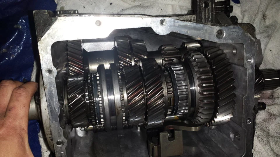

I'm going to be rebuilding my t5. I'm just wondering for the people who have done this before, how does everything look inside as far as my gears and things go? This will be my first t5 rebuild! I have removed trans myself and taken the tail housing off, along with the top plate. I ordered a rebuild kit that should be here next week. Just want the guru's opinion on what I need to replace.
Also what's the best way to clean out the trans case? I'm leaving the counter shaft installed, don't have a press. How can I clean out the outside and inside so when i put it back together everything is clean?

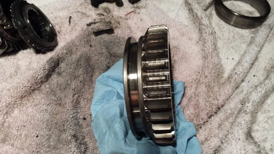

Need closer pics of the dog teeth that engage the sliders. That's what you really want to inspect.
They need to be sharp and not rounded over. You also need to inspect the sliders teeth that engage them. If these are rounded over, you run the risk of the gears grinding when you try to engage.

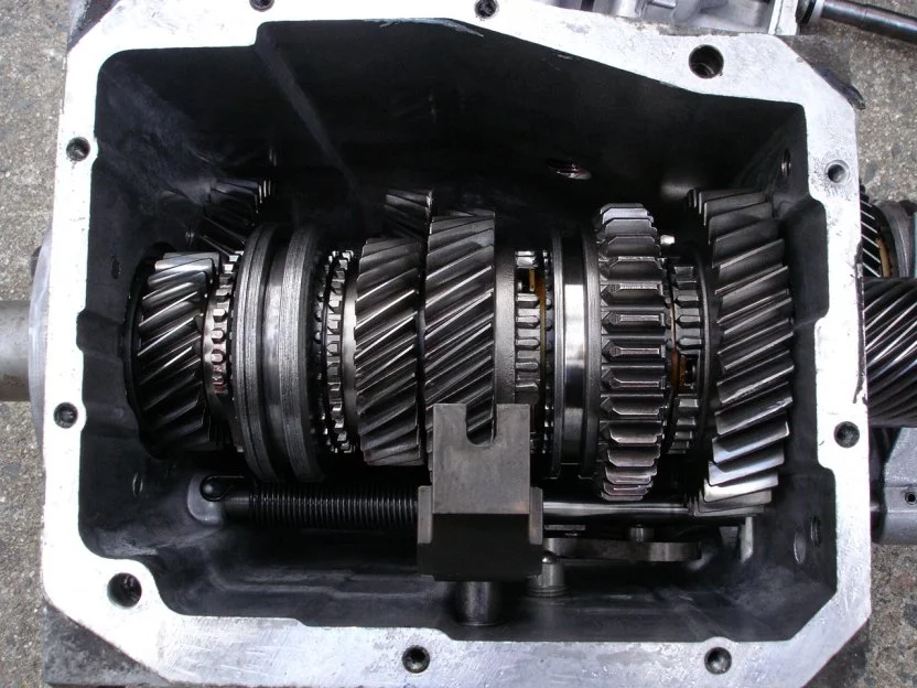

These are new gears when i rebuilt the T-5 in my car. Notice how sharp they are. The teeth on the gears need to be sharp, as well as on the blocker rings (the dark black rings in the pic) and the engagement points inside the sliders. Also, the straight cut teeth on the 1-2 slider should not be rounded over or engaging reverse may grind all the time.

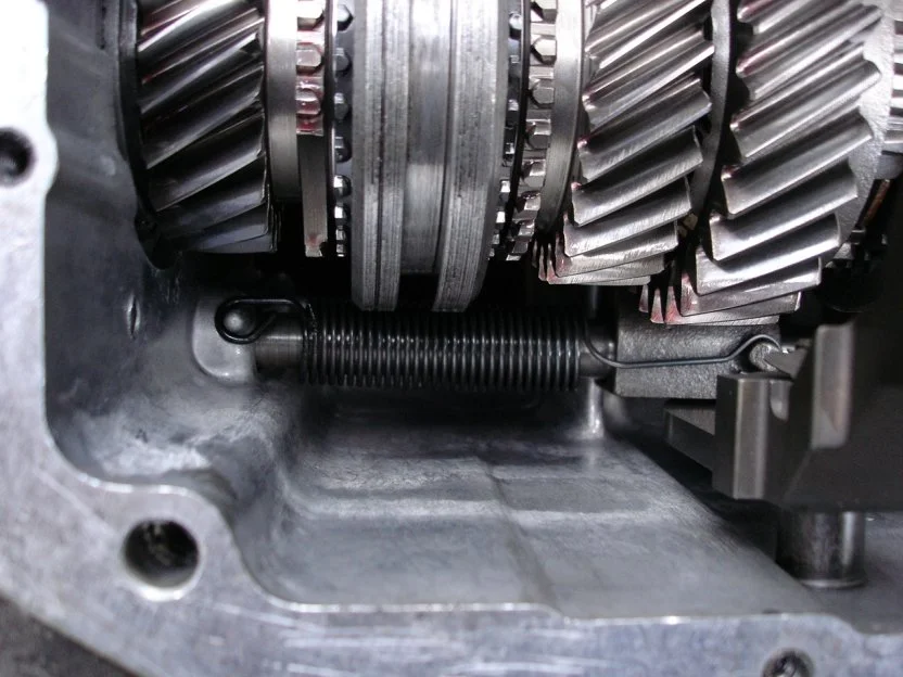

A closer look at brand new 3rd gear and the 3-4 slider and input shaft

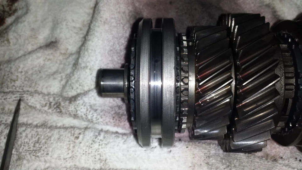

Also, you'll want to look at the tip of the mainshaft where the 15 roller bearings from the input shaft sits. This needs to be free of galling, or your transmission will whine like my ex girlfriend.

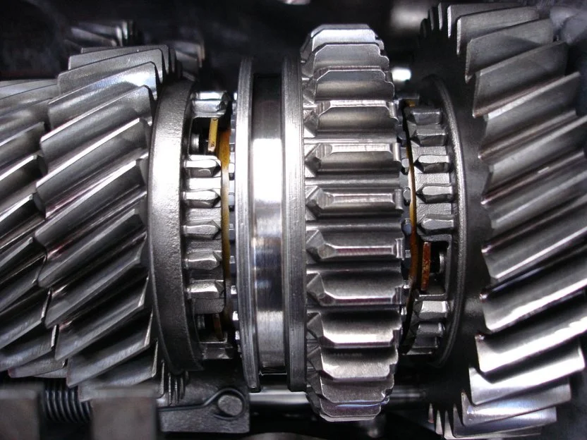

Overview pic. All brand new gears.
Did you buy the kit with synchros? Once you get it apart, you can inspect the lining on the blocker rings. They're not cheap, but I just rebuilt my first t5 and I replaced all of them. I figure they cost around $160, but may as well replace them while it's apart. I have 2 more t5's waiting for a rebuild. Those will get new ones, as well.

I have the main cluster all taken apart right now. I know that some of the bearings in the kit are for the counter shaft. I don't have a press so I don't think I'll be taking that out. I can pay pics of anything you guys want me to if you wanna see it and gives your opinion

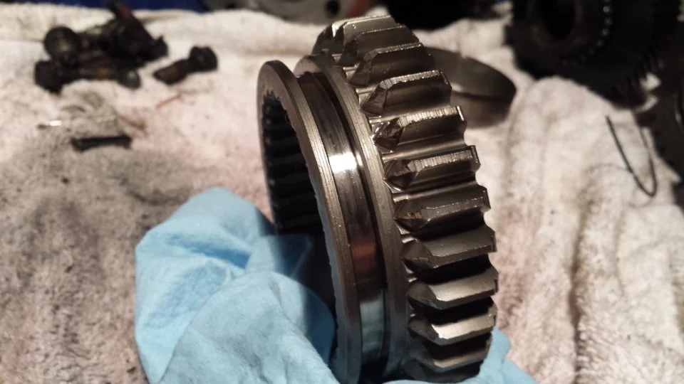

This isn't chewed-up, it's ruined, and I wouldn't want anyone to take away from this thread that if the slider isn't as bad as this one, it's good to re-use. I'd like closer pictures of the OP's slider, but it looks like his teeth have seen way better days, and for the $50 or so it costs to get a brand new one, there's no sense in re-using a worn one.
And for the record, here's a chewed-up 1-2 slider:
I seriously doubt anyone would think that, but yes... you are correct. This pic is an extreme example. However, the reverse teeth on the slider is probably going to show some wear on any used t5, since there is no synchro for it. Slight wear is normal, but doesn't hurt to replace it, since they are not too expensive.
