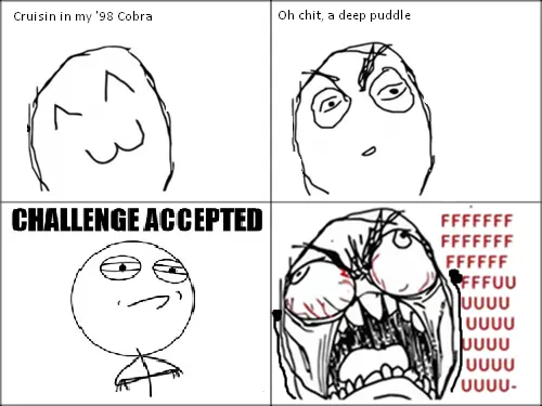

I have a calculator in Excel that will calculate the torque on the wheels at every speed from 20 to 160 using the dyno graph of that vehicle and the gear ratios of the transmission and rear end. I can also vary the shift points. Here's a graph of a BONE STOCK 02 GT with 3.27 rear gears (doesn't matter, just shifts the shape of the curve) and 5800 RPM shift points.
As you can see, the torque on the wheels is just falling off at that shift point. 5800 is the shift point that results in the largest area under the curve from 20 mph to 110 mph (I can calculate that, too). Any higher or lower results in less area under the curve. If you go above 5800, the dropoff at the end of each gear is noticeable.
I didn't feel like posting it up, but I also have graphs like this of a bolt-on GT and a full bolt-on/cammed 01 Bullitt. The optimal shift point on the GT is right at 6000, and the shift point for the cammed Bullitt is still only 6300 rpm.
To the OP, all of this means that if your friend is actually revving it to 7000 (or anything over 6000 rpm for that matter), then A) He is an idiot, and B)That's why it's so slow.
