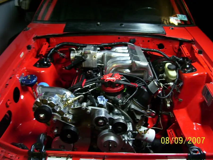

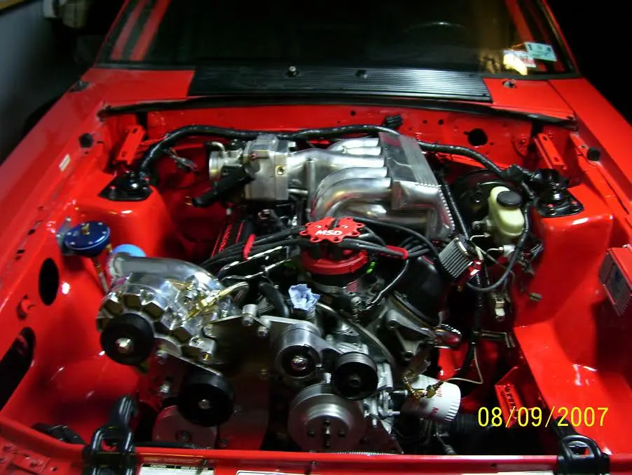

I hid all my wires and only had to cut and splice 2 sets of wires, 1 set to the A/C compressor and the other set to the overflow bottle and had I not welded up the engine bay I'm not sure if I would have to cut and extended those wires.
its really not to bad at all. Just Put the car on jack stands, remove the front tires and inner fenders and go to work. The passenger side is very simple and consist of only a few plugs. Just take your time and be patient.
Now welding up the engine bay is another story. ........
LOL.......I'm sure.....nice bay:nice:

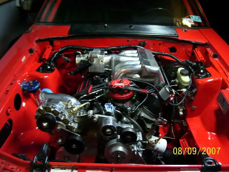

So do you hide the big harness at the back of the engine, or leave it out like Gun did?
Almost, I had forgotten about you page.....:bang: I can't see the bottom of the instructions though....it won't scroll down for some reason.
