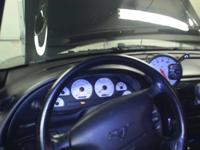

Turbo92PGT Member Feb 17, 2003 746 0 16 Auburn Washington Nov 4, 2005 #5 Nov 4, 2005 #5 not too bad. I bought a tach bracket from UPR when I installed mine. I just tied into the cd player for power and illumination, and ran a wire from the passenger kickpanel to the tach for the tach signal. and ofcourse ground. Attachments tach resize.webp 29.4 KB · Views: 163 Engine resize.webp 51.9 KB · Views: 207
