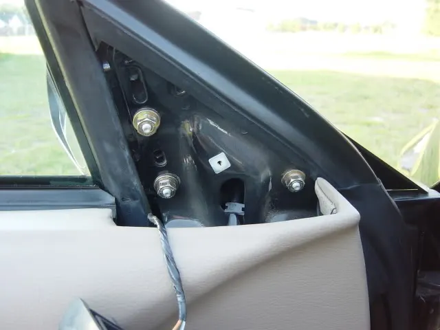

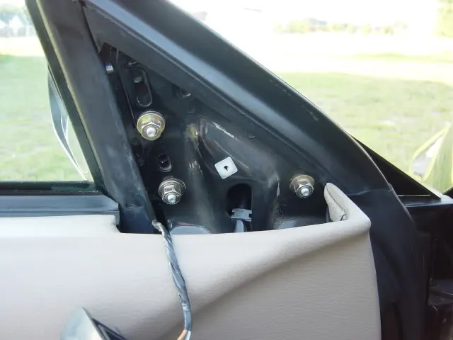

Yeah, that's about it. Take the cover off of the tweeter. It'll just pull off, but sometimes the glue that holds the cloth on gets stuck to the plastic that holds the cover on. May take a little tugging.
Then undo the screw that's in the hole and pull the tweeter housing out.
Then unhook the wiring harness (May or may not have to remove the door panel. I can't remember right off.) and remove the three bolts that hold the mirror to the door. The mirror should just pull off.
I think the cobra mirror goes back on the same way, but I'm not positive.
