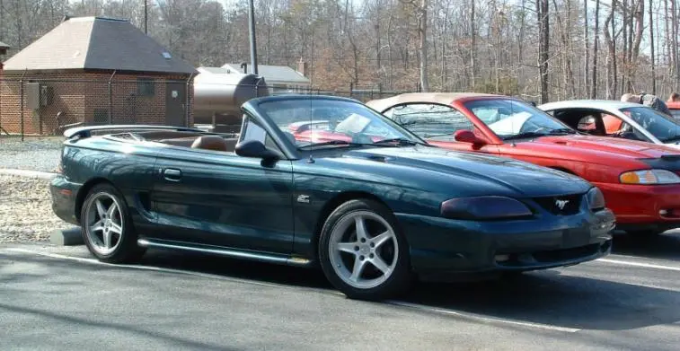

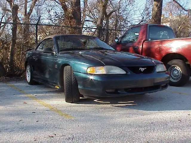

This is too low.
I have had the Steeda springs on my car for a long time, which drops the car about 1 and 1/4 inch. That was fine. After installing the tubular K-member it dropped about another 1/2", and it was intollerable. The front end rubbed on everything. Parking lots, speed bumps, getting into my own driveway. My longtubes looked like a beat hooker. I ended up putting spring spacers in to bring the front back up. I would say anything up to an inch and a half is fine. After that, you have to start worrying about everything.
