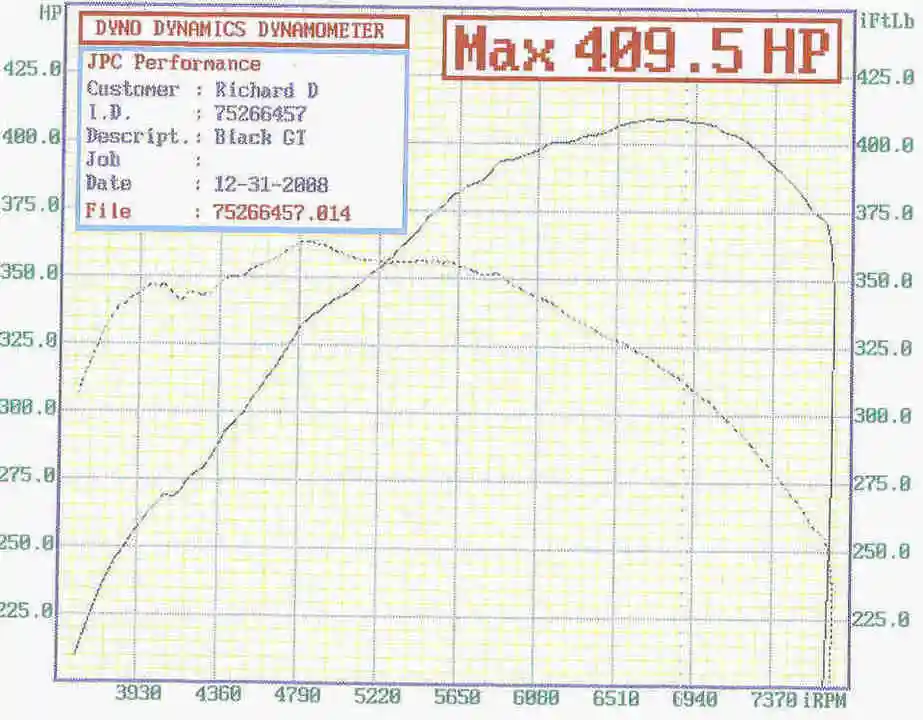

This is from a guy on another forum with
JPC intake
comp 127500 cams 535in 550 exhuast 229/236 @50 112lsa
livernios stage II heads
Kooks long tube headers x pipe
steeda cai with CF inlet
steeda UD's
steeda race delete plates
Stock drivershaft/flyweel/18inch rims/4.10s
He did have to rev it to 7k to get those numbers though, but still made over 360 ft-lb, which is very respectable. I think the intake is key to allow the engine to breath up to 7k, now imagine this setup with the stage III heads, a bored and stroked block (323ci) and 11/1 compression, that might make 500 RWHP.
