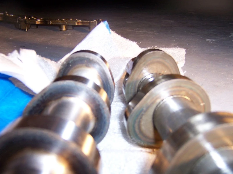

A bigger cam does not necessarily open the valve any more. My blower cams have roughly the same intake lift as the stock PI cams, and over .025 less exhaust lift. The big difference in aftermarket cams is the duration and lobe centerlines/LSA.
These are the cams from my car. Blower cam on left and stock PI cam on right.
Notice how the lobe height is very similar (which is because they're practically identical as per the specs), but see how much fatter the blower cam is? THAT is where the power comes from.
For reference, a stock PI cam has .507 intake lift and .534 exhaust lift. A Hitech Stage I cam and an MHS Stage I cam has .550/.500 while a Comp Stage I has .550/.550. So without knowing what cam you have, it's not possible for us to tell you if that sounds right or not. As shown by the Hitech and MHS specs, it's possible the valve lift IS actually less than stock.
Look, I'm not so dumb as to not know that a 1/16th is equal to .060. If you measure the cam lobe, and cant come up w/ a 32nd of an inch, there must not be much of a difference.:shrug:
Actually, it's .0625", but we'll let it slide. :D
Also, because of the rocker arm ratio, you won't see .500 or .550 or whatever on the cam lobe. It'll only be around half that (~.6 IIRC).

Well, after seeing the difference on the size of those cams, it seems we now have another issue to address: weight imbalance. That's gotta ba a difference of 15-20 lbs per cam... Mike I suggest adding/subtract weight in the car to balance it out....
So Then what you're saying now is the the aftermarket cam weighs more than the stocker? Why if there is so much of a weight imbalance haven't I felt it in the form of vibration then? The car runs smooth like glass. Not as smooth as see through glass, but kinda slightly bumpy like the stuff they use on your bathroom window. (You can still tell somebody is looking in trying to see you naked, you just don't know if it's the hot babe from next door, or the perv that lives down the street.)
