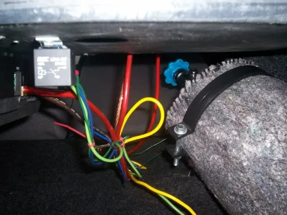

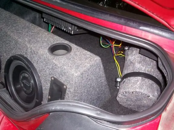

the nitrous line shoul be rated at 3000 psi....have you looked to see why the line burst could have rubbed the driveshaft or burned the teflon tube being too close to exhaust also the hole cut thru the trunk floor may have rubbed a hole in tube i put a rubber grommet into the hole on mine to prevent this any ways the line should not have burst the safety cap on the bottle should have gave first.... i leave my bottle in the car and leave the windows cracked and always try to park in the shade...have not had any problems so far i also have a thick bottle blanket on mine to help protect it from heat when not in use and to insulate bottle to keep heat from escaping while its in use....see pics below..
