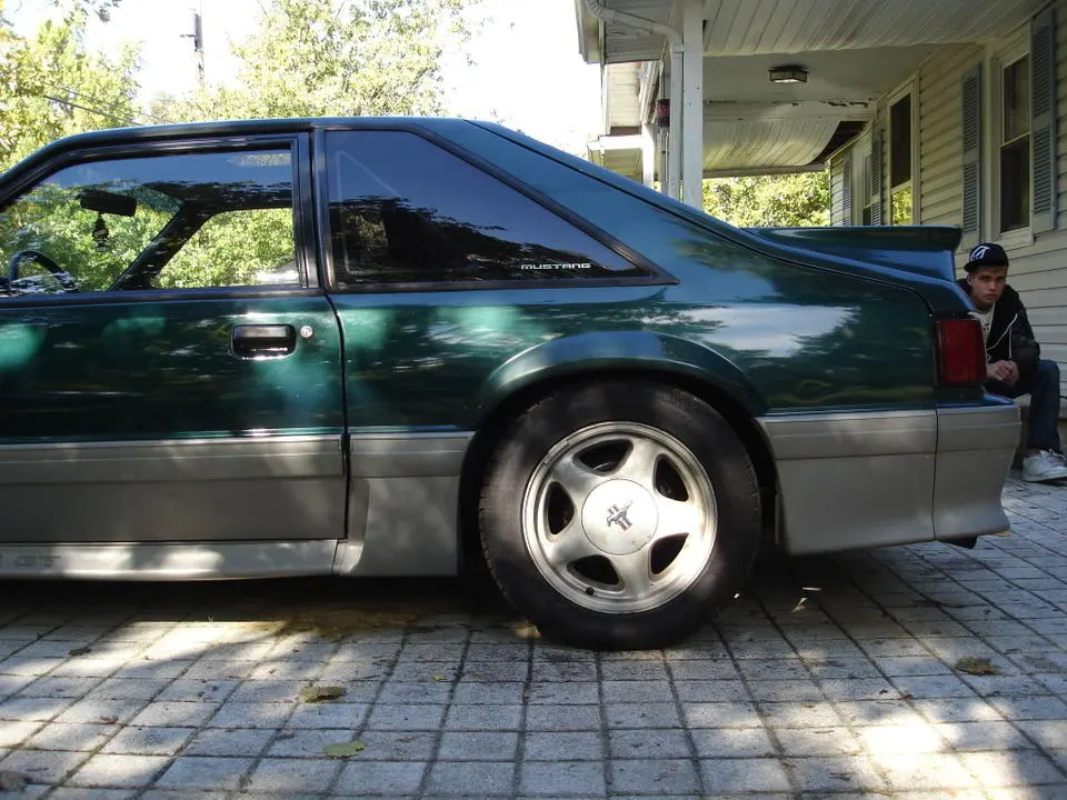

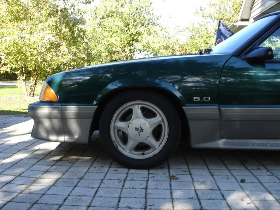

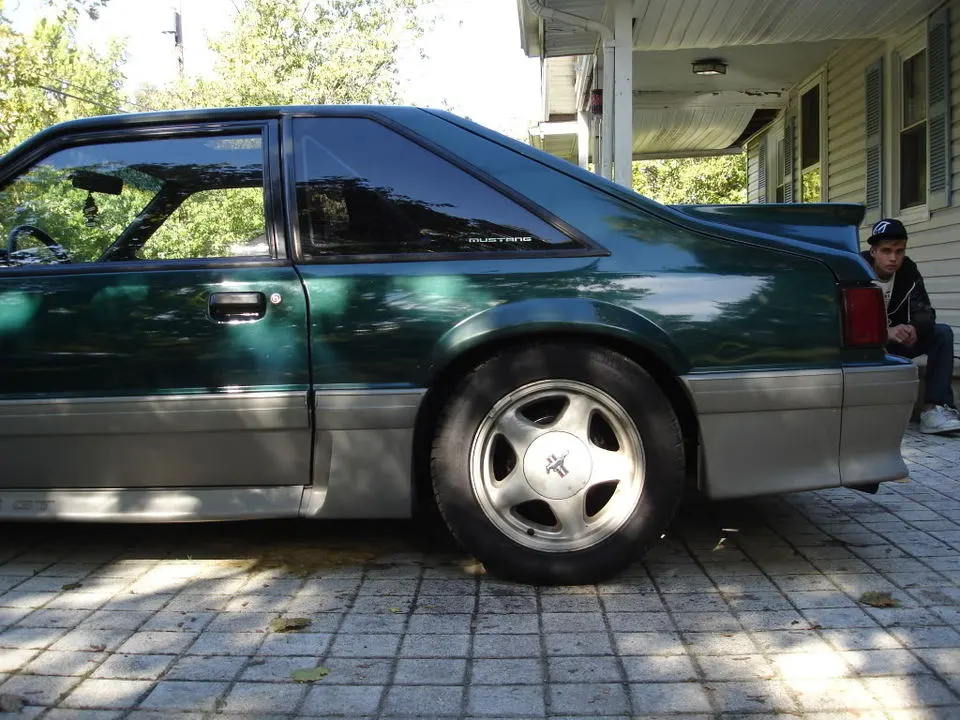

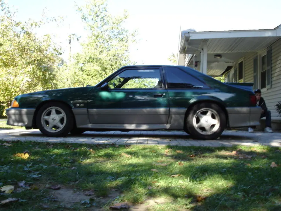

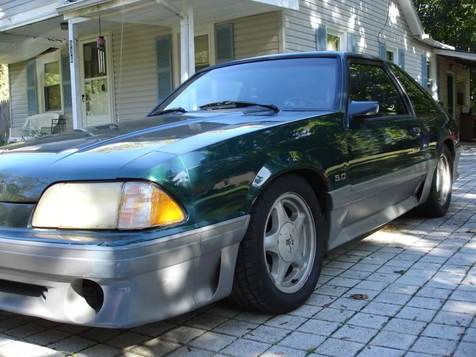

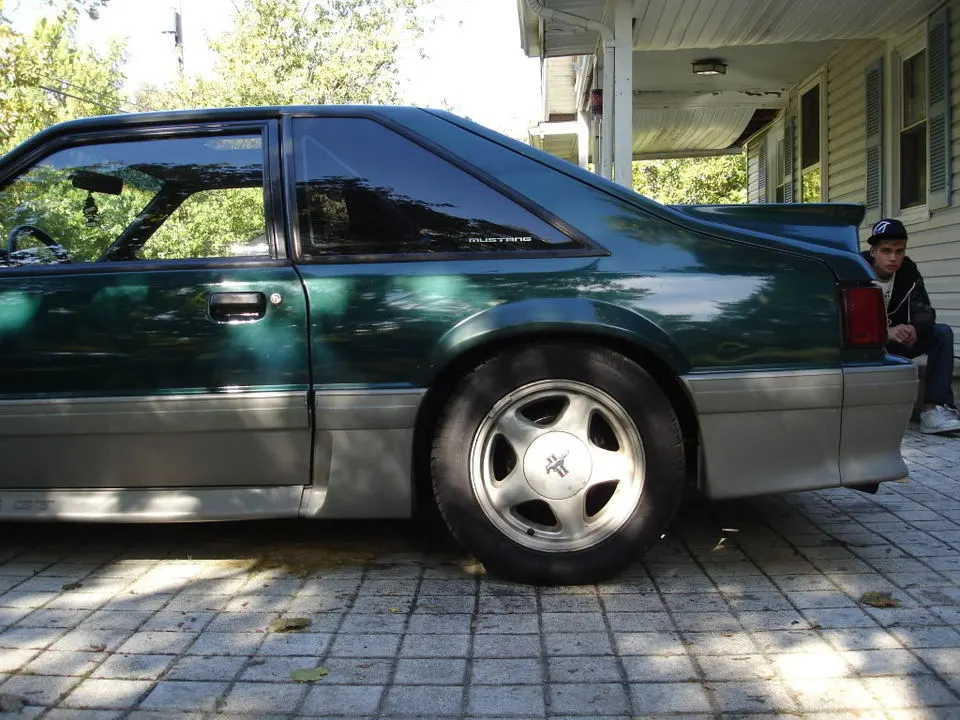

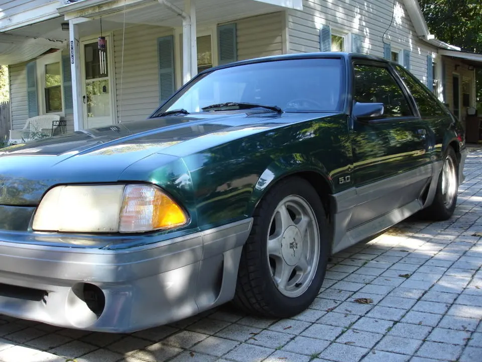

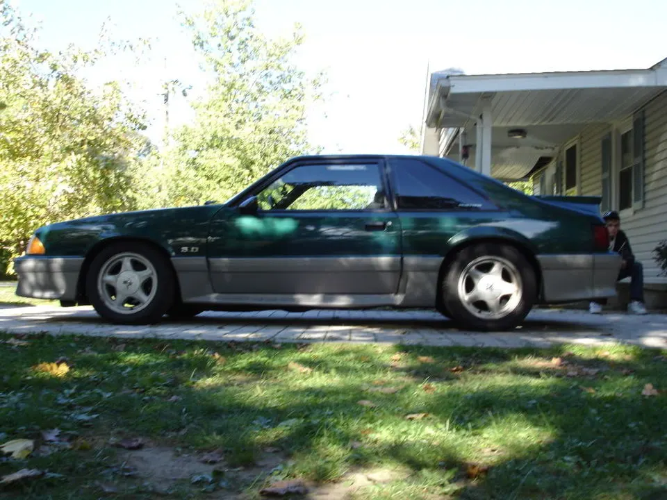

Took this pic 2 years ago after i put my frpp "c" springs inw/ all new iso's and one full coil cut off rears. How much d you recommend i cut off both front and rears. I still have a rake even with the rears cut. I would like the rake gone and have almost no gaps in the tops of the fender to top of wheels. Im guessin another full coil of the rears and 3/4 col off the fronts. Let me know what yo guys think. Yes the car is now tintned lol

The max recommended amount has already been cut off. The rears have a "dead coil" that does not affect spring rate..only ride height. Cutting additional coils off the rear or the front will change the rates and affect ride quality.
If you want a different look, change the springs.
ride quality how bro? I dont care if it gets stiffer. I dont mind at all. This car sees 200 miles a year at the most. Its a garage whore. I just want this thing to look low and nasty. Removing iso's is not an option, i dont want my metal to get deteriorated

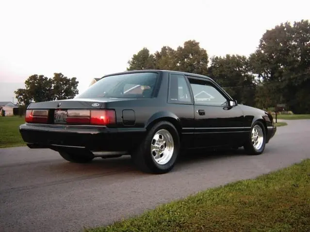

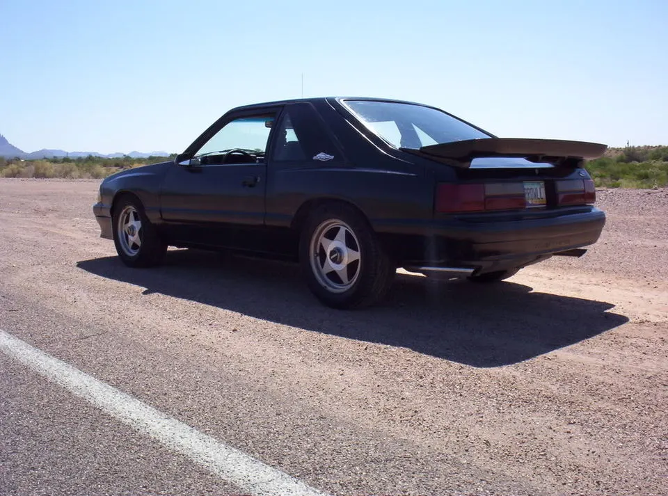

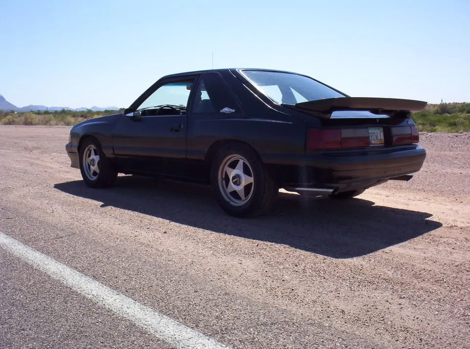

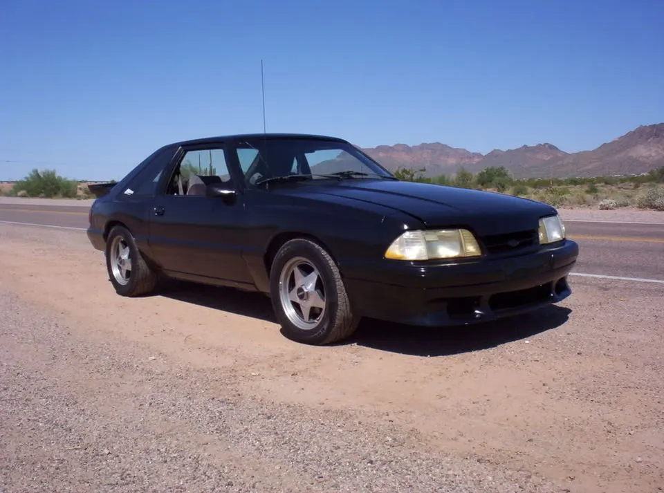

If you want that thing to look low and nasty then you are going to need some new wheels and tires, or at least something wider in the rear, maybe some drag radials. And rake IS nasty. notch5.webp notch7.webp Sorry, all I have is pictures of notches, the black one is my inspiration for my 89. How do you like the tko-600? I dont care for my viper spec so I was looking at those.

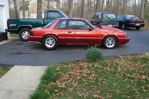

here's a pic of my gt.. it has eibach sportline springs..

What size are the rear tires on the black one?
