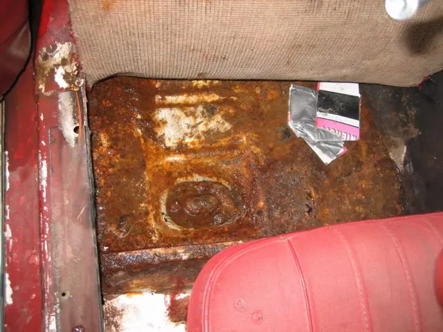

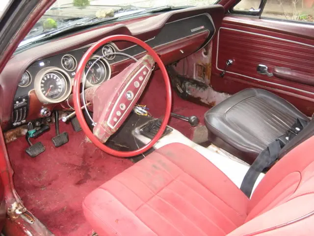

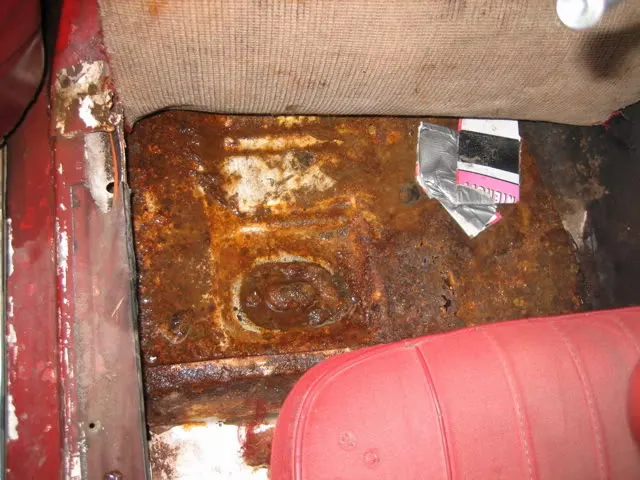

Front floor (the passenger side is worse, I forgot to snap one on that side)

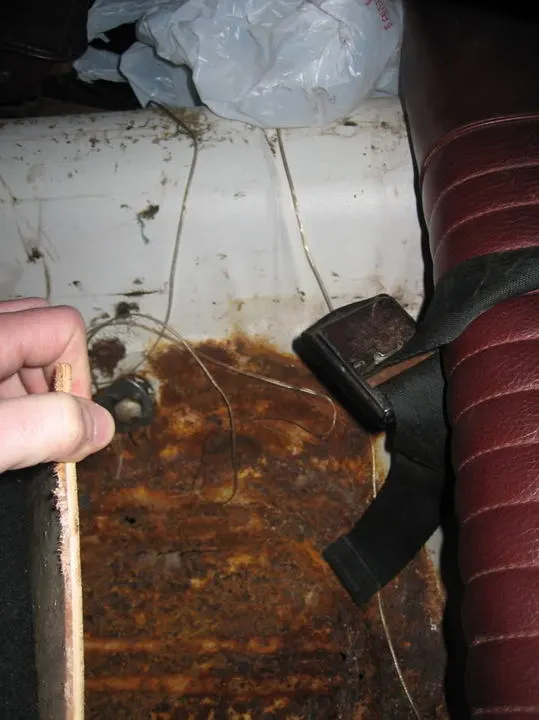

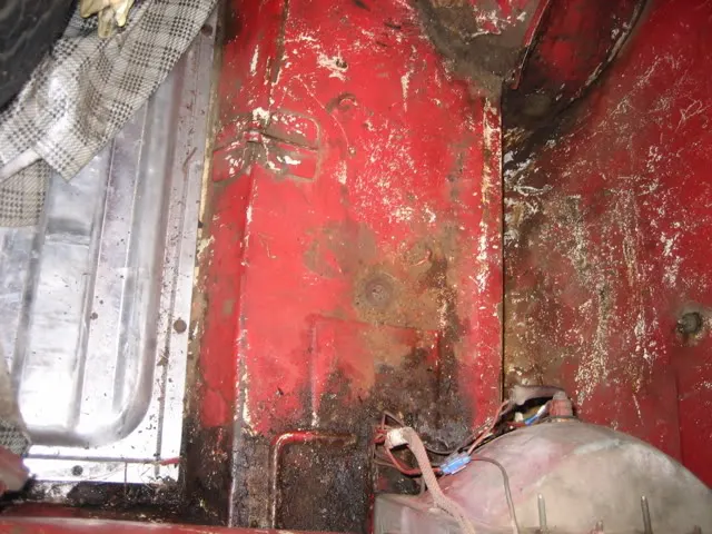

Rear floor

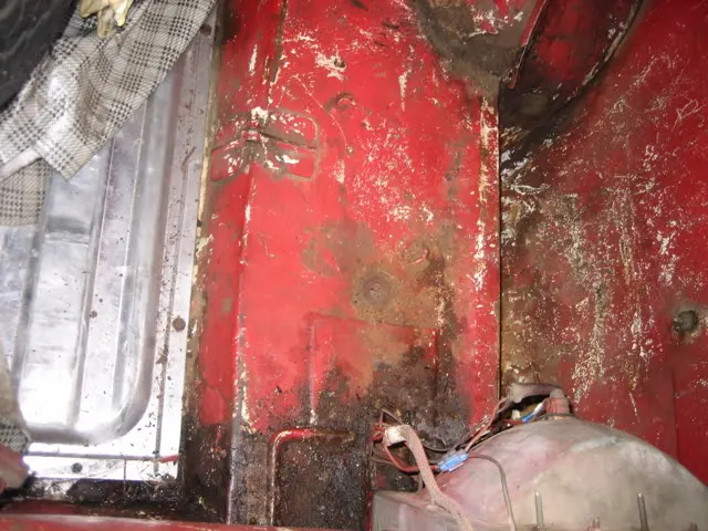

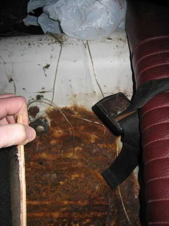

Trunk (hey new gas tank!)

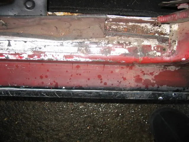

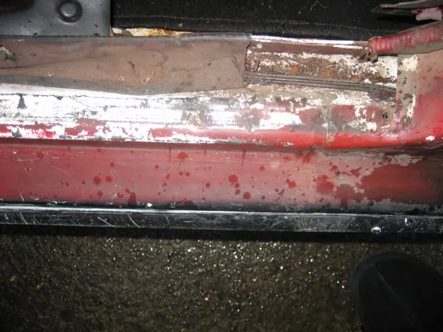

Doorwell

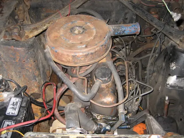

Underneath

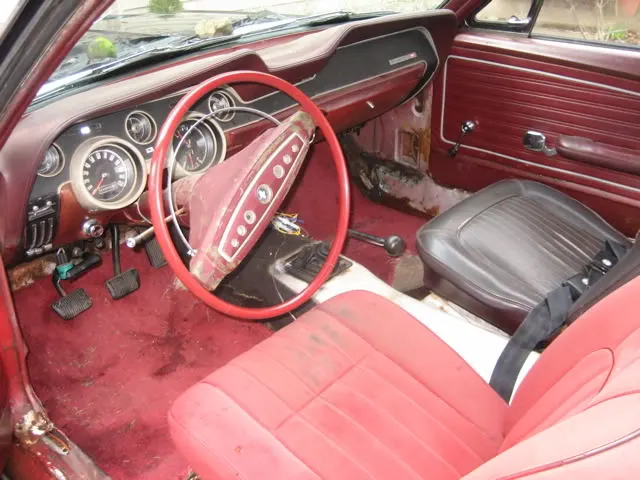

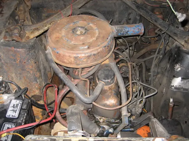

It appears you bought a six cylinder spaghetti strainer. The car has no pedigree and will cost you far more to repair than it will be worth.
If you want to use it as a learning tool and want to do all the work yourself over a period of years, it's just as good as any. If I were to start with a car in that condition, I would make damn well sure to get something I really wanted when it was finished. Not sure if a garden variety 6 cylinder coupe is that car for you.

I would say, like everyone else, it depends on what your plans are for the car. I'm in the process of restoring my first Mustang as well, a 67 fastback. Even though it was an AZ car, it still needed floorboards. I had the patch work done by a restoration shop, and the whole process was, and continues to be, a learning experience. My approach has been to start my build with a solid foundation. This meant stripping the car down completely before I sent it to the shop, having it media blasted, then have any rust areas fixed. This way I know that as long as I take good care of the car once it's done, I won't have to worry about rust coming back. It's hard to tell from your pictures exactly, but I would say that you definitely need two full length floor boards, and I would guess the toe boards (the area under the pedals) as well. Your picture of the trunk looks like the quarter needs to be patched too. How's the shock tower on the passenger side next to the engine? It looks like it has some rust holes in it from the picture, and that's the wrong place to have a weak area. Since Mustangs are unibody cars and don't have frames, the whole body needs to be strong for the car to be really safe. I really don't want to discourage you, and everyone is happy that you got the car you've been after. We just want you to know the big picture ahead of time. So let us know what your goal is with this, and we can help give you and idea of what it'll take to get there. This way you can make an informed decision as to whether or not you want to keep your coupe. With as many coupes as there are available, it shouldn't be too hard to find a good one for a decent price on eBay or elsewhere.
