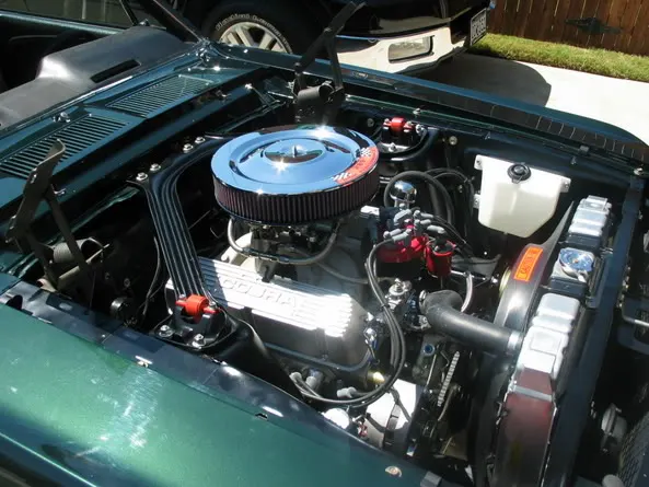

I run a 2.5" K&N inside a repro hi-po lid and base. The intake is a vic jr with a 1" spacer and a demon carb. Don't know yet if it will clear my 67 Shelby style hood as its out being painted. If not then I can reduce the spacer and/or change to a drop base.
I am running a 3 inch filter with a 1.25" drop base (K&N) ontop an RPM Air Gap intake with a holley carb with an electric choke. The choke fits without a problem. I have a very small amount of clearance between the hood and the top of the filter, perhaps less than 1/4 inch or less.
