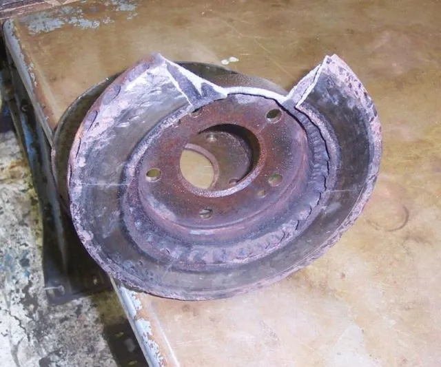

I should show you more pics of my Big Brake Swap I did on my 90 TSi AWD... It literally took me all day to do the fronts cause I had to break apart the rotors to get them off.

I have had 4x4 f-150 and expedition rotors that I had to hammer so hard that I broke the braking surface clean off the hub hat.. It takes me about 3-5 swings on a good day..
Everytime I mention this I have at least one guy say.. " DUDE mine just came right off in my hand" Yeah thats because you don't live in the northeast rust belt or you don't have a 4x4 model.
