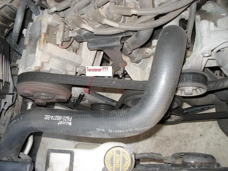

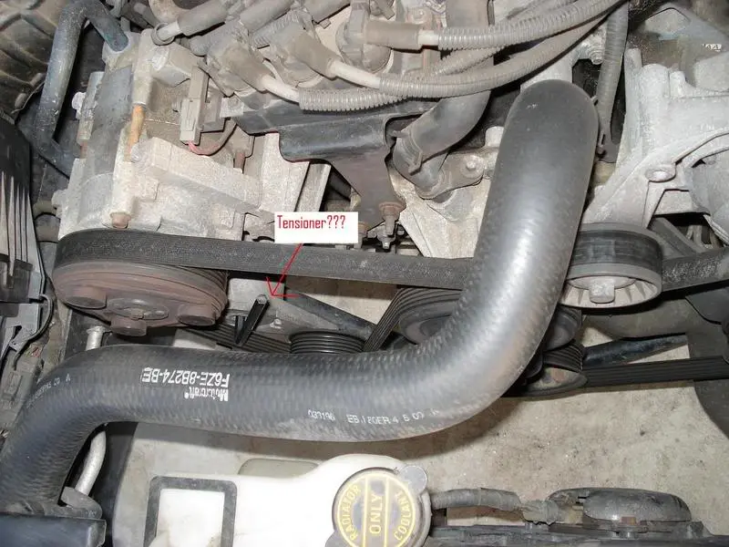

Ok I started to change it out and I can't seem to get the belt loose... I am trying to find an allen key to go in this. I think this is the right size but damn this thing wont turn. Am I being 'tarded or something??? This is a pic of what I think is the Tensioner with the allen key sticking out of it...

There is a 3/8" square hole on that lever towards the pulley that takes a standard socket. The spring is very strong though, so you'll need to use a two or three foot cheater bar to get enough leverage to move it. Lever it counterclockwise and pull the belt off once it's loose. Just don't get your fingers trapped under the belt!
The square in my tensior pulley chipped apart and I ended up having to use a socket on the bolt on the pulley -- which was easier. I was able to do it with a standard length 1/2" socket.

Ok so the allen key is in the right area I should be putting in a 3/8's socket right? I am gonna look at the pulley again this morning hopefully it will come right off...
stop... the allen bolt holds the tensioner to the block do not turn that one!!
you need a socket to go over the bolt that holds the pulley on.
lift up (you want the the rachet in reverse and the end of the ratchet facing the drivers side for leverage... this is not hard...

third... release the belt tensioner like i told you in the previous post..not by the allen bolt.
