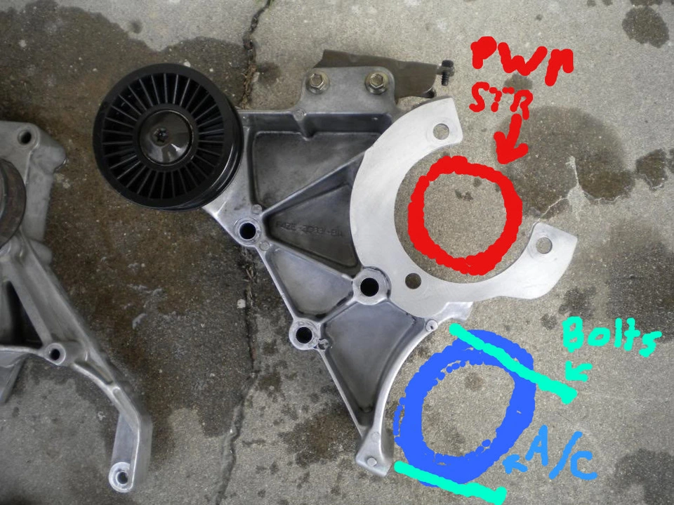

heres a pic of the bracket,out of the car.
Fresno doesn't get too bad, does it? It's supposed to be 112 here today, I need to get my a/c fixed! A little off subject...but how hard is it to polish the a/c and and alternator brackets?
it can get to around 115*.
as for polishing,i dont have the patience for it.
that may be a question better answered by The_Mustang.

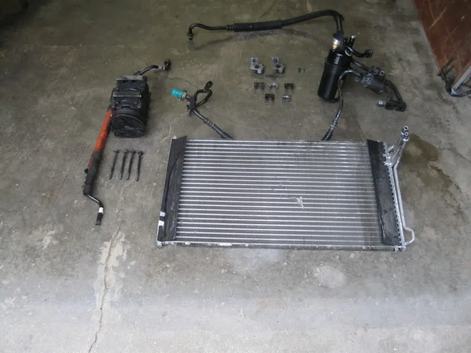

Had to say Thanks to Travis (Venom351R) didnt see a place for trader feedback, but for pulling out his a/c and selling it to me, fast ship all went well, and a/c system said to weigh 38# with big box guess Ups scale, gonna be good since been 100# for the last week, :(

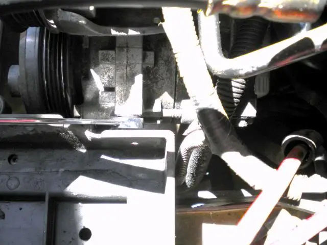

11.Remove The A/C Compressor.
-i thought i could work around the Battery,but there was little room.
with 1/2 inch wrench,remove Battery.
-on the side of the Compressor,with your 1/2 wrench remove Four long bolts.
Two on top,Two on bottom
Great write up Harvey. I just removed my AC compressor (front seal leaking freon) with lines a few days ago and your pics helped tremendously. I'd just add one tip. When you remove the battery, it's better to remove the plastic battery tray as well (just two 5/16" bolts) so you'll have a lot more room to get to the two front compressor mounting bolts. The compressor (with the four mounting bolts) weighs 15lb.
Not a problem. Glad it could go somewhere so it will be used and not sit in a corner in a box in the garage
