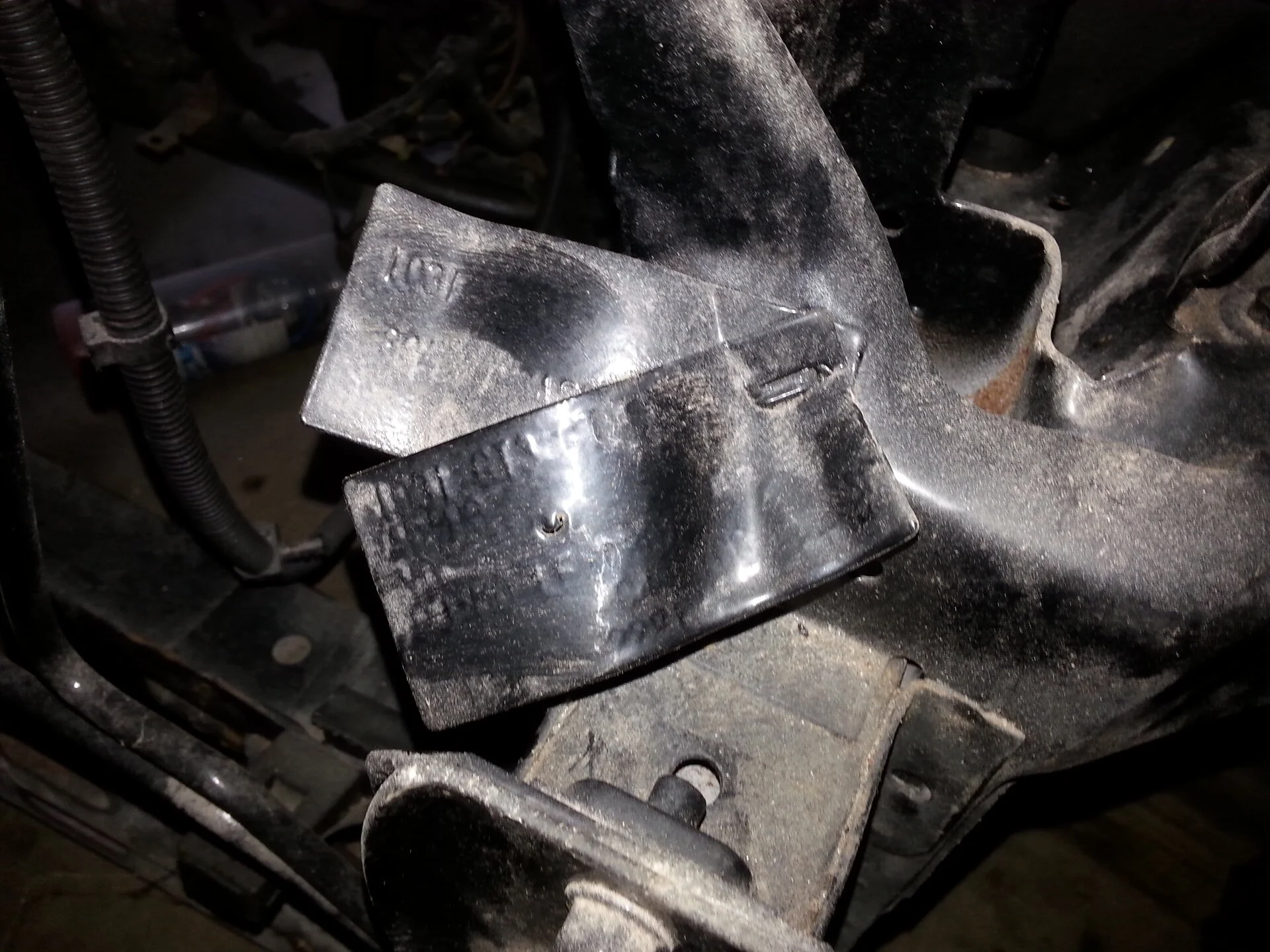

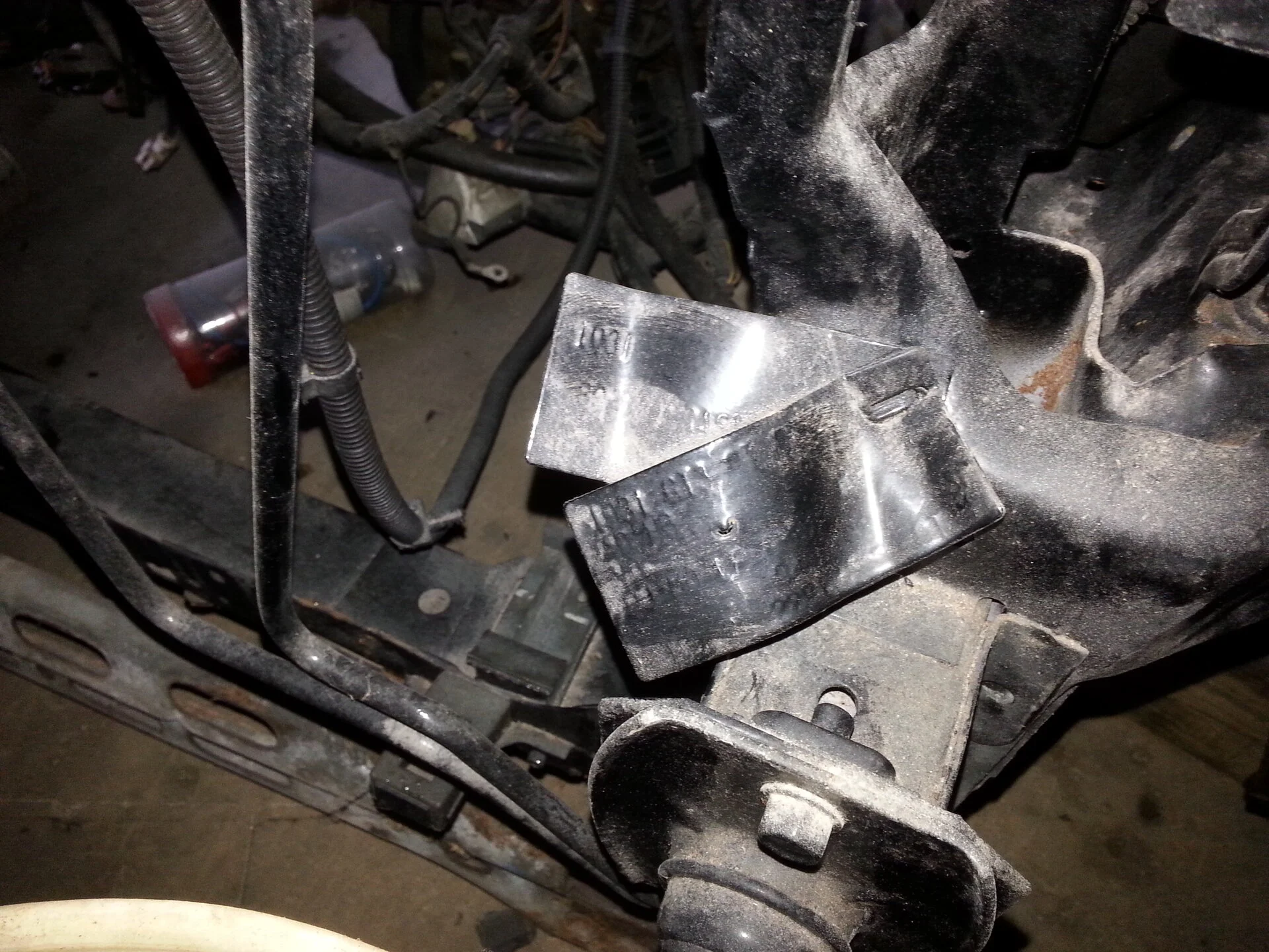

I'll have to search for a buck tag. I have the engine out and the front bumper off, and I haven't seen one. When I get the car back, I'll look for it.
Mine was located on the driver side of the rad support, bumper side of the support. So removal of bumper cover was required to read it.

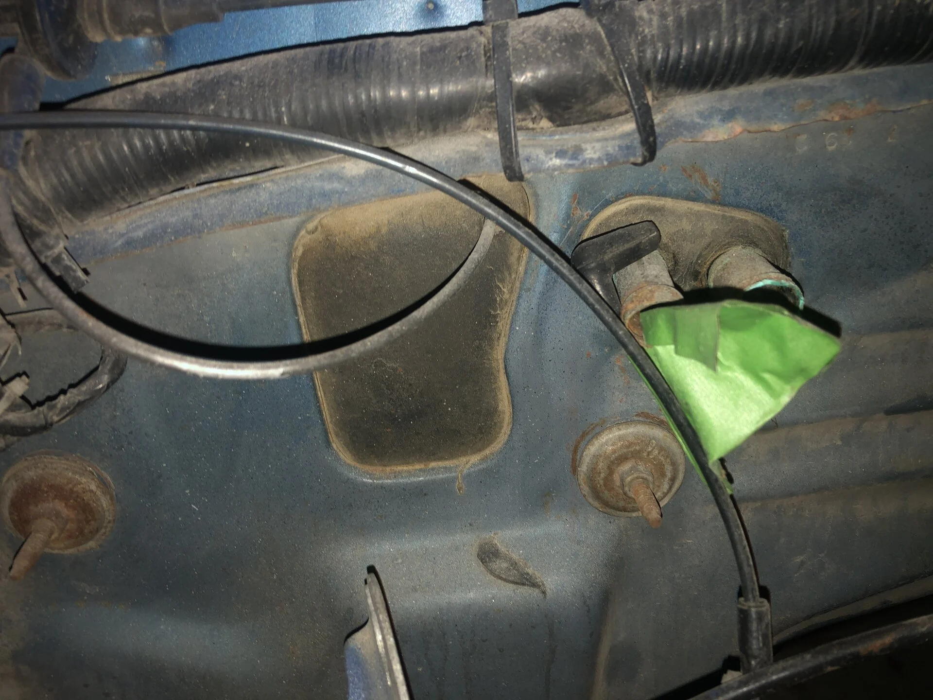

Got the car back a few weeks ago and finally made it out to the garage today. Here's a photo of the rubber cover that's over the hole in the firewall.
Reactions: Gs1987GT
It is possible that someone deleted A/C and swapped the heater box behind the dash to a non-A/C unit, but that is alot of work when if the goal was simply to take out the A/C.
I would bet you have a factory non-A/C car.
