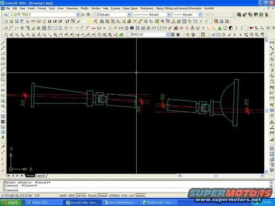

I got the angles matched up between output shaft and yoke - the centerlines of them are parallel... the output shaft is ~ 2* down, and yoke ~ 2* up.
If the rearend was in its stock location, the angle between output shaft and driveshaft would be ~1.3*
However, I have 1" lowering blocks installed, and that brings that angle to ~ .2*
That's below the ideal, since I guess .5* is ideal for proper lubrication - but I guess if it cuts the u-joint life in half, I can live with that.
Attached is a drawing I whipped up to show where the angles are.. Anything look off, or does it show that I finally am graping these (easy) concepts? Unless there's any crazy problem, I should be getting the leaf spring mounts welded to the tubes tomorrow.

Looks like the pinion points directly at the tranny output, is this right? Usually you have to go up the opposite of the tranny down angle, but if you draw a line straight out from each, they are parallel to each other but not in the same plane. So the angles of the yokes for each are the same, but opposite, but the driveshaft itself is at a different angle, like 2 or 3 degrees.
both angles are at 92*, both in the the _/ direction, its hard to tell in the picture I suppose cuz it is only about 2*
I did double check, and the centerline for yoke and output shaft are parallel...
for the trans, on the left side there (like your drawing), I have the output shaft at 2* downward - the dimension for the output shaft is missing.. I extended the centerlines of the output shaft and yoke, and they are parallel.
The angle from the output shaft to the driveshaft is what is at ~ .2*
The 2.2* angle you see, is the angle of the driveshaft in relation to the ground - which I suppose really has no relationship to anything <g> other than to add and subtract it from stuff. Anyways, your diagram in autocad is the same that I have in solidworks, except my angles are different, but at least pointing in the right direction..
Well, I'm showing the driveshaft at 3* down from the tranny's 2* down angle, the rear is 2* up and the driveshaft is 3* up from that. If what your showing is similar to what I have shown, I think you'd be okay. Optimal for what you intend to do with the car? I don't know, but for normal driving on the street I think it's correct.

The the drawing that I have, uses a centerline parallel between the pinion and the trans.
All the same concept were just finding the angle different.
The easiest way for me to explain it is....... if the driveshaft angles down from the trans at 2* and then turns back up 2* at the pinion you're good to go.:nice:
