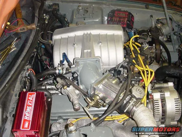

get the mallory VI-al. also get a coil.
my car was having spark blowout at 10psi before.
It also has a revlimiter so you wont go lean when you hit the stock rev.
These coils actually send a higher voltage to the primary side of the coil which results in a higher output
