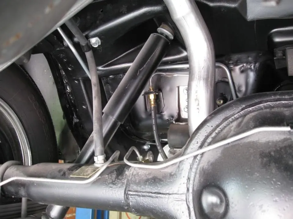

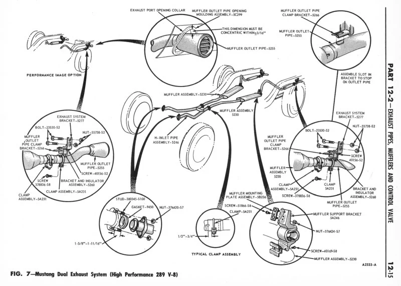

The car originally came with a single exhaust and I've picked up a dual exhaust that I'm now installing. The kit I bought came with only 2 universal hangers. Is that it? I'm thinking now that I probably need 4 hangers.
The mufflers do not have any location to attach the hanger. So I'm figuring that, with what I have now, I would attach the hanger on the clamp at the rear of the muffler. Would I then attach the hanger to the floorpan? Drill a hole through the floor and use a nut and bolt to attach the hanger? I know the tailpipe gets attached on the rear framerail near the spring shackle.
Any recommendations? How has everyone else handled going from a single to a dual exhaust?
