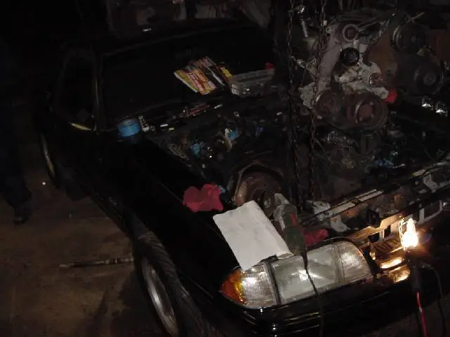

Here's a good start!!! :D
(Get a Windsor and swap to a 5spd!!! - CAKE!!!)
