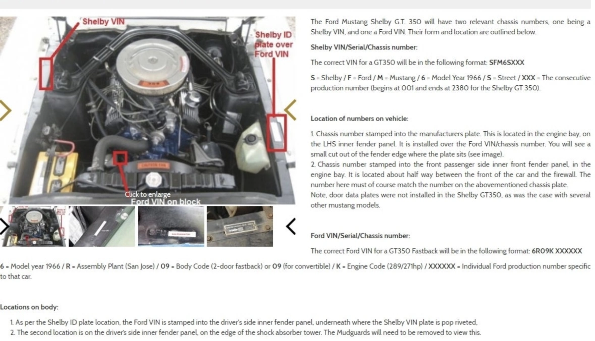

Realmongo I prefer to be called "Evil Genius" Founding Member Oct 10, 2001 2,466 86 99 Western Mass Jan 29, 2025 #4 Jan 29, 2025 #4 To start with, does it have a Shelby VIN plate riveted on over a factory K-code stamp?
AeroCoupe lube between the nut and the face. I know my lubes Founding Member Oct 28, 2001 6,257 4,341 183 Claremore, OK Feb 1, 2025 #5 Feb 1, 2025 #5 Maybe this will help? Reactions: Realmongo
