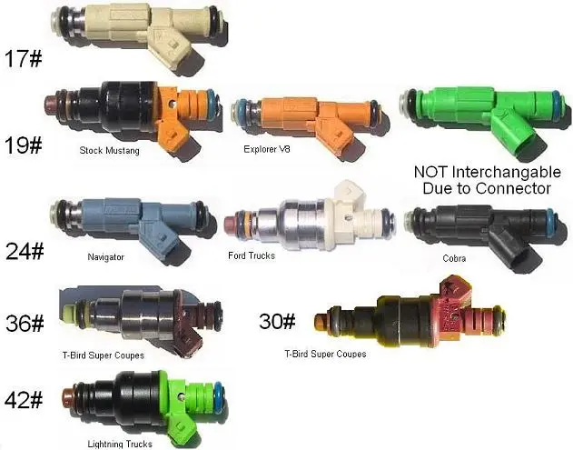

nick6690 Member Mar 2, 2008 147 1 17 McDonough, GA Nov 5, 2008 #1 Nov 5, 2008 #1 Is there any way to tell what kind of injectors you have?
9 92GreenGT PEAT Founding Member Jul 18, 2002 2,085 1 46 Big Stone Gap, VA Nov 5, 2008 #2 Nov 5, 2008 #2 The color of the tops of the injectors for the normal injectors you'll find around a mustang.
G GTOreturns Well-Known Member Oct 1, 2003 51 17 59 West Coast Best Coast Nov 5, 2008 #3 Nov 5, 2008 #3 There color coded. What color are yours?

K kevin2m4 New Member Mar 16, 2004 50 0 0 Barrie Ontario Canada Nov 5, 2008 #5 Nov 5, 2008 #5 Attachments Ford_Injector_Guide.webp 28.1 KB · Views: 121

nick6690 Member Mar 2, 2008 147 1 17 McDonough, GA Nov 6, 2008 #8 Nov 6, 2008 #8 they are black and the tops of them are blue
G GTOreturns Well-Known Member Oct 1, 2003 51 17 59 West Coast Best Coast Nov 6, 2008 #9 Nov 6, 2008 #9 nick6690 said: they are black and the tops of them are blue Click to expand... Sounds like #24's that the Cobra use;.
xporter Member Apr 9, 2002 34 2 6 Florida Nov 7, 2008 #10 Nov 7, 2008 #10 I've got a set of the blue that say navigator under them. Will those work in a foxbody? Any difference between those versus say a 24lb from like FRPP?
