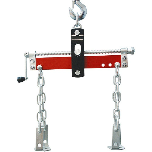

As the post implies I've got an engine, M6007X302 to be exact, going into my 87 gt. Now, I've done a couple swaps (one 350 chevy s10 and one 2.8-4.3 s10 and hepled with my dad's 460 into a 82 f250). However, none of them had aluminum heads. With the sling I bought from summit I lifted my stock 302(by the stock irons), bell housing, and tranny with no second thoughts...I'm having second thoughts on putting the new engine in. This sling has 2 plates not hooks. Long story short, where should I bolt the plates to? Should I also plan on doing the tranny seperately? Thanks guys in advance.

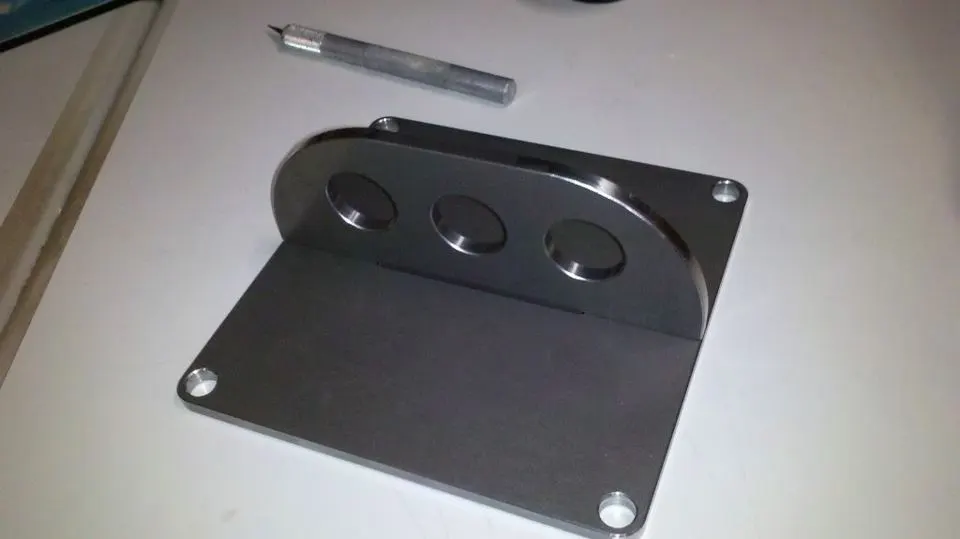

Do you not have an intake lift plate? If it has little tabs with bolt holes in it, I suppose you could put them in the accessory bolt holes in the front and rear of the heads-or am I not correctly visualizing something?
edit: I dropped mine in and pulled it out with Edelbrock aluminums using an intake lift plate...intake was aluminum too, and it had no problems heaving out the engine and transmission.

+1 for the intake plate. Very simple and easy. I was a little worried about it handling the weight being bolted to aluminum intake and heads, but even with a steel blowproof bellhousing and a TKO 500 hanging behind it, it held with no problems.

Thanks again everyone, The headers I have did have new bolts but I dont know man I just didnt want to do it to the new heads. I ended up ordering a manifold lift plate from jegs. $21.95 shipped to my door, should be here tomorrow...now once tmoss sends my manifold back I'll be in business.
Speaking of carbs...Jegs sent me the wrong manifold plate- it clearly said EFI on the page right under the order button :bang: . So the heck with it, just going to bolt my plates to the accessory bolts in front/back of the heads and be done. I dont have time to mess with sending back/waiting for correct plate. Oh and if anyone was curious tmoss did an awesome job on my lower, guess that was the one bright side of yesterday.
