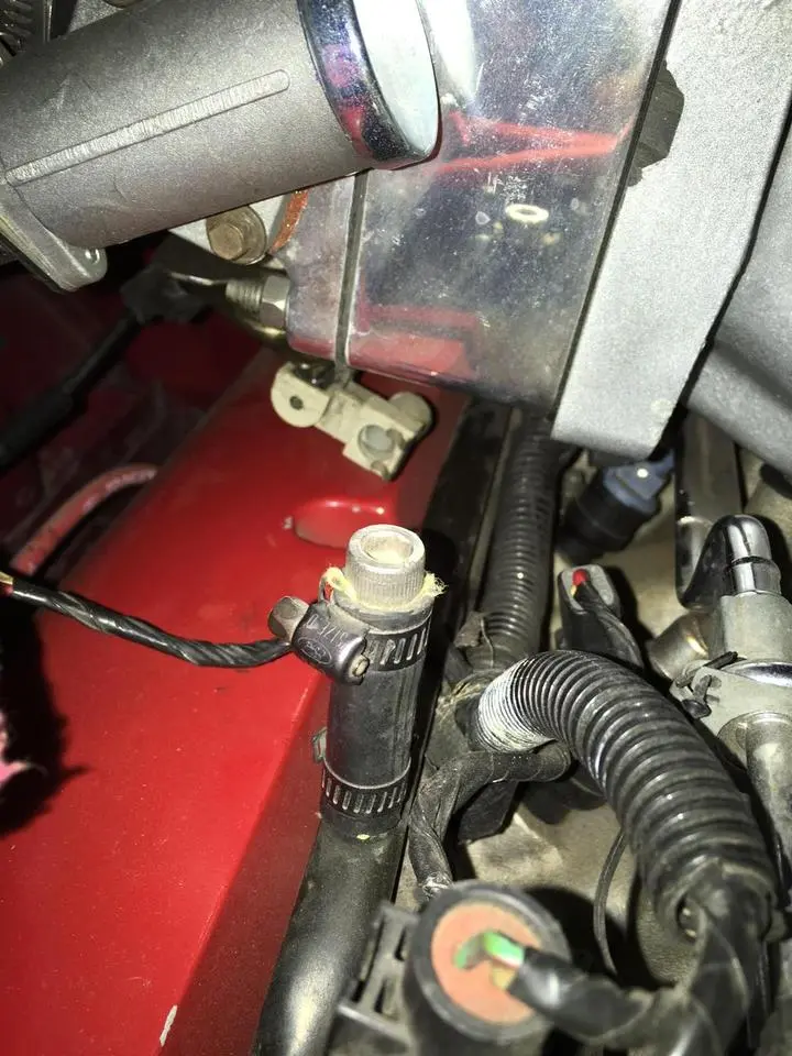

rubber hose with a bolt in it and a hose clamp around the hose works.
This is what I did. Works great
