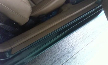

also open your door and look down... youll see a black strip connected to the sideskirt that says "mustang" it looks like its there for styling but there are actually clips built into that thing on the underside... pry that black thing off the car (more cheap clips) and your home free.
thanks, but I don't see anything black that says mustang. I have a 97. see the pic of what I see when looking down.
