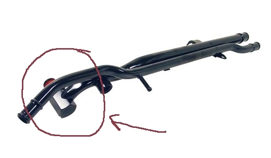

The top tube of the back end of this heater assembly is corroded, need to replace. How do you remove the front portion (~1 inch) that is screw into intake manifold? Do you take out the intake manifold to unscrew this tube assembly? -Thxs!
The tube is hiding the fact that there's a nut/fitting at the bottom of the 6-sided fitting, which screws into the intake. You don't have to remove the lower intake to get thing off, but you do need a big-ass wrench. I think it's 1-inch or 1-1/8.
